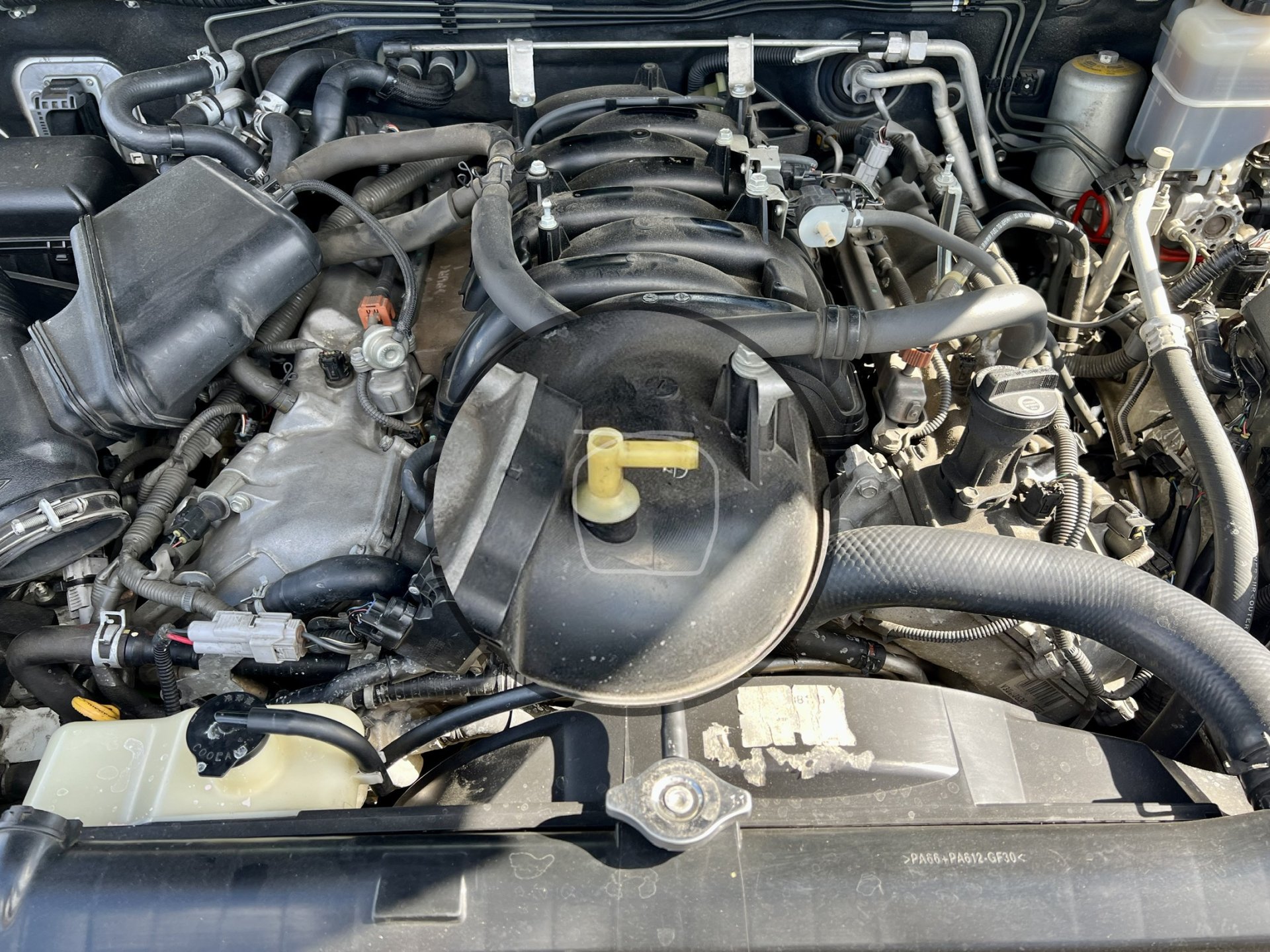

Little update: so after taking care of the loose air hose and 40 miles later I had stalled only once. Before I stalled at every traffic light. Fuel trims look fine, again, don't see any issues as techstream shows, unless I've missed something in reading data correctly. I took a snap shot of a screen when truck was running, if you guys see anything iffy in it please let me know! As for now I'll continue monitoring and if it'll keep stalling my next suspect would be PCV valve, then oxygen sensor, then EGR valve and then fuel ECU, kinda sucks to rule out issues one by one without DTC codes....

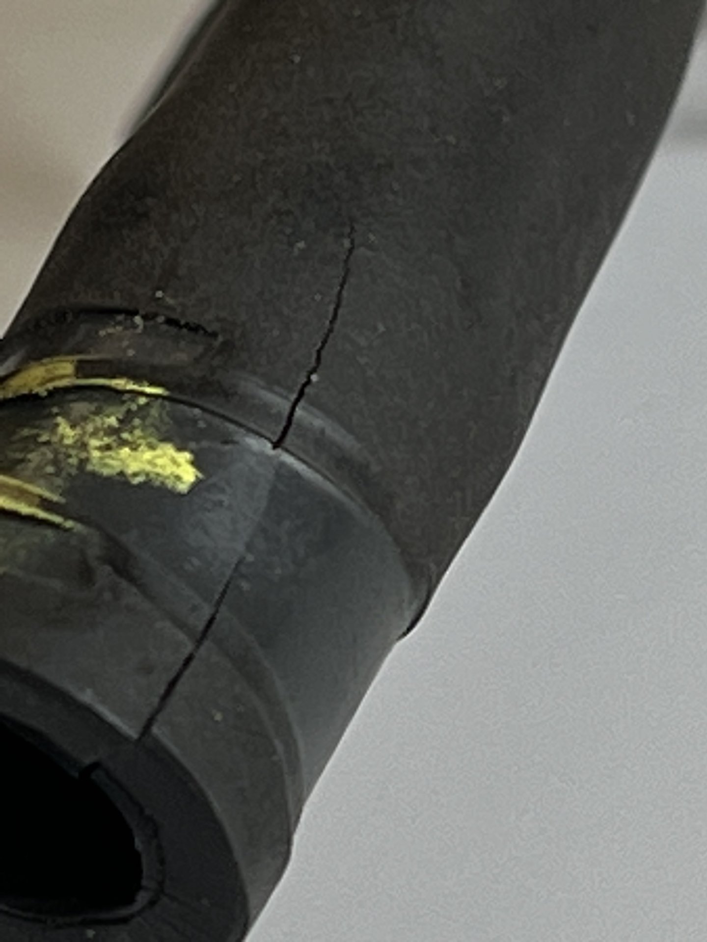

Okay, finally solved the issue...When stalled again, finally truck threw a code, yasss! At least that gave me idea and location of the problem. The code was P0113 (intake Air Temperature High Input), so when inspected hose and lines around throttle body, voila! Friggin' fuel vapor feed vacuum line had a crack in it! So quick and easy fix (OEM line at the dealership was $34), and stalling issue resolved. So folks, if you run into similar situation, inspect your vacuum lines!
