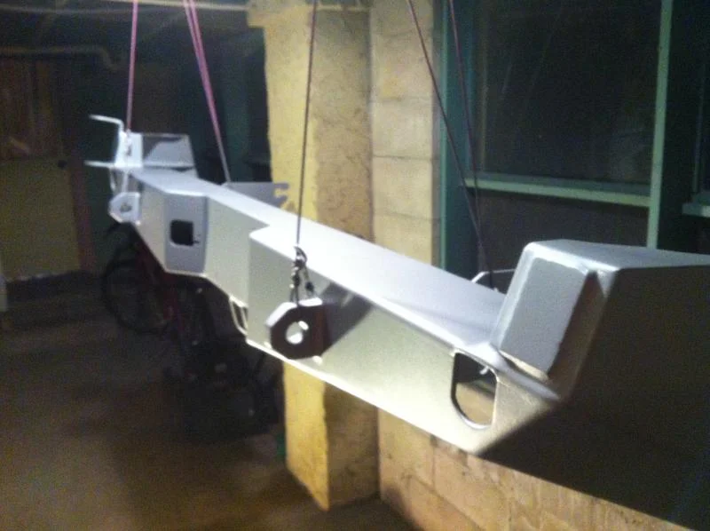

I ended up spraying RB with 1.8 tip at 29PSI at the gun. I also ended up thinning it 5 -10% with Xylene. It orange peeled because of the thicker viscosity and was dry to the touch in a few minutes.
I applied 3 thin coats. There was one spot on the inside of the bumper that bubbled because of being thick. Which is why rolling on or brushing on Rust Bullet never worked well for me.... it always bubbled. Spraying it in thin coats did not result in this.
