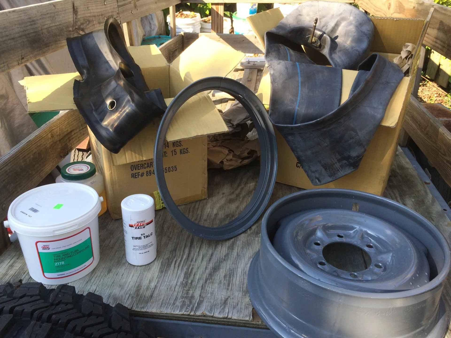

Is that a brand new Toyota lock ring wheel?
Good photo - shows the flap/liner, the proper type of tube and even tire talc.
After you install the tube into the tire do you put enough air in the tube to just get the wrinkles out of it before installing the flap/liner and installing the tire on the wheel?
Good point about the split in the ring & the valve opening... makes perfect sense. I don't recall aligning the ring that way when I mounted mine. I still need to get these balanced. I know Harbor Frieght sells a basic wheel balancer. I may DYI it with one of those.
Yeah... After putting some tire talc inside of the tire, I slightly inflated the tube and tucked it into place. Afterwards, tucked the liner in place, lubed up the tire bead and ring before giving it a go. It became easier with time. By the third round I was able to mount the tire without any tools. I doubt I will be using a bucket next time. It wasn't the most stable setup and I just about busted my butt when I lost my balance.
Finding a supplier for the tubes and liners took some time but I referenced them in my build for anyone interested.
The rims I have were used, but I had someone blast them and powder coated as close to the original color as possible. I was very easy with the tire iron as to not mess up the finish.
