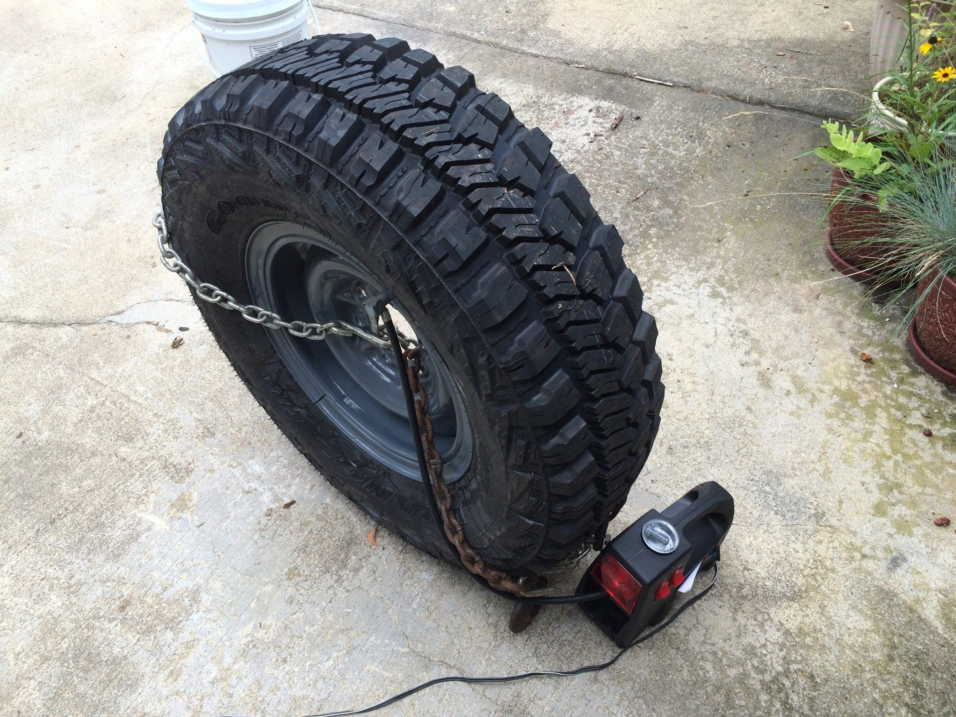

That's how the REMA tire lube looked in the tub it came in, a yellow-brown grease. If I knew about the Murphy's brand and they sold it in smaller quantities I would've gone that route. It doesn't take much to get the job done. As for inflating the tire to set the bead, I was definitely skittish when inflating the first tire. I used a cheap portable air compressor with a preset programmed so I can watch at a distance. I normally curse how slow the portable compressor airs things up but it was greatly appreciated in this situation.
Wise move to wrap it with a chain if you do not have a safety cage.

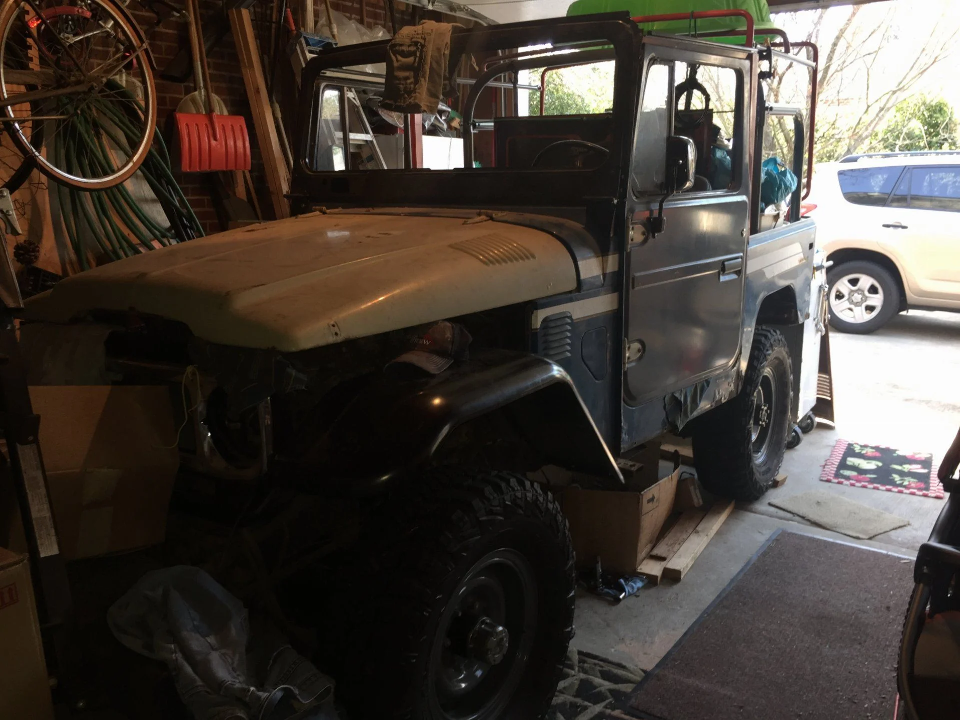

Here's a current picture of the truck with the 2-piece rims.

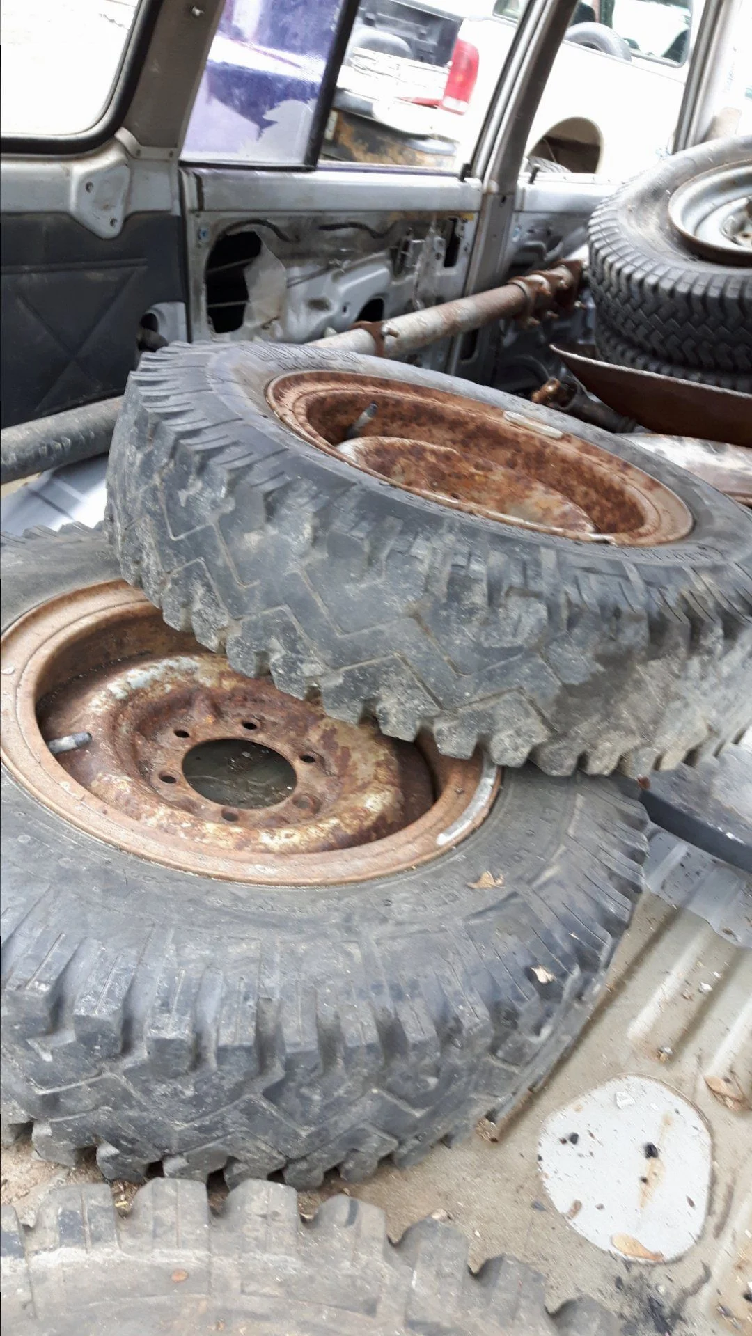

Just to add my 2 cents....on the one set I have, the tires were rusted on to the rims . I fought with them for a while with no success. The tires were garbage anyway so I was able to push the bead down far enough in one spot to get in with a cold chisel and hammer and cut the bead. Was easier than I thought it would be and then the tires came right off.

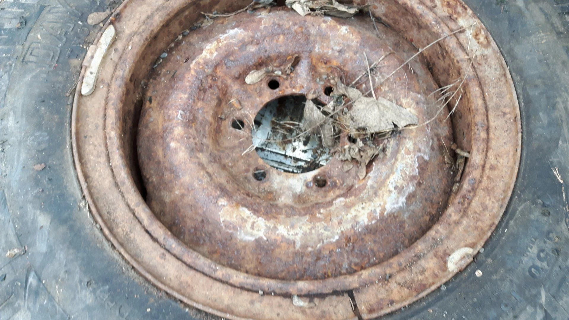

There is a terminology and resulting misunderstanding problem with this type of wheel. The Toyota type with a wheel and a removable lock ring are classified as "multi-piece wheel" by the US DOT and OSHA. They are NOT classified as "split rims" by the DOT.
I was a truck stop tire repair man for five years back in the 70s when 90% of them were still running on tube-type bias ply tires on multi-piece wheels. This design uses a lock ring to hold the tire bead on one side. The lock ring is nothing more than a snap ring. The lock ring itself is split like a snap ring but rest of the wheel is solid. If the lock ring is seated properly in its groove, as it is aired up it gets tighter.
The true "split rim" is an entirely different design. It also has a lock ring but it is solid. Instead, the wheel itself is split. In the common type the wheel/rim was split radially. When you dismounted one of these the two halves of the split wheel/rim were pried on until one side of the split overlapped the other thus reducing the overall diameter of the wheel so you could mount or dismount a tire. When you reassembled it you had to pry on the rim to get the two sides of the split to mate-up and hopefully stay that way when you aired it up. These things were flat-out scary to work on.
Bottom line is that as long as a multi-piece wheel (like the Toyota) is in good condition and you know what you are doing, they are safe. Be advised that if there is a lot of rust or the lock ring is bent or sprung all bets are off and it may not be safe.
