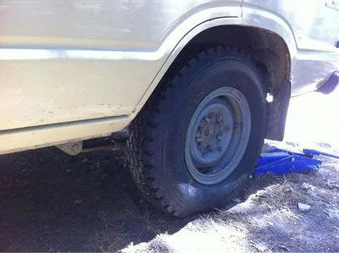

The Y735B is the tire I've used for the past year. I just replaced two of the tires which had been damaged in my recent vehicle theft.
@DrivingMissRosey
Been having a hell of a time tracking down a set of the Y735B tyres! I've sent a couple emails out to the shops you had mentioned and I hope to find a set soon.
Great looking tyres!
Thats odd. I have bought the same tires from two places within 20 miles of each other here in southern CA. Dinosaur Tire in Yucaipa and Ramona Tire in San Jacinto. Both sell Yokohama tires and specialize in semi trucks. I'd suggest that you find a truck tire place that sells Yokohamas and you'll be all set.
