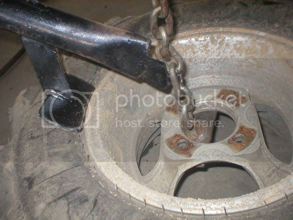

For breaking beads, I like the tool that has been passed down by my Grandfather to my Father and now to me. I don't have a picture, but it is a short length of chain with a hook which attaches to a horseshoe looking gizmo with a steel handle. Have broken bead on a metric shed load of bias ply tires with this critter.
Edited to add: Here's a similar critter.
power kings has great traction... just as the name implies... but... being bias ply they wear fast ... maybe 20,000 miles MAX
had them on my trailer .... now have the PK trailer tires and bias as well... they wear fast
@120mm
that is a great simple bead breaker design... i am lovin it... will need to steal the idea :)
What was the grandfathers name? like to give credit.... or give it a name of some sort
His name was LuVerne Schumann. Everyone just called him Verne, though. His design had a much stouter attachment point for the chain to the steel rod, and he bent the steel rod to give it more leverage.
