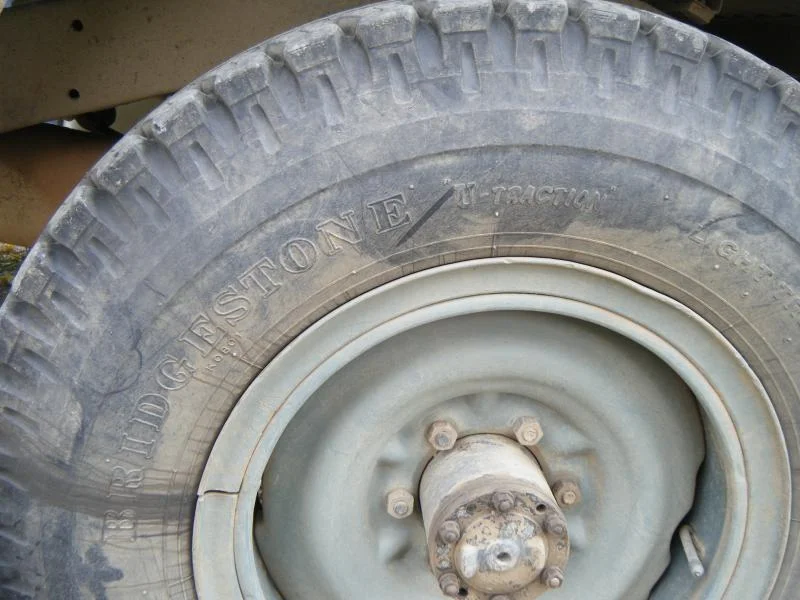

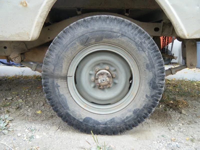

And because people clammer for photos I've included mine.

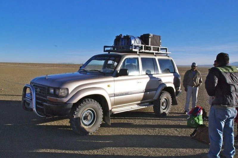

I run split rims on my patrol (in the picture) in oz... So, tubes and rust bands are available at pretty well any tyre place over there. i.e. it would be surprising to visit a tyre place that didn't have them in stock and on hand.
The patrol is a short wheel base, so any tyre handling issues show up quickly given the more squirrely nature of a short vehicle. So, in a lwb cruiser you may not feel it as much. I ran bias (cross ply) tyres for many years and several tyre changes and moving back to radials (and the wider track with the offset rims) was amazing. Turned the patrol into a totally different vehicle - massive improvement in handling especially on the heavily crowned oz highways.

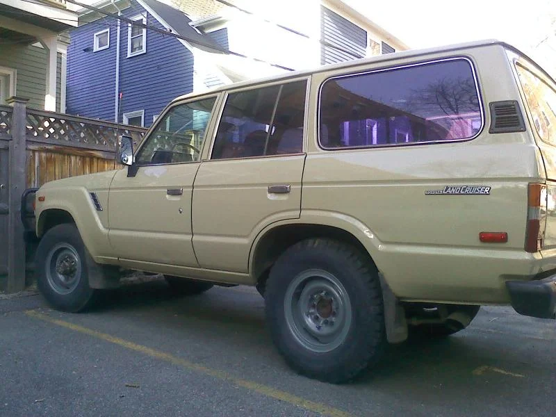

I dont know about 80s, but I haven't had to adjust anything on my 60 after 5k miles. I read on 40 series thread that some adjustments were necessary. If you cant find out any information if 80s get an adjustment, I'd put the splits and new tires on, and then do some testing in controlled circumstances.

Nice 60 by the way. Color and wheels are classic.

These are what I run on my truck. The rims are original. I sandblasted and sprayed then with tremco rust paint and primer.
The tires are take-offs from imported 70 series mine trucks.
I mounted them myself, with very little effort. Maybe 20 minutes for the first one and 10 for the other three.
They are not balanced and a very slight shimmy is apparent over 50 mph. It could also be from any of the 8 or 9 pivot points in the steering linkage.
