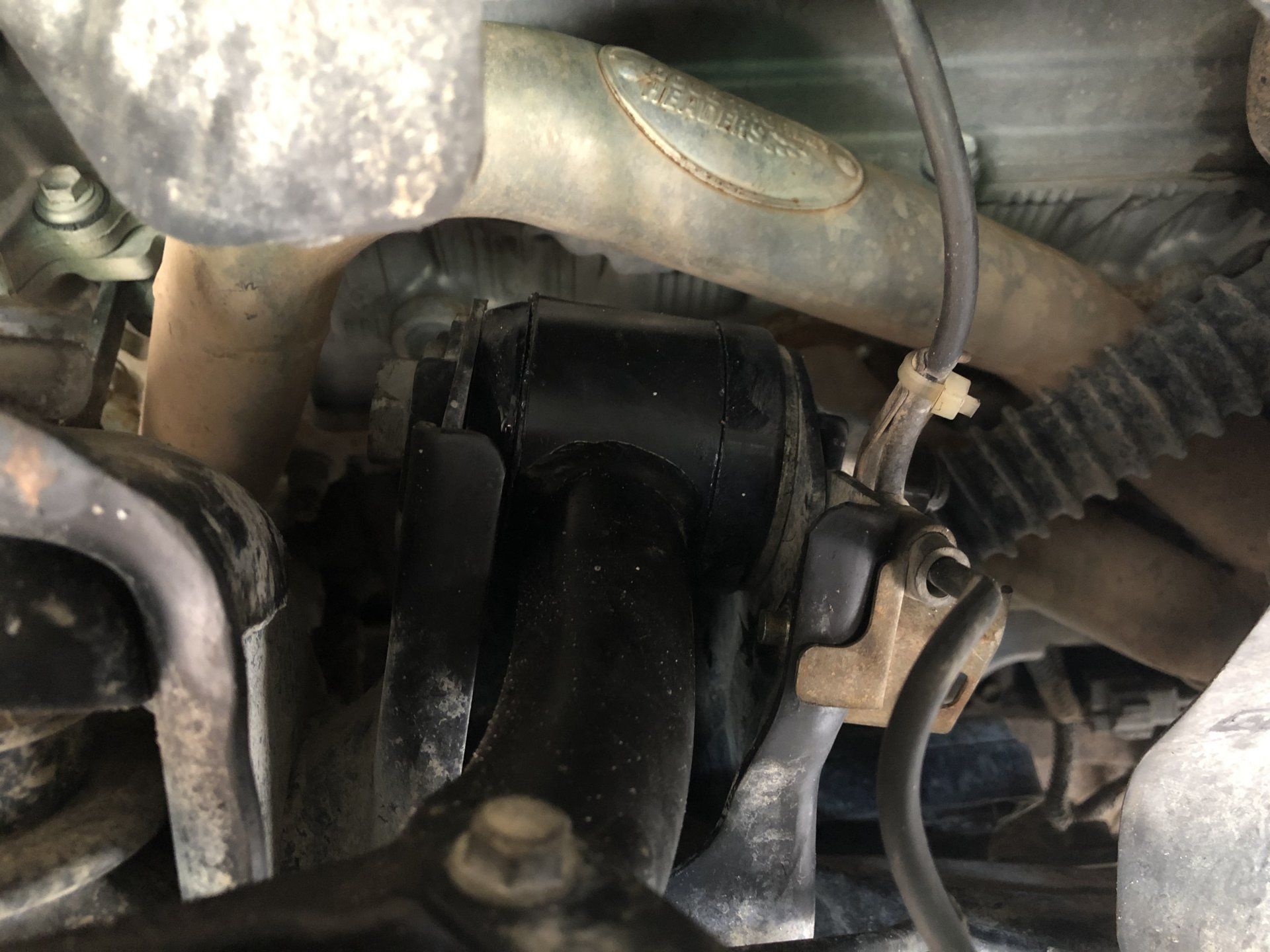

Here are my SPC. I find the zerks make sense and allow for grease.

^ Did you add those zerk's before or after install? I should have added them before mounted my UCA's.

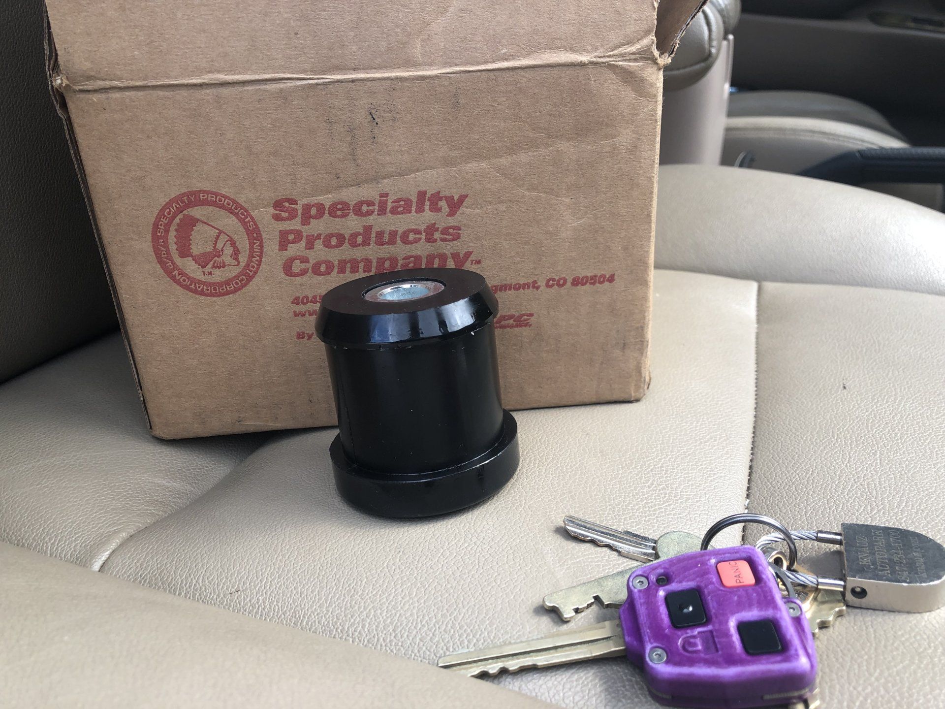

The dealership zerked them after my second set of bushings. The first set got strange and started squeaking like mad ( I do believe they were install correctly, with the grease etc ) Got a new set of bushings from SPC ( NOT easy to work with, btw ) So when the new bushings came in, after talking it over, decided to put zerks up there, the dealership ( Camelback Toyota ) drilled and zerked them. Made complete sense. Did the same on the 200, zerked the spc as well. It's pretty awesome having a dealership that rolls like a mom and pop shop. Thinks problems thru, let's you review your junk, in the back on the lift if need be and works to figure out what's what. Hats off to @murf!

I wasn’t there for the install, but it went rather quickly. And I didn’t have to spend 300 for the other updated version of the SPC bushings.

For those with the arms that have the grease zerk- how often are you adding grease and how much are you adding? Are we to pump until there's seepage like on the axle and needle bearings?
I use the dry grease for the spc bushings. Squeaked like mad until I unloaded a bottle of that on them. Haven't squeaked a bit since. Comes in aerosol form and the alcohol just evaporates leaving the Teflon (?) Dry lube
