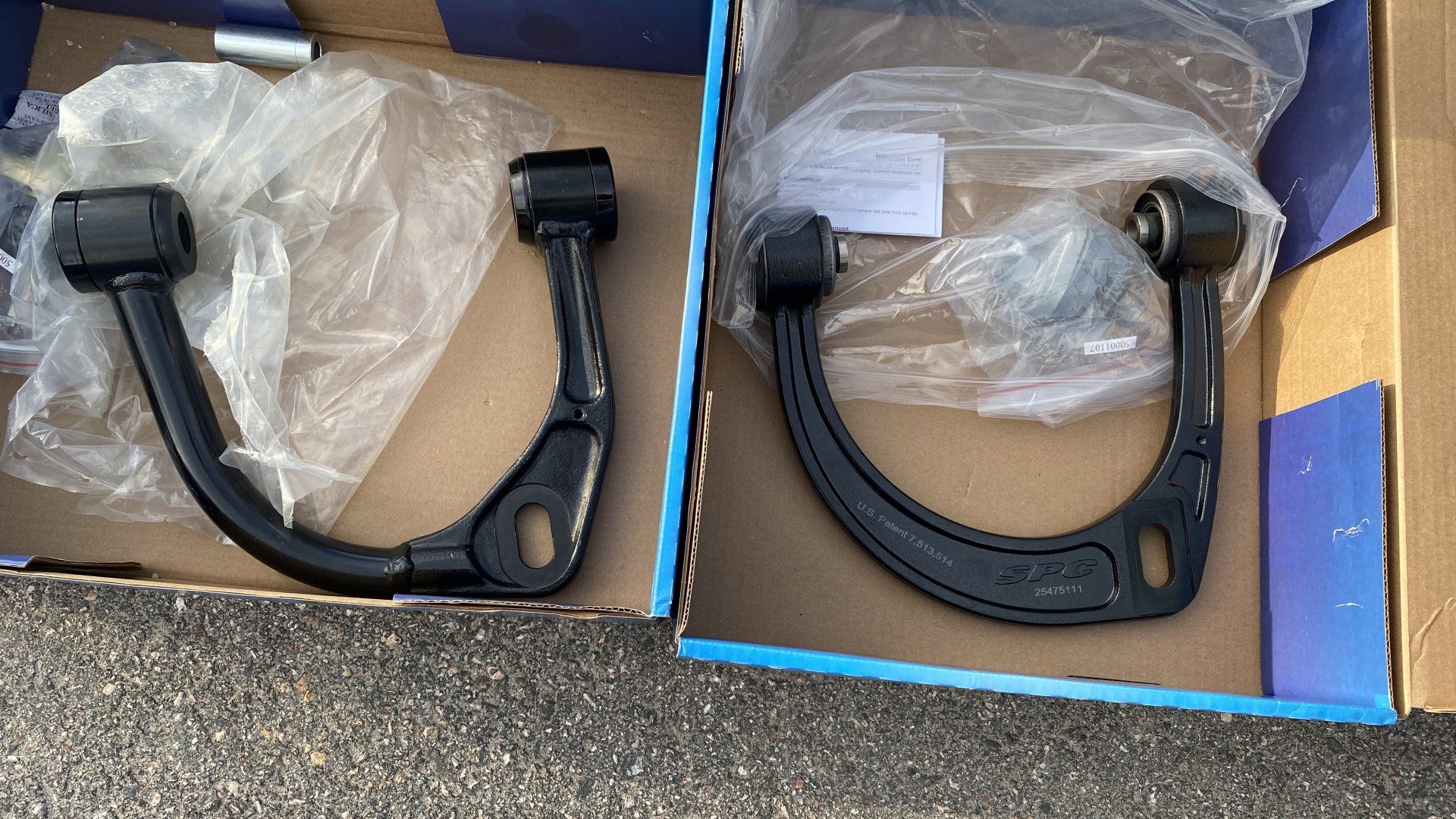

I got mixed pairs from Rockauto. 😞
The right side is current model, the left is older.
They are not, the other is upside down. See the square vs. oval hollow.
return one and throw the dice?
I was too late, they came via ocean wreight to me and over 30 days is gone. Rockauto says they can do nothing. 👺 I think the ball joint is indentical, so I left it as spare and try to order similar arm to left. Difficult, because the part no. is same dispite of the design (new/old).
They will function the same and have same critical dimensions. I will just install it and worry later.

Right, form follows function.
It does what it needs to but just 'looks' off ... still kinda suky
Meh,I guess its burried in the wheel well, so ... 😕
There is different type of bushings. Ok, it will fit, but it will not fit in my thoughts. 🤯
