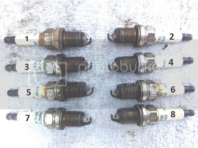

I have been base-lining a 'new to me' 99 LX470. Very clean for the year model and mileage, pretty good service history.
Went to change out the spark plugs a couple of days ago and got quite the 'scare'.
All plugs in the passenger side bank cylinders (2,4,6,8) came out easily (almost too easy).
But when I went to the other side (cylinders 1,3,5,7) all were tight and # 3 was REAL tight!
Over a period of 24 hrs. I managed to slowly back out the plugs 1,5 & 7 by soaking the S/P tube with PB Blaster, letting it sit and then getting maybe a quarter turn on the plug. Let sit for a while... then try again.
But the #3 cylinder was clearly going to be a challenge. I just knew a heli-coil was going to be in my future for that cylinder.
It's not good when you can only turn the plug about 1/8th round before it really 'loads up'. Even had it 'chatter' a couple of times. 2 days later (moving it a small bit and keeping it soaked) I finally got to a point where I could get 1/2 turns with just a good constant pressure.
I suppose everyone has a different technique, but some accounts I have read suggested turning the spark plug out until it binds then turn it BACK a small amount. I disagree with this strongly (turning it back).
Each time I would try to turn the plug back it would immediately try to 'seize'. You should not underestimate the heat build up created by the friction involved. Once you gall the threads in the head...its a done deal and nothing good is going to happen after that.
Take it slowly, let the penetrating oil work. Don't expect to get much movement out a plug as 'stuck' as mine were. By not 'forcing' it I was able to get all the plugs out without damage to the head.
When installing your new plugs....do NOT over-tighten them. There is some controversy as to whether or not using an 'anti-seize' product on the plug threads is helpful. I did on mine. Went back with a light coat of Copper Anti-Seize.
So glad I didn't ruin a cylinder head, it was nip and tuck for awhile.

186K on the LX. My best guess is the plugs are the originals, judging by the appearance and erosion of the electrodes.
Before purchasing the vehicle I obtained a CarFax report (pretty much worthless) but also service history reports from 'Lexus Drivers'. The L/D reports (while not always detailed) showed so much more than the CarFax.
This vehicle missed it's 90K scheduled service (timing belt, spark plugs, ect) so I doubt they had ever been changed. The timing belt and pulleys/tensioner was done at 156K when one of the pulleys seized and shredded the belt (resulting in a no start condition). All of that is documented.
As for 'torque' figures on the spark plug....it is a good 'guideline' but personally....I will rely on 'feel'. The reason being...each thread bore is going to be a little different in terms of its condition when you remove the plug from it. Some amount of residue (carbon from plug, and galvanic corrosion). Since the plugs use a flat washer to create a 'seal', I just run them down until I can feel the 'crush' and then stop.
