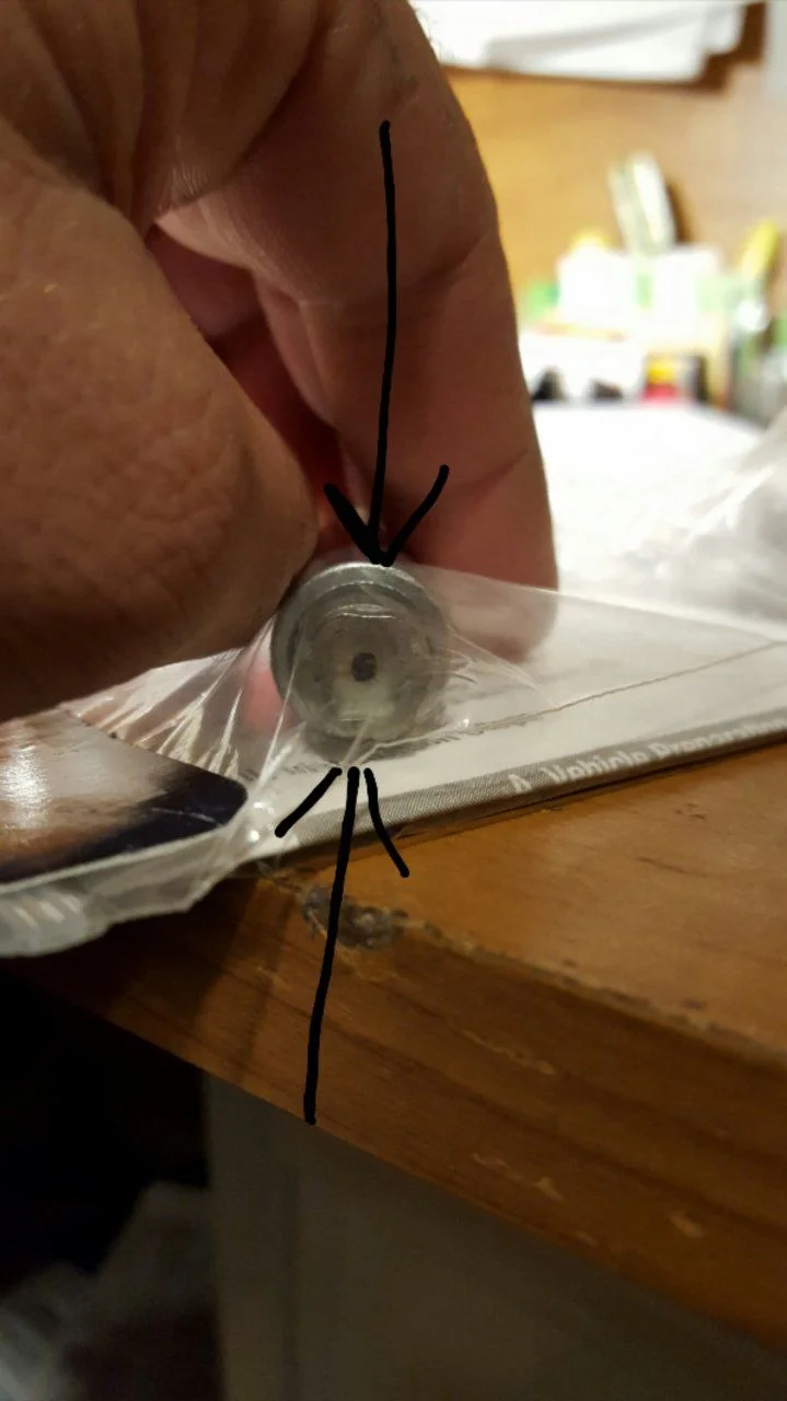

I know this thread is really old, but you wouldn't happen to still have this joyous little tulip looking lock would you? I tried one from an '05 Tacoma (the ones you can find all over the net PT276-34071) and it is really close to the shape, but the bottom and top curves are flat, making it useless to the '03 Tacoma.

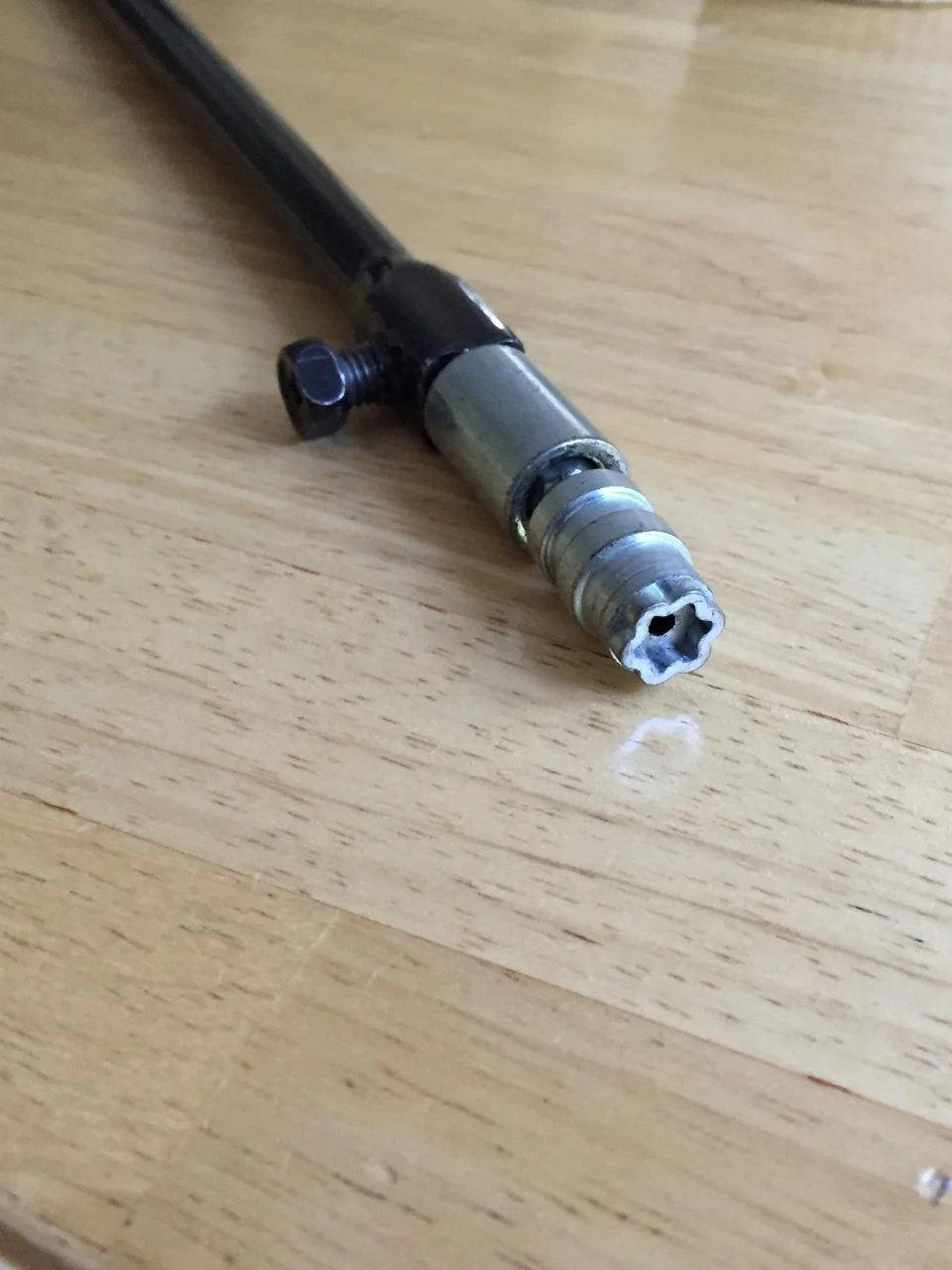

I don't frequent the site as much as I used to, but just saw your query. In fact I do still have the tool. Here's a pic. Just send me a PM with your contact info and will make it happen.
Glad this thread got bumped when it did. Subtle reminder to RTFM on my part. New owner here.....haven't thought to test out the spare yet. Had I not just seen this thread and gone outside and looked, I may have been unknowingly setting myself up for failure on the side of the road in the future. Luckily for me, PO left the tool in the kit thank goodness.

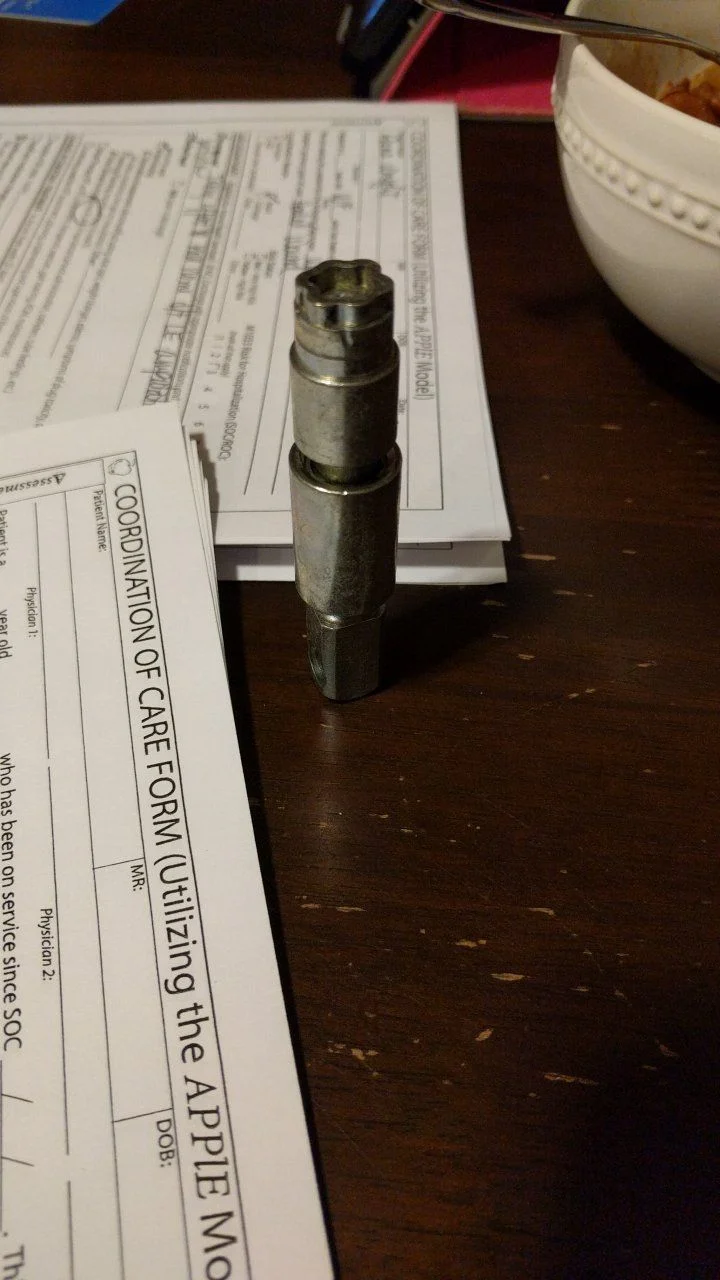

Also, a side note, the above part number is for 2003 - 2004 (00276-04960, aka PT276-04960), it is pretty hard to find, However... the 2005 - 2007 (00276-34071, aka PT276-34071) can be found all over the web is like this tulip, but flattened out on the top and bottom. Here is the key I am returning.

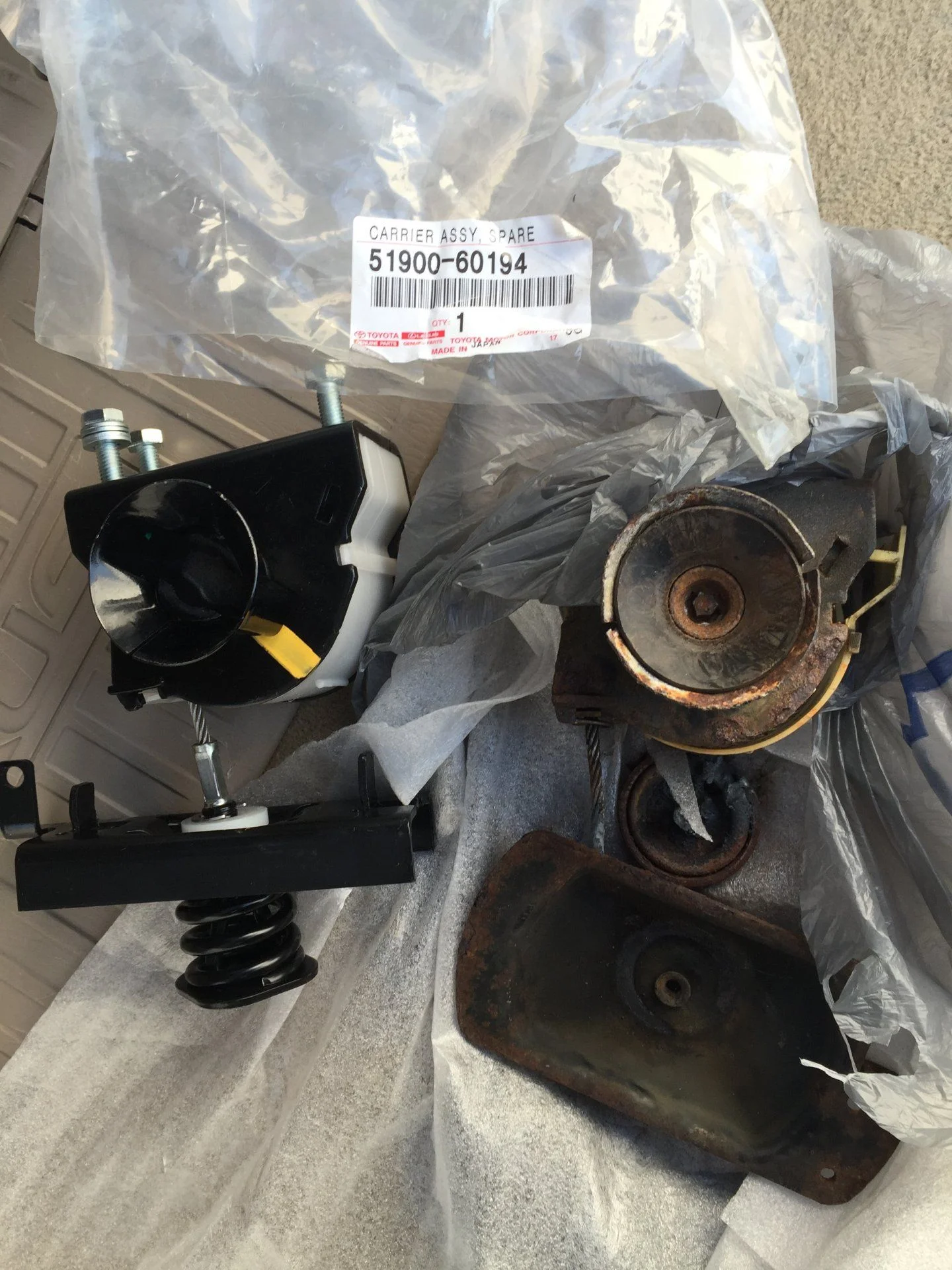

Hey Whiskey - do you still have the hoist you removed? Interested in selling? Mine is rusted beyond use (and removal).

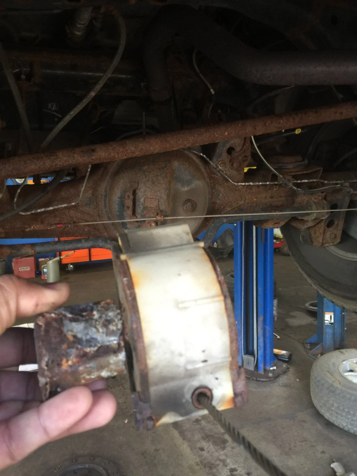

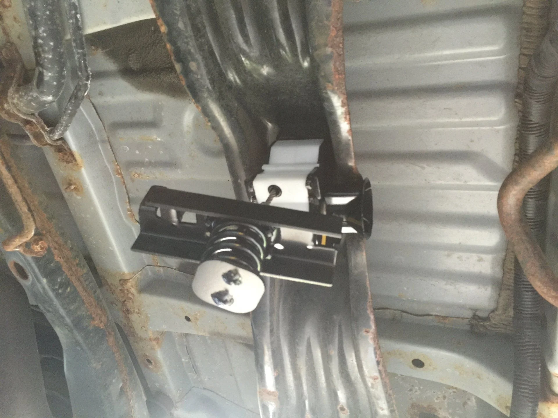

I used a ratcheting wrench on the back side of the cross-member to unbolt the 4 bolts that hold it to the cross member. Obviously I needed a couple jack stands to hold the tire up after I unbolted them.
I then ground two welds off of the side of the tulip-shaped interface and it came off with some channel locks. Underneath it is a standard slotted interface.

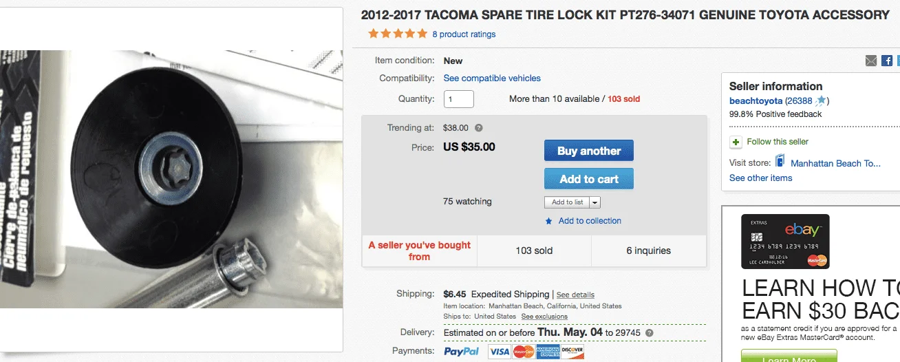

We have a 2007 TLC in the family and this is what it looks like inside there......had to order one of these I found on ebay.....
PT276-34071
It says for 2012-17 Taco, but that looks exactly like the one on the 07 TLC.....
