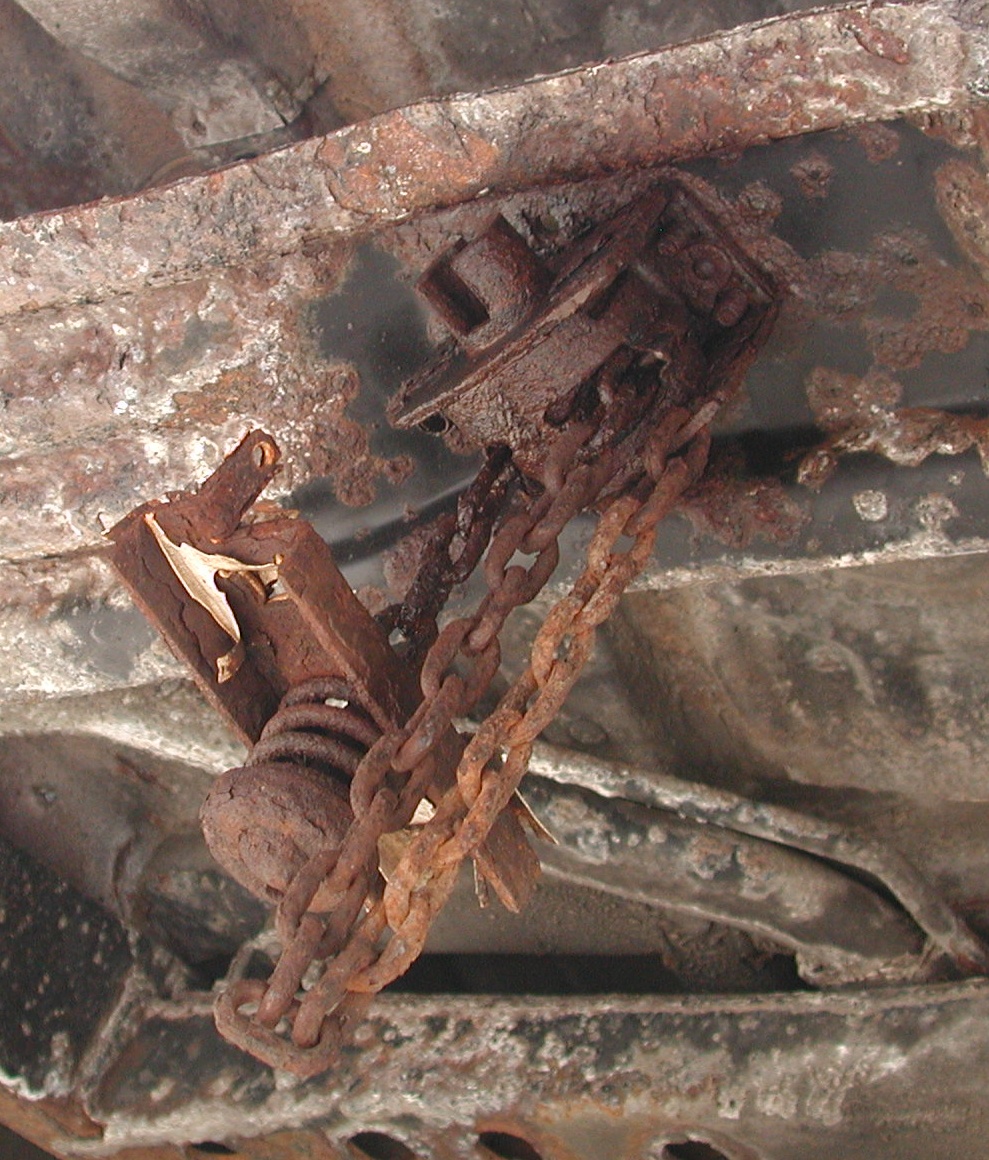

I see I am not the only person with a rusted out tire hoist.
Good news: After a week of daily penetrating oil, lots of hammer whacks, and quality time with a 24" pry bar, I got my center shaft to move.
Bad news: The chain isn't moving.
I'm guessing the spindle should be turning with the center shaft? All 4 bolts have been removed, but there is still not the slightest sign of the hoist coming down from the cross member. What's up with that?

Make up a 50/50 mix of acetone and ATF tranny fluid, soak that thing, let it sit a while then whack it with a big hammer. The rust has glued it on. That should get it off.
Mine looked pretty much like that, I got a nice used one from cruiseryard.com for cheap.
If you've removed the four bolts that mount the hoist to the plate (you haven't in that pic) then the hoist will drop. Rust is holding it in place otherwise.
I'll take a look at mine later tonight and see if you're missing anything.
All 4 bolts off. I'm whacking it with a 2# hammer. No sign of wiggles. I need to patent that rust.

If I were you, I'd take an angle grinder to the six bolts holding the cross-member on and the captive nuts. That's what I had to do. And then when you reassemble it, use nylocs and two wrenches.
Once you get the crossmember out, everything becomes easier to work on.
And be sure to knock the rust off it, etch and prime and repaint.

If you can find an eye bolt with an eye the size of a quarter on a long threaded rod you could put two nuts together as a jam nut and turn it with a wrench.

What I did was place the bottle jack under the spring and twisted it up just using my thumb and forefinger until I could no longer turn it. Then I put the tailgate down and put some of my ponderous bulk on the gate a few times to compress the spring. I was then able to lower the tire down but now I can't get it to retract.
