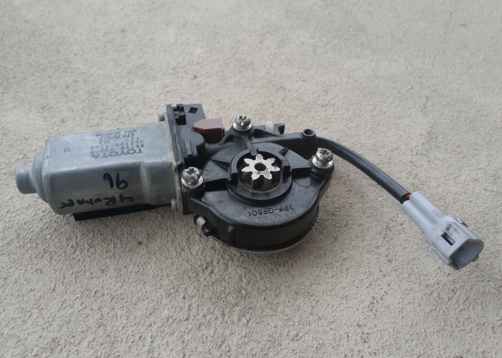

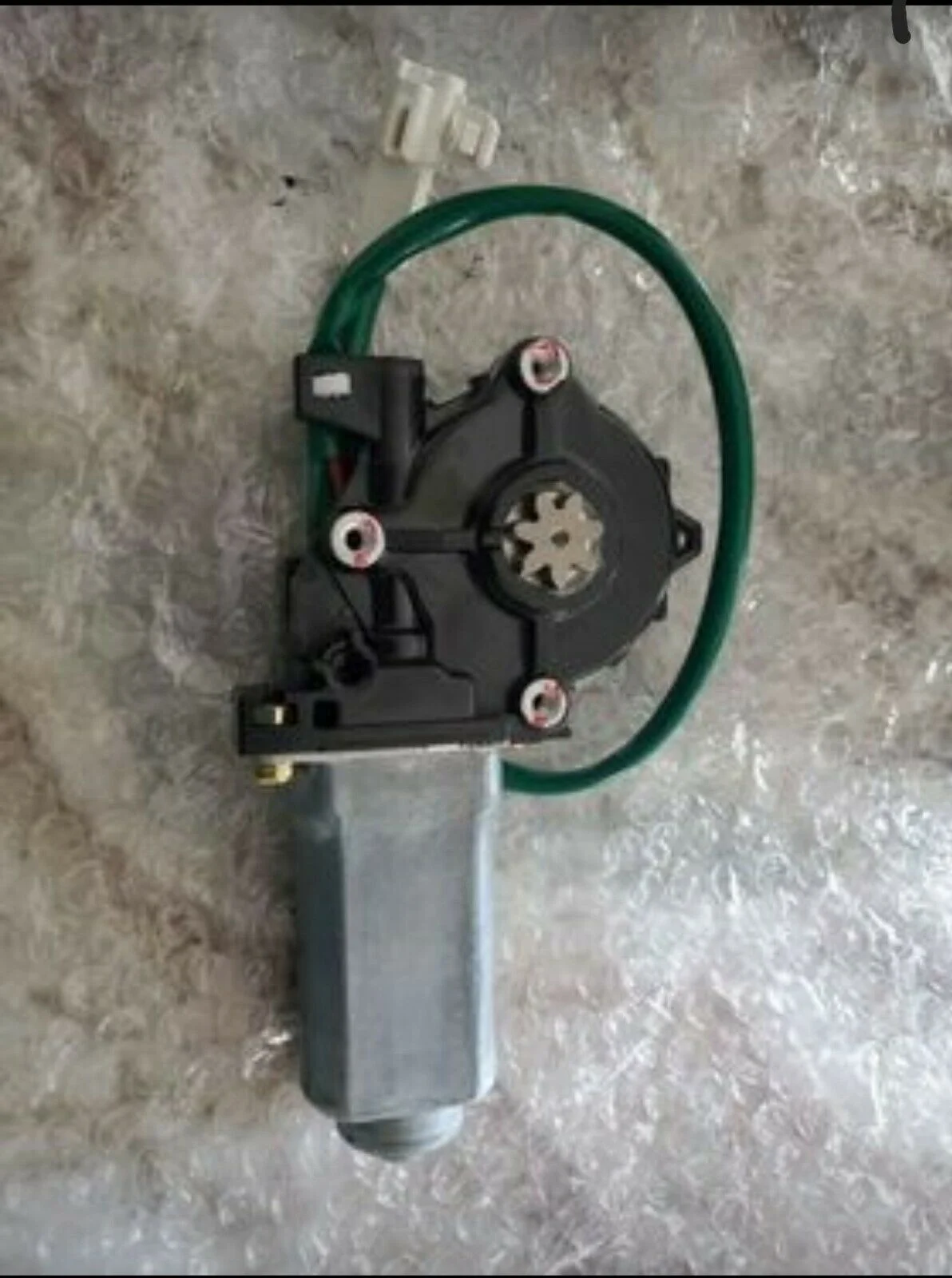

i would take a leap of faith and scoop up this ,
u may luck out and the motor brushes for example are the same or the part that failed on yours is here ?
no affiliation
but the asking $ is too irresistible to not see and well see what u can SKUNK WORKS here ? :)
both have 7 star drive gears !

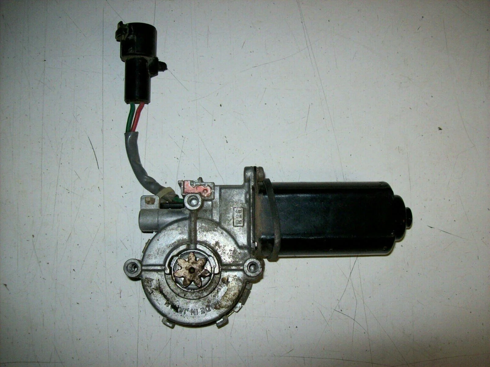

I saw recently that one of the door motors will work on the back window. You can get them at Rockauto.com for less than $45. I haven't tried it. I think you need to move the plug over, and some of the Rockauto motors are bare wire.
I've read that the 3rd gen motor works and is either still available or at least ten years younger from a model that didn't REQUIRE rolling it down to open the back door.
The motor from a third gen (85710-35090) has a reverse layout so it doesn’t look like it would work.
