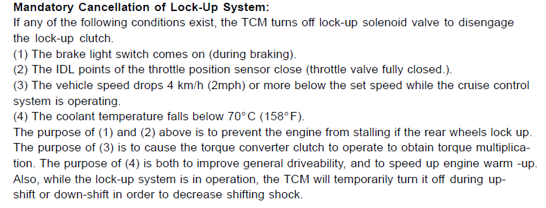

I don't think my US-market A442F will drop out of lockup from throttle alone unless it's enough to trigger a downshift. It *definitely* doesn't drift in and out of lockup just driving down the freeway.
Tapping the brake pedal -- like you might do to disengage cruise control -- will cause it to drop out of lockup.
Have you tried driving while lifting up on the brake pedal with your left foot? (Obviously not in significant traffic)

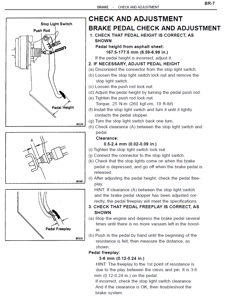

While driving to Windrock, the guys behind me said that my brake lights would come on and off with the bumps in the road. This was similar to what I was feeling on the way home for Windrock with the transmission. I just checked and adjusted the brake sensor switch. It was way out of adjustment and the slightest touch would cause the brake lights to come on. Spec is .5 to 2.4mm of the inner black switch showing. Mine was closer to 4mm.
Is it dropping out of overdrive, or out of lockup? An ~8% change doesn't seem like enough to be a shift from overdrive. The A343F has a .753:1 overdrive ratio, and the A442F is .765:1. Both are 1:1 in 3rd gear.

I adjusted the brake sensor switch and installed new OEM pads (100 in the front, 80 in the rear). Today was the first time I've taken it on the highway since bringing it home from Windrock. I watched the tach like a hawk as I was driving and could not detect a single instance of stuttering or ghost shifting. I'm still not 100% certain why the brake sensor switch would cause the transmission to act up.
That's from the '94 (A442F) FSM, but it's probably identical for later models. Certainly with regard to the brake switch causing the torque converter to unlock.
If you mean why it went out of adjustment, did you check that the return spring is intact? Maybe something with the master cylinder means the push rod isn't fully returning? Maybe the push rod lock nut loosened and started drifting?

Now THAT is some good information!

Excellent find! My brake return spring is good. I just think the brake sensor switch has always been very close to the limit. Changing the booster meant that 1mm or less difference put it out of the brake sensor switch threshold.

Is the small plastic pad (CUSHION 90541-06036) for the Brake light switch present?
I meant to include that the cushion broke when I replaced the booster. I ordered the OEM replacement and installed it a few days later.
