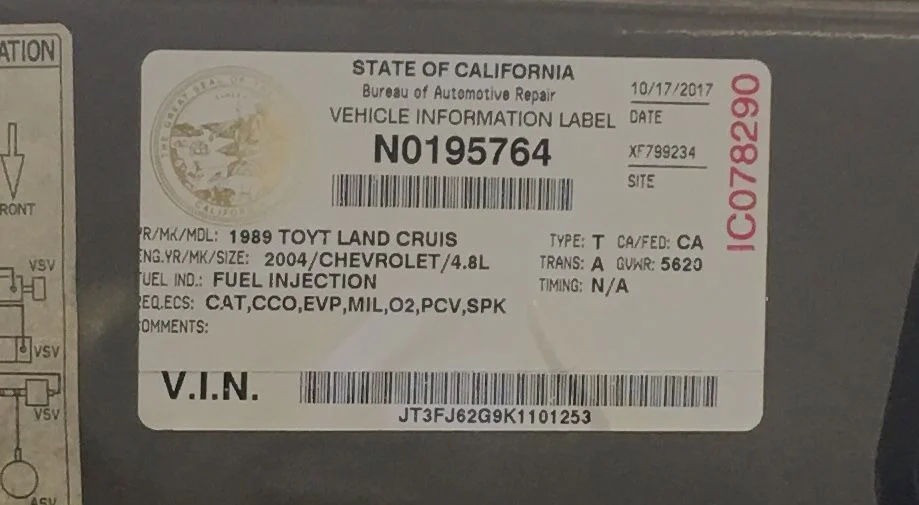

I can finally close out this thread!
It took me three months to do the conversion and 18 months to get the sticker.

Congrats on getting this thing through all of your bureaucracy, I would not have the patience let alone the skills to survive any of it. Hope you are enjoying the fruits of all your labor:clap:
