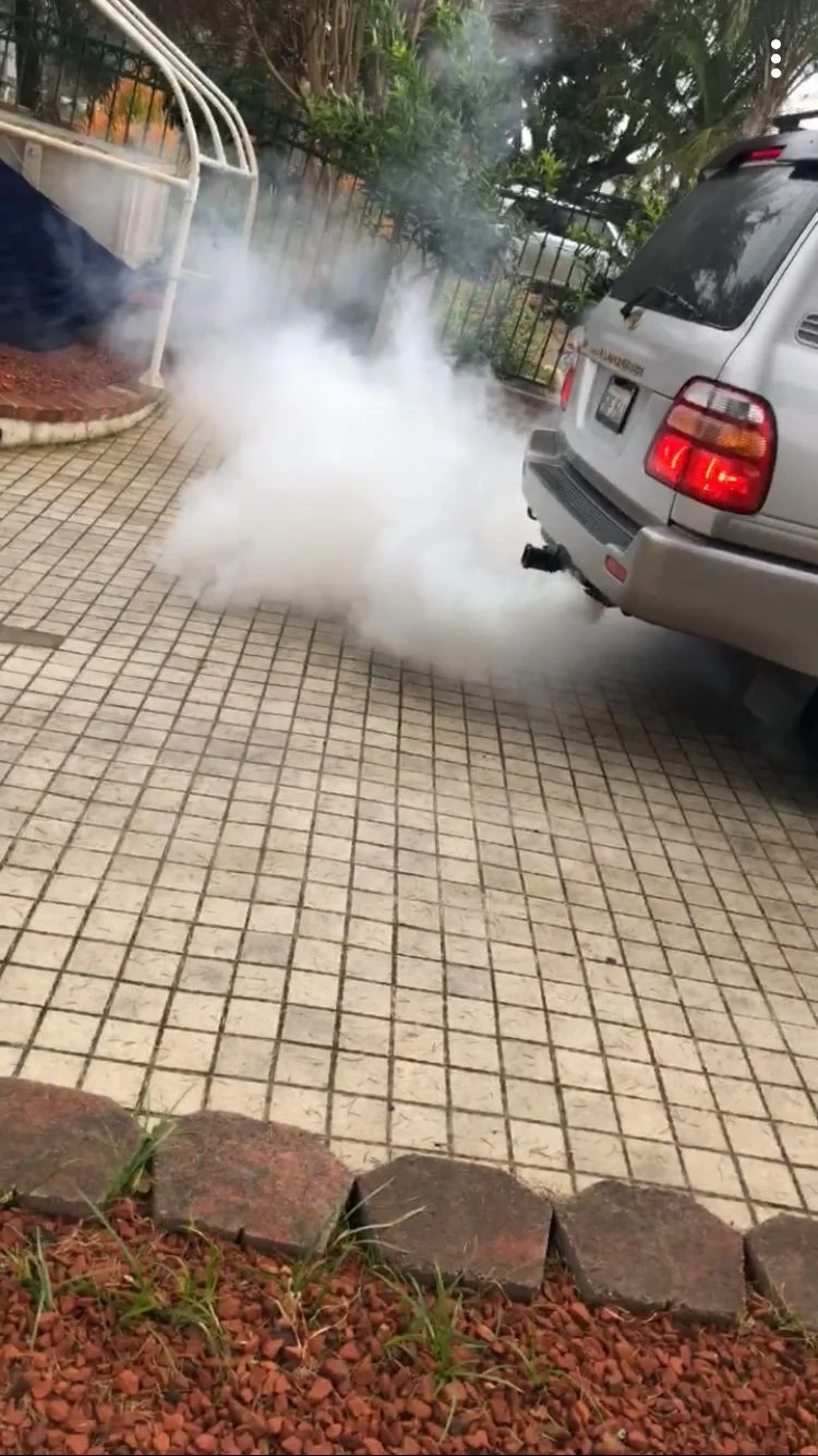

I did a seafoam yesterday on my 99 LC and now have work to do.
Basically used 1 can thru PCV hose and another can added to the gas tank. A lot of smoke came out. Took the car for a drive and 15 minutes later the car starting working very rough (misfiring). Took to PepBoys to check the check engine codes and it showed P0300, P0302 and P0308 code. Came home and replaced #2 and #8 coils with spare ones. It got much better but it went bad later that night again. I have ordered 2 coils from Norwalk and will change once they arrive.
