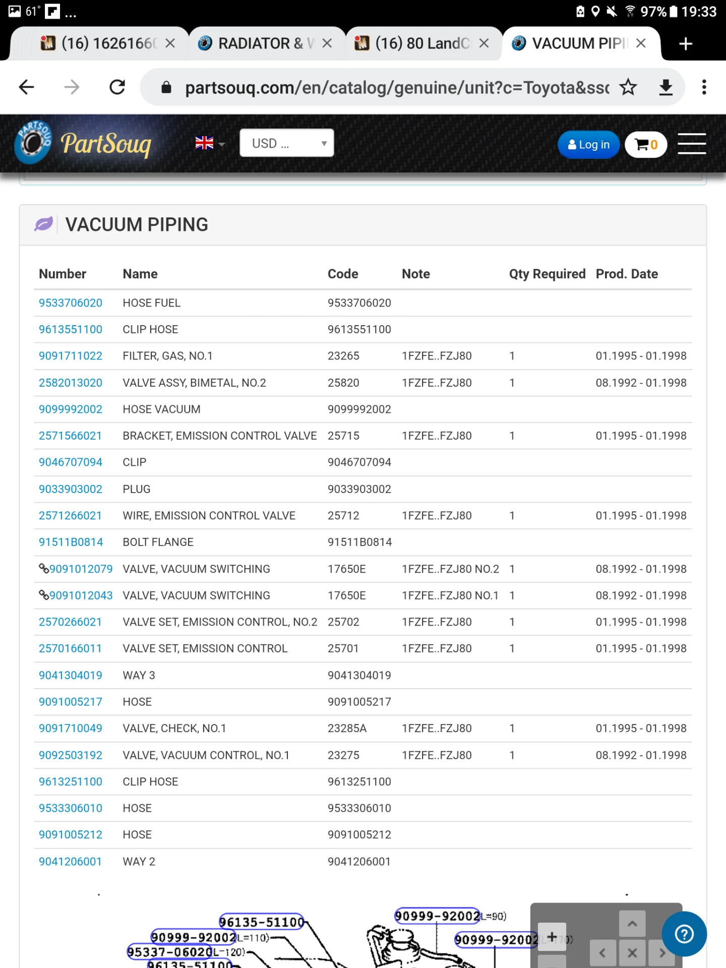

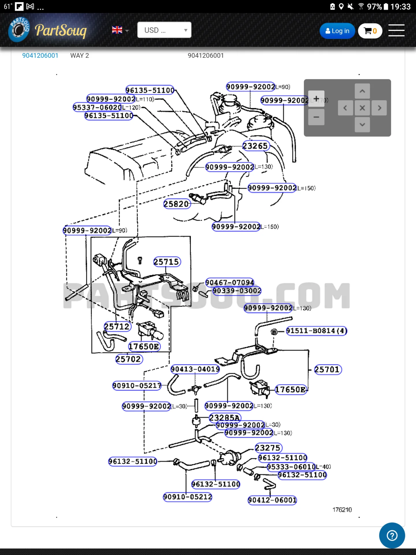

Seven years later and not a drop, so the replacement fuel tank has held up well. Of note was the need to replace a vent valve which is located under the Upper Intake Manifold which allows the fuel tank pressure to be routed to the charcoal canister properly. If this valve (*check & cut" valve?) goes bad, it will allow the fuel tank to be pressurized and form that oil can dent from the first set of photos.
I didn't read fully back through it, but the long term fix was that valve and a new OEM fuel tank. The brazed tank didn't last long, and the bad valve may have been to blame for that failure, too. Once the valve was replaced and a new tank went it, back to 100%.
I wonder if you could put something over it before it cracks like a JB weld type of thing to help it just a thought
Hi Thomas - which valve are you referring to? Not having any issues at the moment but it may be a PM item when I pull the manifold in the next few months. Thanks
