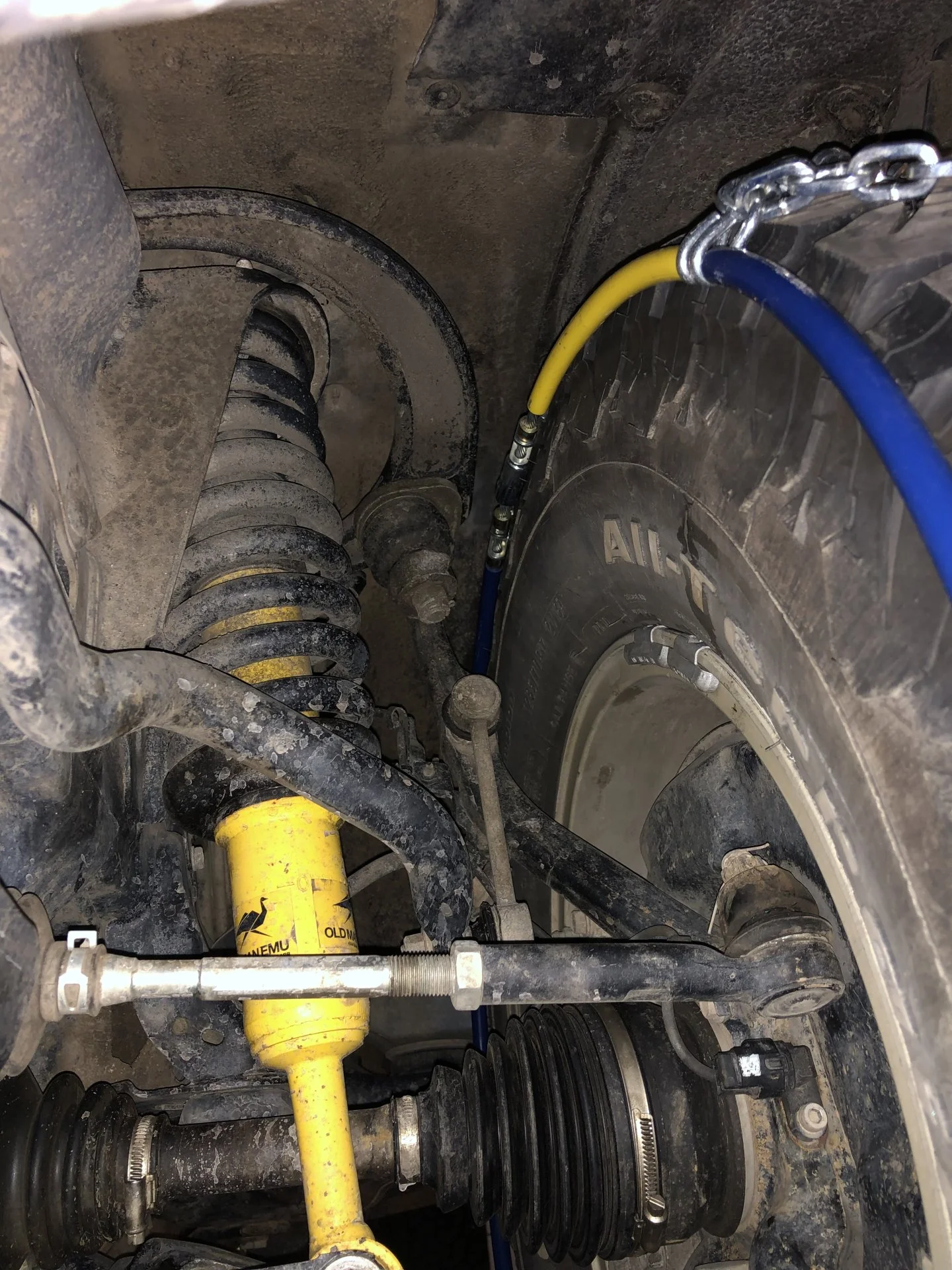

If you need chains you probably need 4. 2 are better than none tho. Also, if you don’t have the clearance on the front from the UCA you may not be able to fit chains up front anyways.

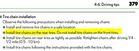

According to the 460 manual, rear tires only. I assume it would be the same for 470 but ¯\_(ツ)_/¯.

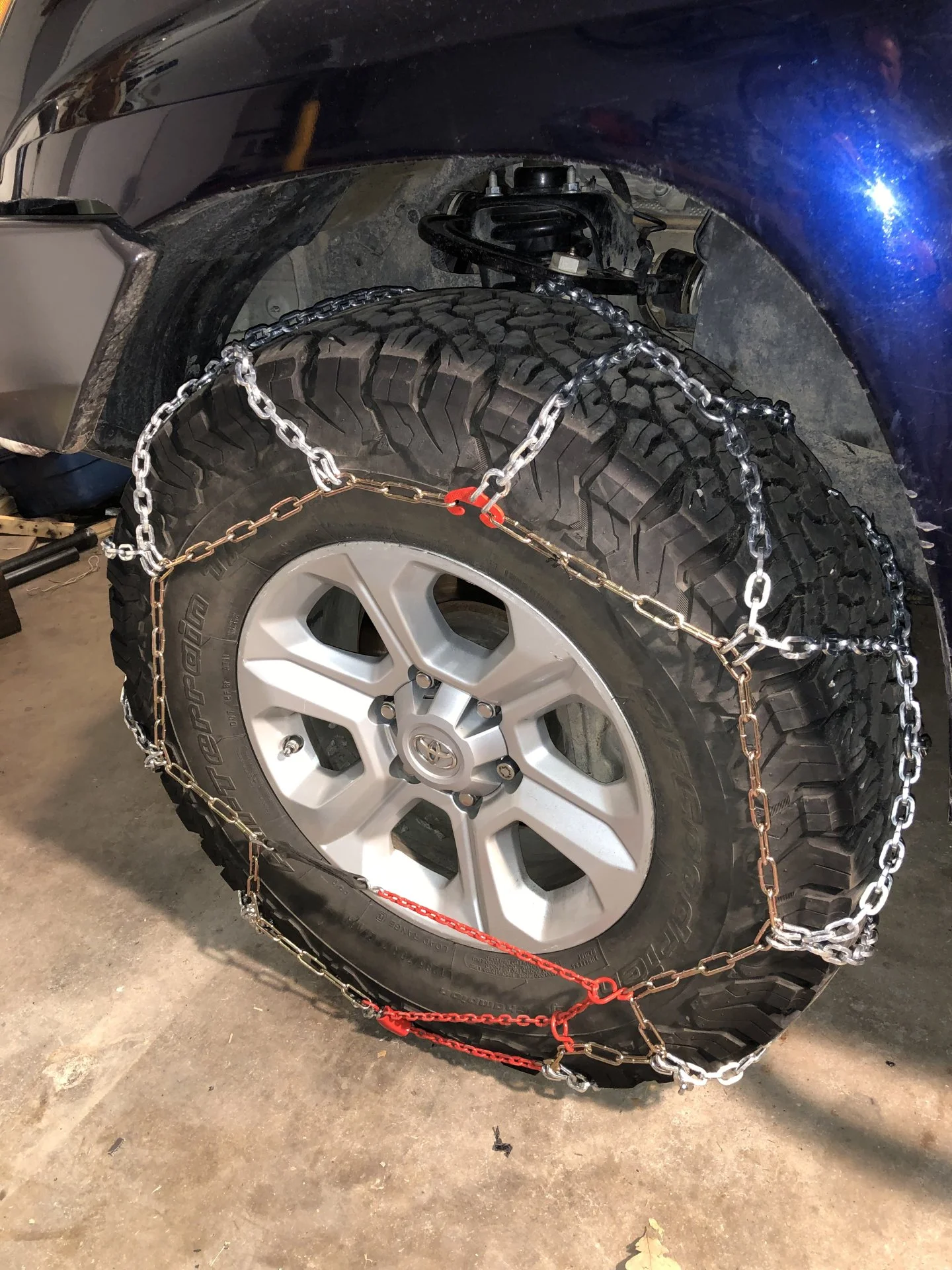

I specifically wanted to run 4 chains on the GX so I got 4Runner wheels to increae spacing off UCA. It is that lack of spacing for the rear only “restriction”. I have run 4 chains hard on the GX, just to see what it was capable of. In front I went with RUD after a lot of research. I found a like new set for a good price On CL. In the rear I run standard semi-chains (285 width) and cut them down. They have the cam tightners and much cheaper to get them from a truck stop, cut, and reweld as compared to buying light truck tire chains of a particular size. I ran those semi chains hard on my LX450, lots wheel spins at times. Only problem I had is I did throw a chain once and took out my right front ABS wire.
Anyhow, no problem to run 4 if you have the clearance and I am happy with the RUD chains. Here is a link to my build thread showing front chains and clearance with a bit more detail.
Also, here is another link with pics and video of finding the limit in snow.

I do have a 3" lift and SPC upper control arms so I think I should have clearance, at least in the rear. Good to know that running 1 set won't cause damage.
I also found in the GX manual where it mentions chains also says to put them on the rear tires.
It’s the wheel offset that will determine if you have room on the front. How close is the wheel to the UCA?
