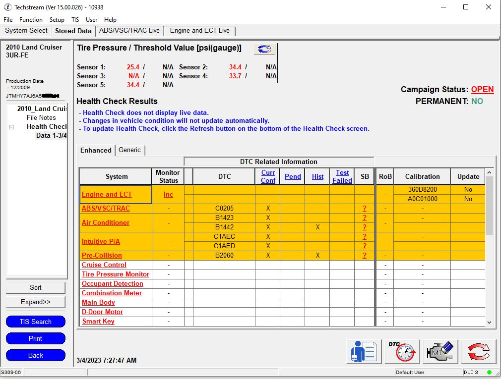

The following morning, I pulled out my laptop and hooked up tech stream to see what chassis codes there might be. When I initially started the truck in Casper It had PCS and VSC warning lights. I was aware of the VSC light when I initially bid assuming it was a wheel speed sensor and according to Techstream the driver side wheel speed sensor is the culprit per the code. The P/A code is associated with the damage to the rear bumper and a loose sensor in the front bumper. The air conditioning codes suggest I need to reprogram the servos and that it is low on Freon. Its been too cold to test so I'm not sure how low on Freon it is.
codes-2-png.112272
None of this was really a surprise so I poked around a bit more to see what we had gotten into. I knew from pulling the Carfax that it lived between Jackson Hole and Scottsdale where it was serviced by Toyota regularly, so I was not expecting any hidden surprises. While driving it I noticed that it felt a little unstable and floaty on occasion and after looking the suspension over I found that the driver side strut has failed, oh no, I guess I will need to change out the suspension now...

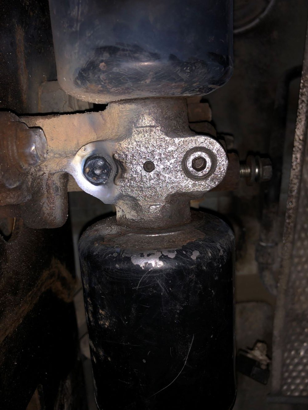

You can see how bad the strut I mentioned has failed here.. It's been bad for a while I suspect. I also found that the brake pads are nearing the end of their life, so I've placed those on order as well. That reminds me that I need to check the FSM and see what the spec thickness of the rotors are. With the old sensor out and the new sensor in I bolted everything back up and cleared the codes. With everything looking good It was time for a test drive. After driving about 20 feet traction control kicked in, I let off the gas and got into it again and the same thing happened. Going about 20mph I depressed the brake and felt the response of the ABS on the driver side front. With techstream hooked up I could see that the sensor was giving a different reading than the other 3, I guess I haven't fixed it yet. Wanting to rule out a faulty sensor I swapped the rear driver with front driver. After driving around my block a second time I was met with the same results. Trying to eliminate out the harness as the issue I unhooked and unbolted the passenger and driver side harness and swapped them. The results were the same, the driver side speed sensor is still not reading the same as the others. This leaves the hub to be my next object of study. Knowing that ill be doing brake pads and struts on that side I'm not too concerned and will dig into it in a few weeks when those parts arrive.

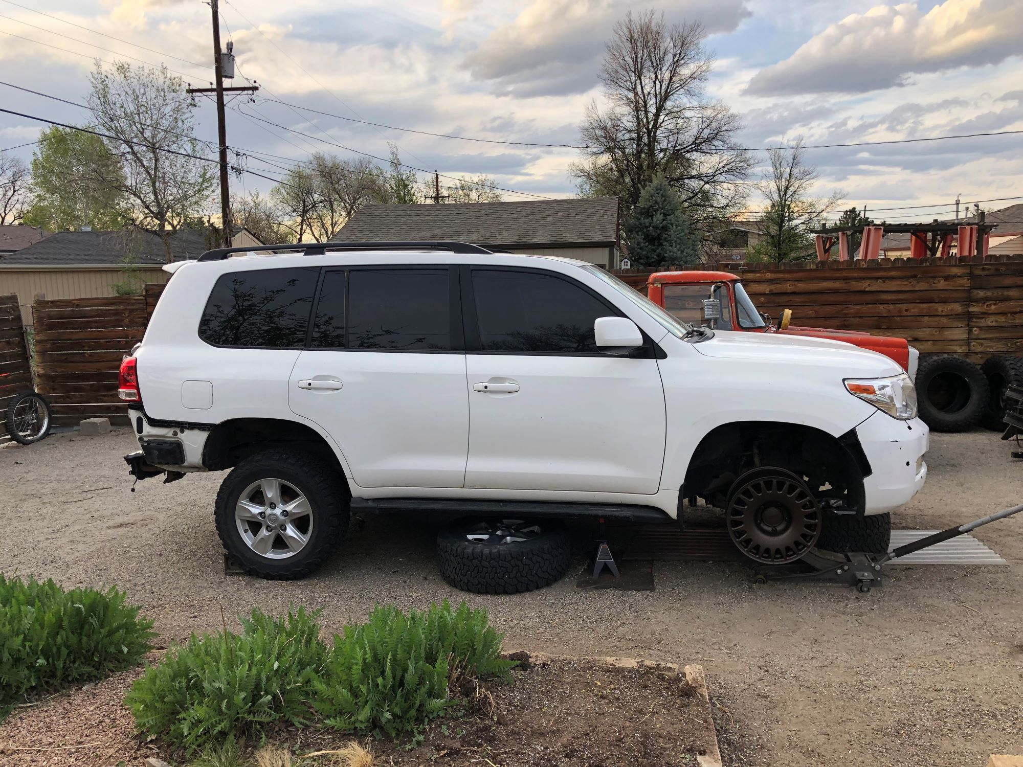

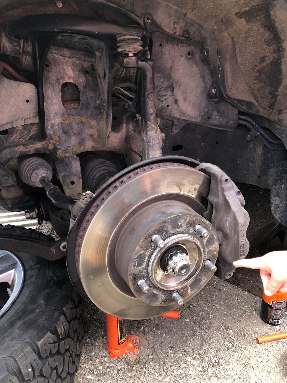

Now I could finally install the lift and brake pads. I Installed the new brake pads without a problem and then I moved on to removing the front coil overs. I took this opportunity to slide the Axle back enough to clean the housing with some 1500 grit sandpaper. Aside from being a little dirty there was no obvious signs of what was causing the abs to trigger.
With all that stuff removed I was able to finally install the front struts. And then with the help of a friend and with little effort we had the rear springs and shocks installed. It sure is sitting high now, and definitely needs an alignment.

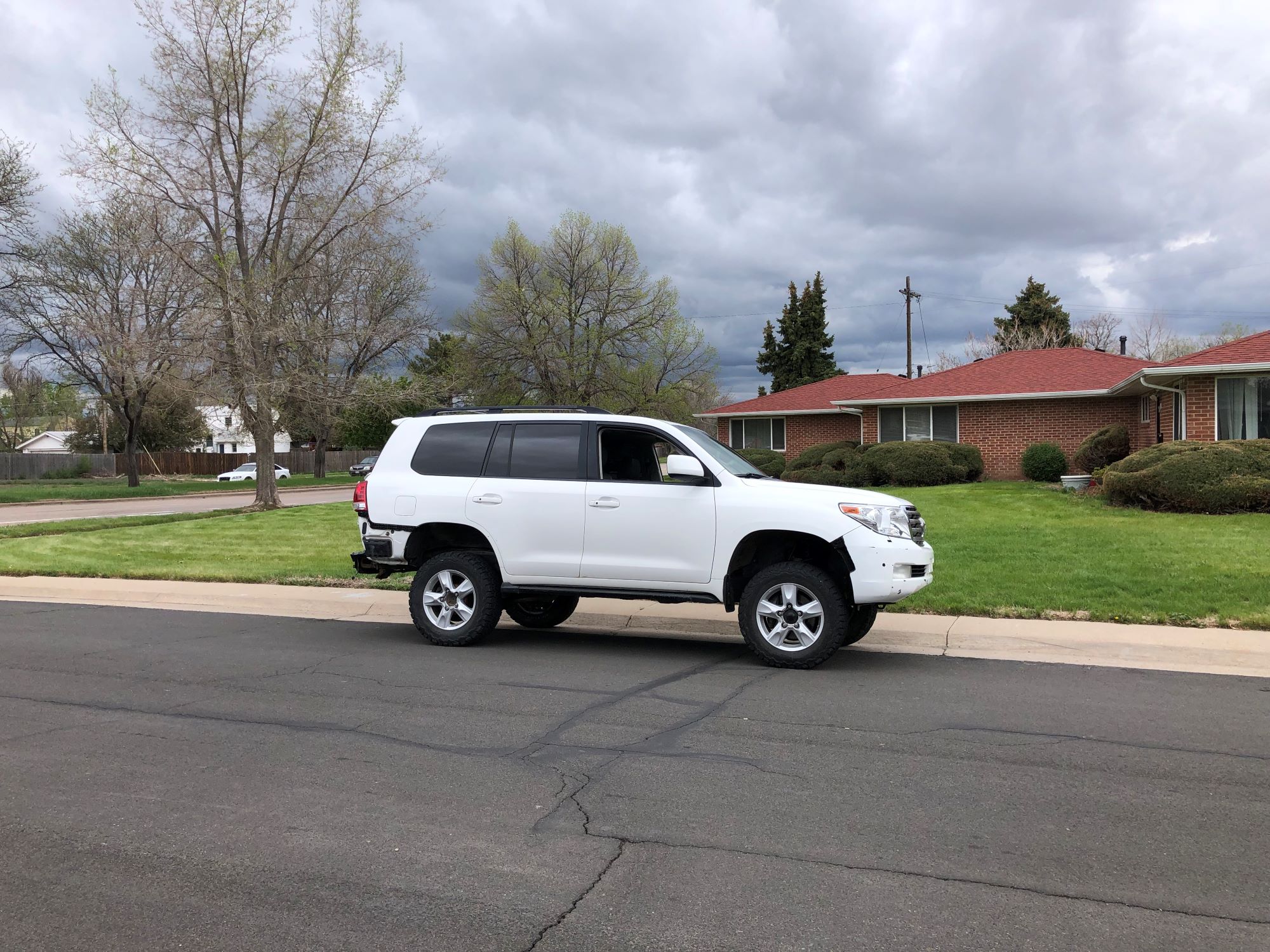

Another month has gone by, and I've been on task with the 200 project. While installing the lift I concluded that the driver lower control arm eccentric bolt was seized, preventing what would be a good alignment. So, I bit the bullet and ordered a new one from Toyota and tasked myself with removing the old one. The diablo blade on the sawzall is the trick and made quick work of the bolt and I had the new one in just as quickly.
I got everything together and was ready to get the alignment done. The shops I trusted were 2 weeks out and against my own advice I trusted the neighborhood shop when they said that they could do it. As it turns out they could not do it. Fortunately, they said they couldn't get the tie rod lock nuts free, of which is a lie, because I personally broke them free prior. But not before they flattened all but 2 of the alignment tabs.
Well they sure messed that up and got an absolute ear full when they opened up the next day. I knew what needed to be done, so I hammered the taps back with a punch and then welded reinforcement to all of the tabs. Given the circumstances I made quick work of the repair and got the LCA's bolted back up. I also scheduled the appointment to get it aligned at a trusted shop, which gave me time to start installing the wheels and tires.
With the wheels and tires mounted I started installing the front bumper, having removed this exact bumper and a newer version of it I was able to get it this one installed in record time. On another note, we also got our plates. We left this decision up to our 3 year old son. The first choice was Sneeze, but unfortunately that one was taken, who would have thought. The second choice was Grey Stomp, which is his nickname for me, because I have grey hair and stomp around the house. The third choice was TOE. I still kind of wish we opted for TOE.
The rear bumper support bar was looking pretty rough, so I followed the procedure of another member and cleaned and painted it before installing the rear bumper. This procedure was wire brush, rust converter, wire brush, rinse and paint with rustoleum rust converter. It came out looking very solid for the amount of work it was.
With the rear member painted I was able to finally begin installing the rear bumper. We lucked out with a SLEE rear bumper with all the fixings straight from the source. We have a BIO rear bumper on our 100 and so I was familiar with how it installed and expected it to be as easy if not easier to install. It proofed to be as straight forward and might I even say fun to install. It sure looks bang up.
