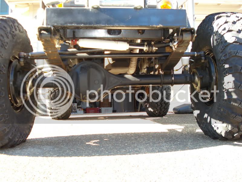

when driving, it seems to want to turn harder right than left. Left seems quite controllable but going right has a vague center to a good initiate the corner, to a feeling like it wants to snap oversteer. On a vehicle with bias ply, 38" tires - it does add a bit of drama that I'd rather not have. Absolutely everything under this is brand new
I know I could live with this, take some camber out and perhaps give it a bit of toe-in.
So the basics, what do I look for in any vehicle that goes from vague steering to oversteer?
Driving down the highway, driving along country lanes at full tilt, it drives and feels solid - nothing pops it off its line... it's just the right turns. A couple times I was in an oncoming lane because it didn't give me the steering I expected... mind you, when I'm not building 4x4s, I race cars - mostly old Corvettes, so it does take some doing to get me to get concerned...
and it may be much adieu about nothing - when I got back to my shop, the tire pressure between the driver's side and passenger side was 25 psi on the left, 20 on the right... I reinflated to 30 psi... and will do that before I take it out again.... brain fart on my part, but this issue did show up on another drive so I'm not convinced it was merely a tire pressure issue.
yes, but nothing under it is FJ40, even the wheelbase is longer.... I wonder if it has something to do with where the upper control arm is... I even cured the lean...
you know, I need to do something and see if it helps.... I've been lazy
I need to move the panhead bar link up one bolt hole so that it's exactly parallel with the steering cross arm... that could do this?

I'd almost suspect box more than anything else. Your link setup looks good to me, nothing stands out to me anyway.

You're steering linkage and your panhard geometry is... well pretty bad in that picture. I'm not sure how far that is from actual driving, but if it's anything close to the angles in your pic, it's going to have all sorts of drivaeabilty issues with that front geometry. As the body rolls you have a negative feedback loop in one direction and a positive feedback in the other.
You need to get your panhard bar and your steering crossover link sitting nearly level at static ride height. It should look a whole lot more like this: (I think the first place to start is some histeer arms and a drop pitman on the steering box to level it out. That should help if you ever decide to go offroad - the location of your tie rod is prone to a very short lifespan being that low and exposed.)
here it is at ride height
I have a high steer, but trying to get it to fit since I kept the ride height so low created a lot of problems.

I'm going to change the panhard bar point - it's easy to do and it would seem to me to be the most likely culprit followed by the tire pressure...
Full droop.

toe doesn't change on a solid front axle - I suspect you mean wheelbase changes when cornering (as you're pulling the bottom of the triangle that is made up of the front pivot and rear axle pivot). I'll look at it, but since both lower arms are parallel with the ground at rest, I can't imagine they'd move far enough to affect the wheelbase enough to induce steering.
ackerman ... I've not wrapped my brain around how it could be different in one direction as opposed to another. In short, if it does this oversteer to both left and right, then I'd agree that I need to spend some time on ackerman... however, to get a solid axle to have different ackerman angles left and right would be at trick I'm not sure is possible without something else being readily apparent. I need to add to this that there is a sway bar on the rear that would keep the lean down on turns. without the sway bar, then all sorts of other discussions would happen since the front is a 3 link set up and would react differently enough to right and left to be an issue at speeds about 30mph (which is where this happens).
after spending a day or two on this, I'm starting to lean to it being the panhard bar that's caused the most issue followed closely by the tire pressure in the rear tires coupled with the loc-rite ....
