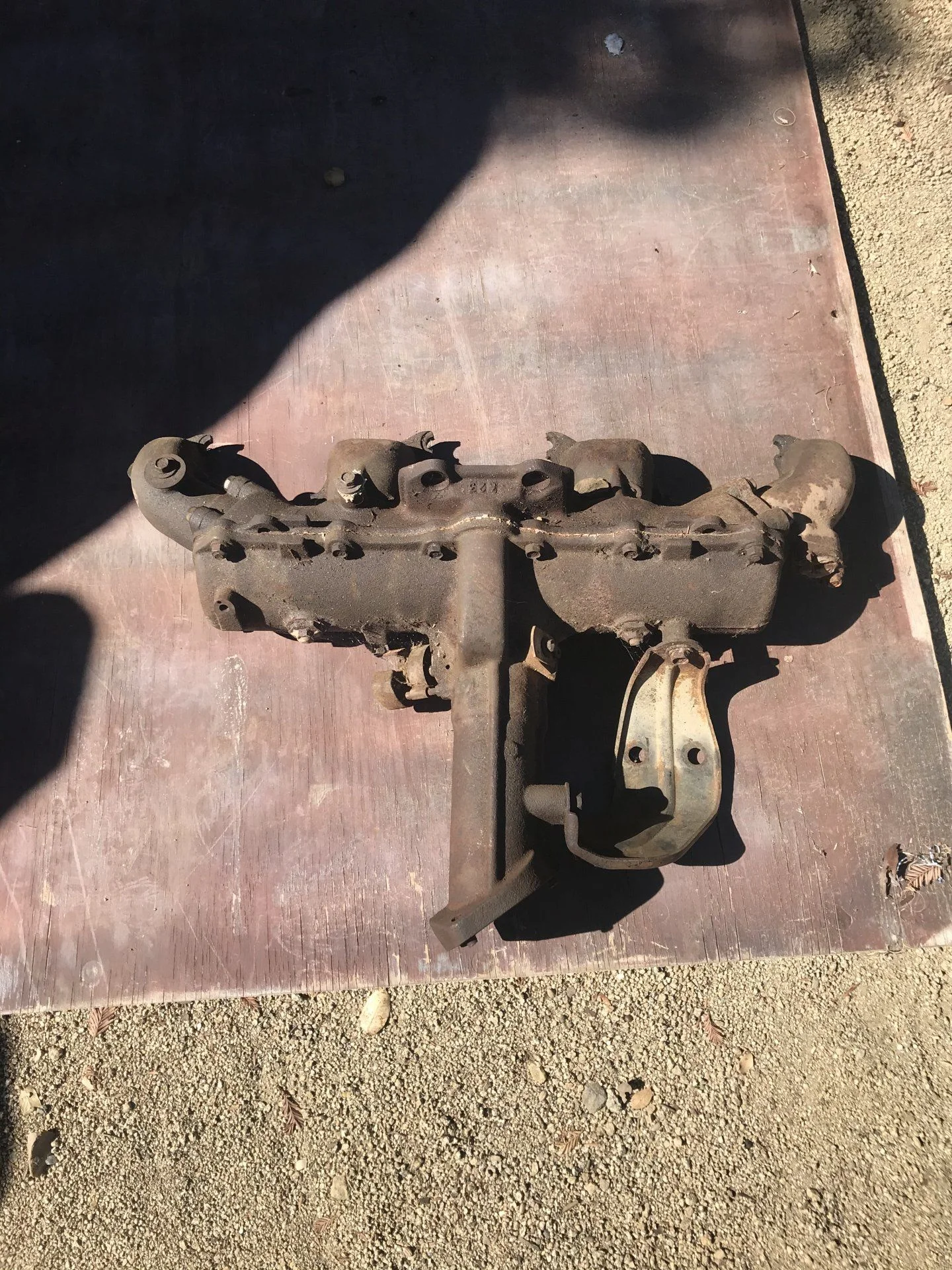

Sorry I can’t help you but is this the exhaust that you need, Just a pic for you , It might help you find one, This is on my 76

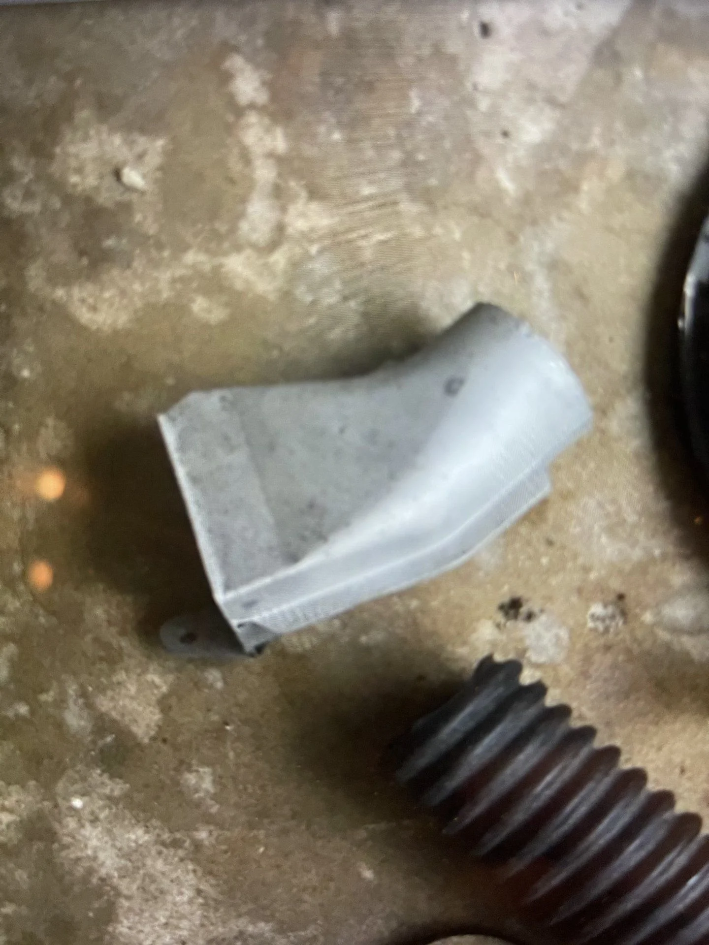

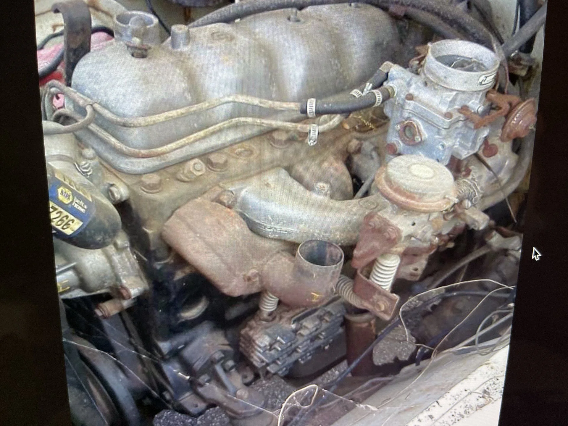

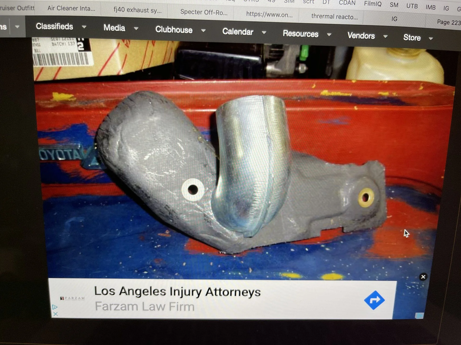

Not my rig, but photos posted by Fast Eddy years ago. In the middle picture it's the attached piece with the opening facing up where the hot air tube connects into. The last picture is one of the rig.
Funny. That last photo was mine from when I was selling a spare insulator. I bought that insulator and later on discovered that my CA exhaust manifold was cracked in so many places that I had to replace it with a Federal manifold.
There are VW heater ducts that can be used to replace the flexible warm air intake hose that connects to the part in that last photo. I'll dig out that VW part and post the number tomorrow.
No way that's your photo!! What a small world! I can find the hot air tube at SOR, it's that exhaust insulator/thermal reactor piece I have to find. Thank you spot cruiser!
I think I probably had the last new CA manifold heat riser. It had been sitting in my garage for at least 10 years. If, as you say, the flexible tube is still available, you can modify a steel Federal manifold insulator to suit the CA manifold. That's your best bet.
17167-61031 is the part number for the CA manifold insulator, if you want to try looking for it.

thanks NOT a cally rig its FEDERAL emissions parts there ?

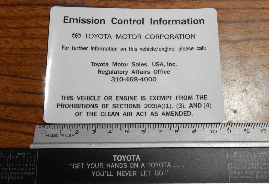

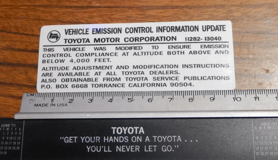

i have these going on ..............
i have had excellent feedback too
these are exact clone for a original i plucked at the dealership in college
