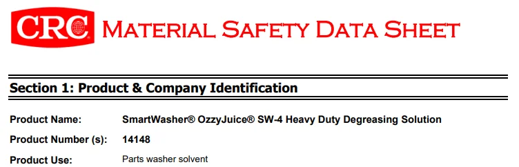

This is primarily to answer an aside from the front suspension topic it was pulled from, so as not to contaminate the OP's post topic.
So, @2001LC and I were chewing the fat about degreasers, (kudos to Paul, who happens to be the only other person I know of who believes cleaning is a maintenance step) specifically, SmartWasher® OzzyJuice® SW-4 HD Degreasing Solution. He likes it, which means it's pretty good, in my book. It is spendy, though.
The question was asked if I knew the formula for the CRC orange (priced as gold by weight) degreaser. I didn't but promised I'd ask a chemist at work. So here's the answer.
We searched (which is what we both do for a living) and there doesn't seem to be a patent or patent application for this stuff. My inital thought was it (just like every degreaser I know of) is a lye– (sodium hydroxide) based solution. The ad copy says something like:

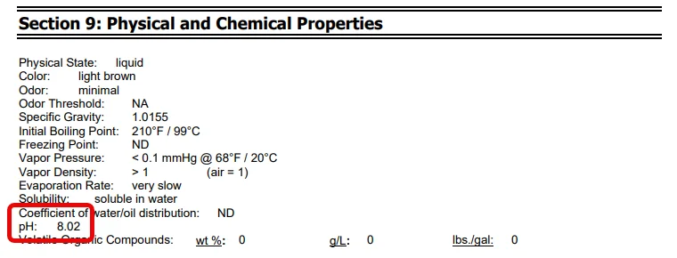

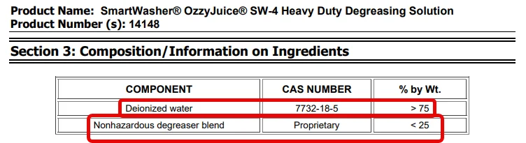

"eco–friendly, biodegradable, non–hazardous, pH–neutral, water–based" degreaser.
What this really means is that the solution is primarily water, as opposed to petroleum, and whatever is in it that actually does the degreasing, is in such small amounts that it doesn't meet the threshold limits for "hazardous". What this DOES NOT mean is that it's safe to drink (or let your favorite pet lap it up).
I'm not a chemist, but my chemist co–worker agreed with my guess that it's lye, in a very small amount, that does the work (based on the fact that it's the most common industrial degreasing agent, and thus the cheapest), along with a fair amount of soap (the surfactant in the solution), and some dye, and maybe fragrance. This is based on the information in the MSDS:
In order to have a pH of 8, (since deionized water has a pH of 7), the miniscule amount of active degreaser has to be pretty alkaline, which lye is. A bit in a gallon of pure water will raise the pH significantly. Not enough to kill you or take the hair off a dog (as my grandmother was wont to say), but still enough to decombine grease molecules, which is all that's required to make them "unsticky" (not a chemical term...).
So there you have it. Paul says it's good stuff, I can't make it, it's more expensive than ZEP purple degreaser (which I have too much of), and that's about all I know.

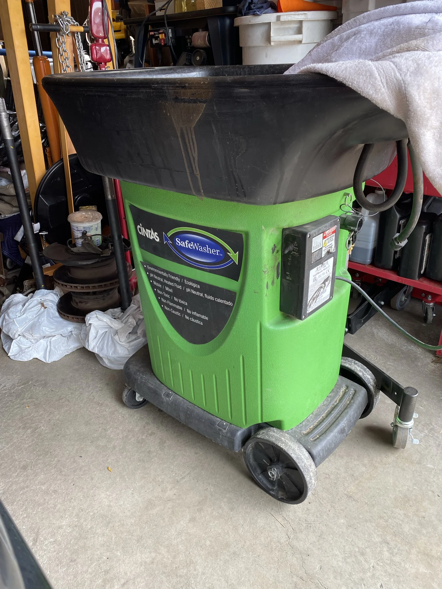

What I like, about the CRC SmartWasher systems, is: Bioremediation (eats grease).
I no longer need to worry about washing petroleum (grease & oils) into the environment, when I rinse parts with water. Nor do I need to, dispose of cleaning solutions (solvents) full of petroleum waste.
The filler matts, must be replaced every 30 days. Which are microbial-infused OzzyMat filter. Bioremediation is the use of microbes to break down and “eat” oil, grease, and carbon-based contaminants. Botechnology, is used to assist in the clean-up of wastewater treatment ponds and lagoons in petroleum refineries and industrial manufacturing facilities all around the world.
CRC offers a number of cleaning solution, for the SmartWasher (SW). SW-4, is one of the cheapest and most readily available. Sometimes I use the stronger X-1. X-1 is so strong. I must use a fan to blow away fumes, or I get nagging little cough. I understand they are reformulating the X-1, so it can be sold in states now prohibited X-1. X-1 cost ($200) is higher, than the SW-4 ($120).
Few things about the SW cleaner and cleaning solution:
  1. Not meant to be used to, soak parts in.
  2. Does not rinse off oils and grease. Greases & oils must be agitated with brush or rubbing solution washers over it (washes away).
  3. Acid approved gloves, should be used. It causes fingernails to crack when I get on them. Nitrile gloves, fall apart 1 or 2 hours later.
  4. Evaporates, so must add 5 gallon jugs, when gets low (light comes on heater goes off). So the more use, the more often must be added.
  5. What I don't like, is cost to maintain. Which is cost of filters and cleaning solution. The machines (tanks) themself are a one time costly investment.

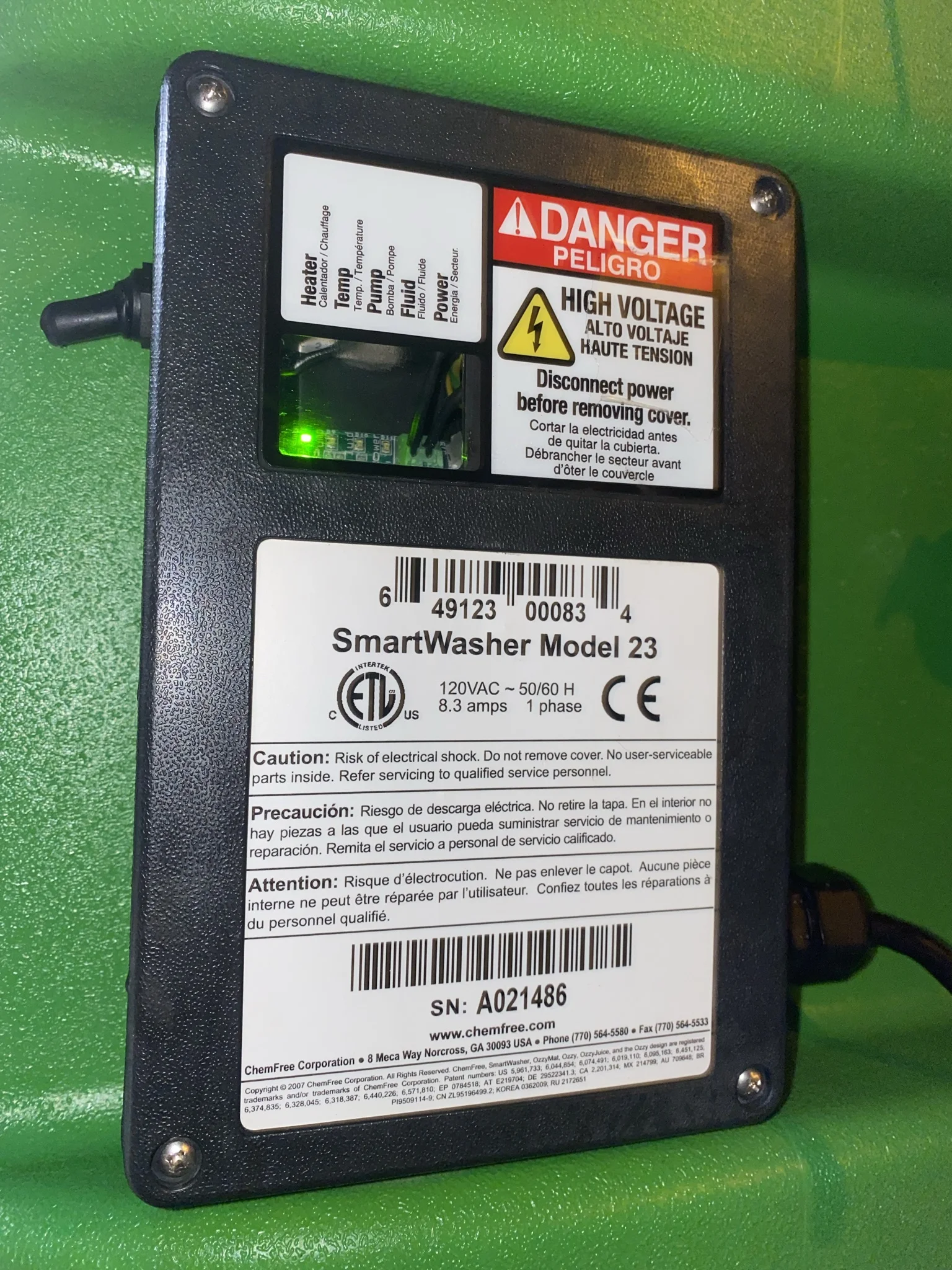

The "OzzyJuice® SW-4 HD Degreasing Solution" I only used in the CRC SmartWasher. Mine is the SmartWasher Model 23 on wheels. A 15 gallon tank with pump, nozzle & brush and fluid heater. CRC has number of larger models that hold even more solution. All except bench top model (3 gal), use same fluid and filters w/OSSY's

I'll add one thing that attracted with the SW-23. Is that it is on wheels. I found my SW-23, used on FB, for $100. I've most everything on my shop floor on wheels. Which allows me to, reconfigure my small shops as needs, on the fly.
