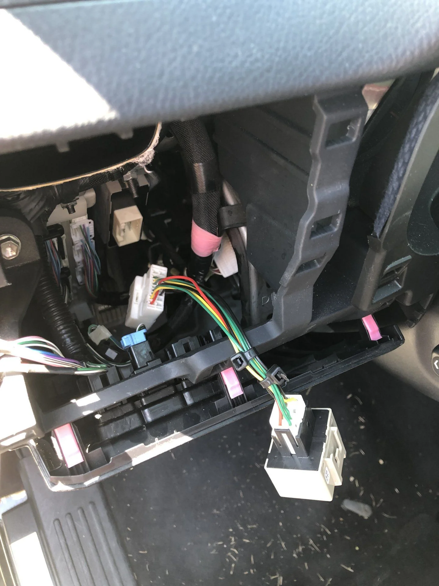

I installed the smart tap on 470 using a Toyota 12-pin to 8-pin wiring harness (82241-35010) and it works like a charm. My erroneous thinking had me believing the same procedure would work on the 460, well the connector is a different size and layout in the 460 shock surprise.
Has anyone else figured out how to get the smart tap working in a 460? And or if there is another Toyota wiring harness I could use?
For those who don’t know what a smart tap is click this link below. It is rather an epic little device.
You would have to swap between flashers if you use the electric trailer brake circuit. You will see in this thread. Lane change auto flashing mod completed - ClubLexus - Lexus Forum Discussion
There is a member there who can make an adapter but says that stupid forum won’t let him sell it. What a crock! I’m swamped with work and an 18 month old, I don’t have a whole lot of time for this sort of work which is why I like paying for someone else’s quality workmanship. :)
I sucked it up and made the adapter myself while at home “working”. It was more exciting than my work that’s for sure.
I suck at crimping but it all got put together fine and the smart tap works perfectly. I cleaned up the zip ties and then zip tie’d the harness to the wiring there to the right with the pink tape on it. (Not too tight though!) So glad the hyper flash is gone and that I have the tap+flash feature I’ve grown to love.

Quick video of it in action.
I’ll try and post a video if anyone is interested.
Do you happen to have the parts and pin out you used to make the adapter?
They've been misplaced since I moved. I've been meaning to make another harness but also keep the trailer lights working. I'll update the thread when I end up getting around to it.
