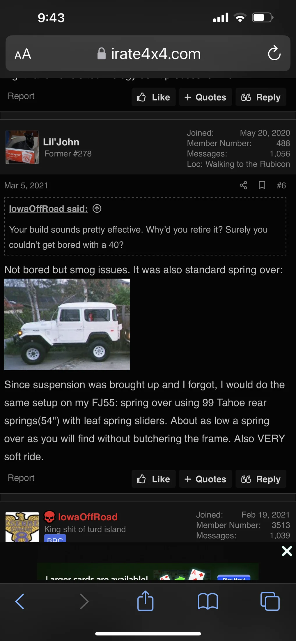

This 40 has them up front:
There is an ex-member here (got pissed off, threw a fit, deleted all of his stuff from the forum) that had them front and rear on an FJ55 with 54” springs from the rear of a 99 GM Tahoe SUV, and claimed it rode like a cadillac.
This is his truck in this thread:
Two benefits I see to them:
1. Lower ride height
2. Protect from bending a leaf spring by bashing it into
Downside I see:
Less flex due to limiting range of motion and less leverage on bushings.
