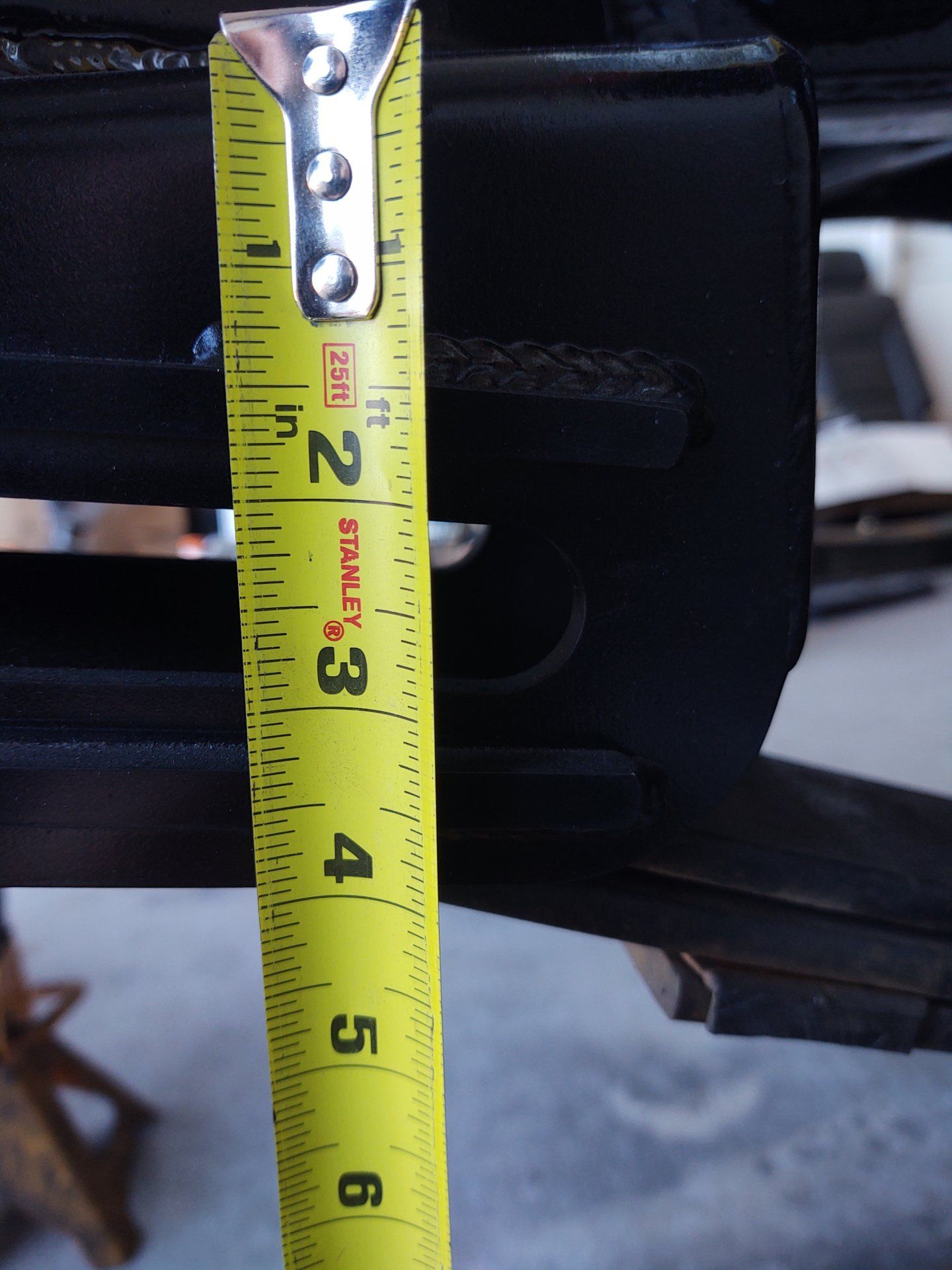

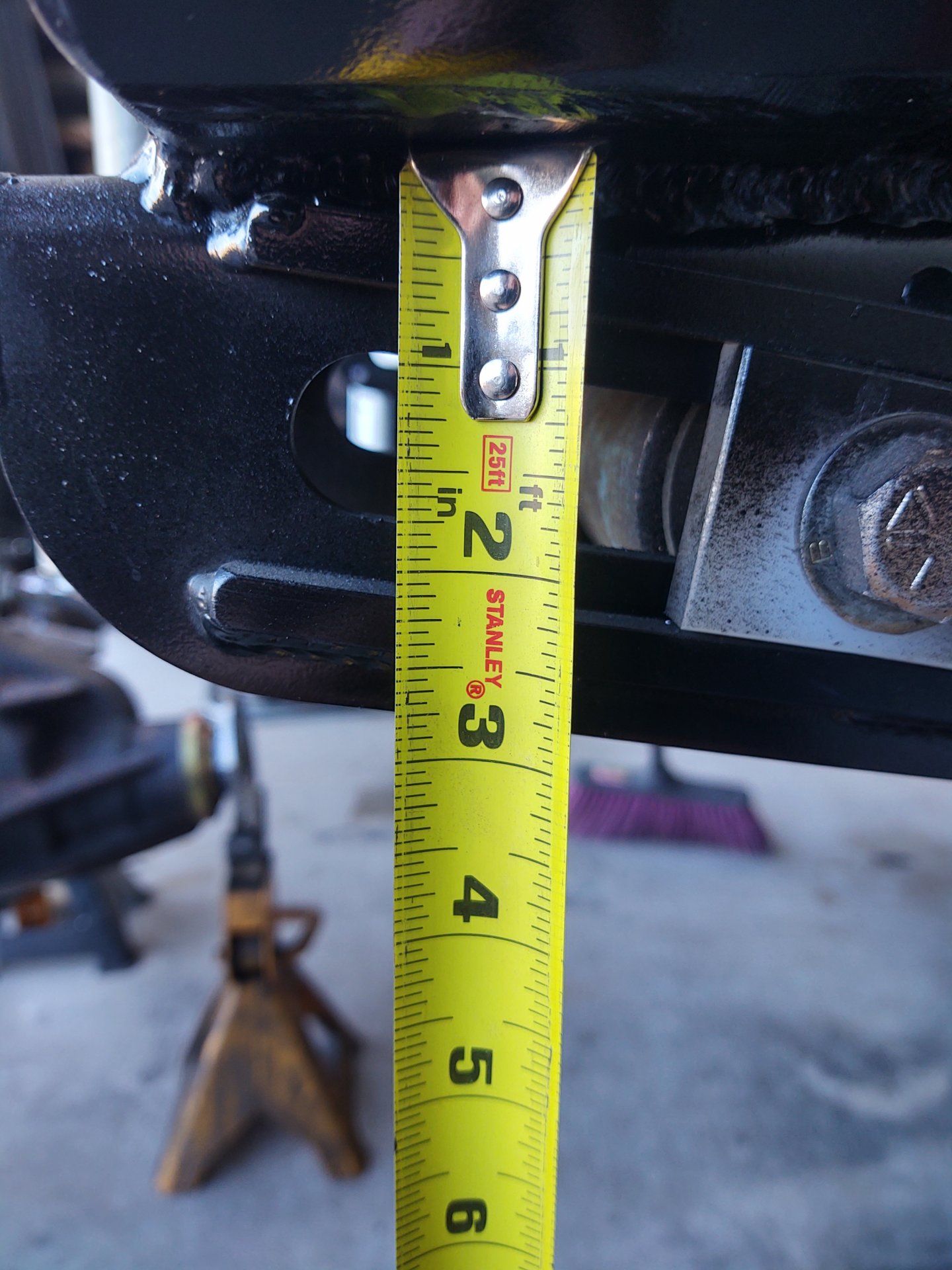

I have 1.25 inches at the front, and 2.25 inches at the back. I had to notch the frame to get the tie rod in on the driver's sideCould you help with a measurement on your leaf spring sliders? See picture for details. I'm hoping to see if I would have enough clearance between my frame and my tie rod with this modification since it will lower the ride height.
