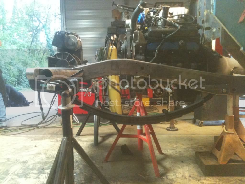

din't get the idea until saw this pic ..
Pic borrow from the same pirate thread ..
Looking forward to see real trail experience with those . .
