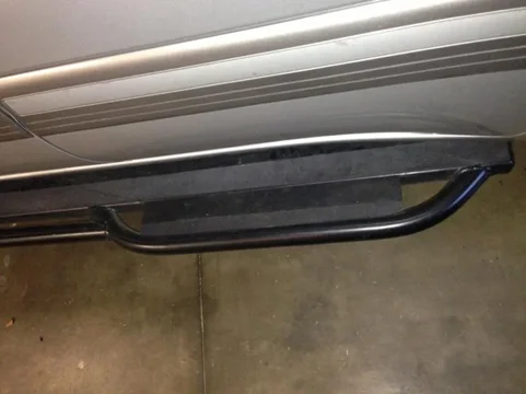

The step out at the rear of the slider makes for an overall very wide stance. Although it's helpful to kick out the rear and save the quarter panel in off-road situations, it adds 2 inches to each side and makes for a wide stance And narrow trails extremely difficult.
I added a plate for the rear open area as my four-year-old daughter fell into the opening twice. It makes for a dangerous situation if you have youngsters.

Thanks 1meancruiser. The wide kick out in the rear concerned me for the exact reason you mentioned. My kiddos are a little older, but nonetheless do not want busted shins to deal with. Can you share how you installed the plates? Photos would be helpful if you don't mind.

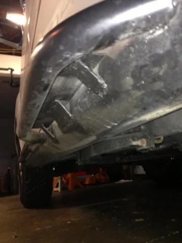

My daughter's foot slipped through the Gap once, and she started falling backwards but I managed to catch her. The second episode prompted me to install these. Not a criticism of MT's. Great sliders overall. Any slider with a kick out with have this problem.
The weight is supported by the plate itself, the tabs I welded on from underneath act to hold the plate in place. The weld is not such a great job as it was one of my first welds. Topped off with some bedliner spray.
I forgot to mention, you should just ask metal tech to install the steps for you. It's just an additional plate and I'm sure it'll be a nominal charge...
