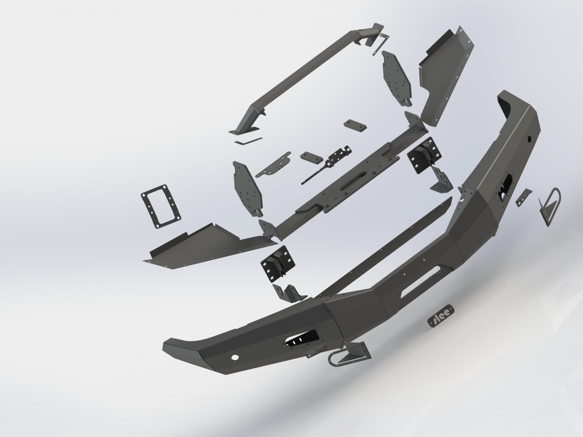

Any pics of internal bracing you can share?
I don't have a photo from behind but here is an exploded diagram of all the pieces
