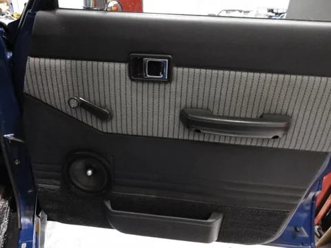

I was able to fit regular depth Polks, plus a foam insulator to keep water and dirt off the magnet, by surface mounting on the interior panel. It is necessary to put spacers (3/8" IIRC) between the panel and door structure to keep the panel from collapsing.
It does expose the imprint of the stock grill on the panel (just like 90% of the 60's still on the road). The install is reversible with only a few new holes that the old grill would cover completely.

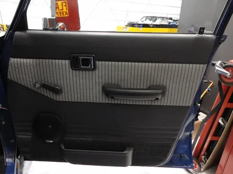

I used Polk 5.25 in both front (no clearance issues) and back so that you can reuse the stock speaker grills. The screw holes didn't all line up but enough did to make it work. I then put a sub under the seat round out the system. I also use a Bluetooth cassette tape to keep the stock head unit and play music through my phone, I even have Bluetooth controls on steering wheel.
I wanted it to all appear stock but upgraded sound, worked out well.

I installed Pioneer TS-G1320S speakers. Installation involves drilling 4 holes to put the included screws. If you just mount them up like that, they will rub the window but the window will go down just fine. I didn't want rattles or scratches on the window, so I made a donut spacer with 1/4 foam from an extra pair of kneepads. Then I used nylon nuts (I think that's the size) to space out the speaker where the screws go. Wiring, you will need to crimp on a couple male quick disconnects to the speaker wires, which will easily connect to the factory wiring harness in the door.
