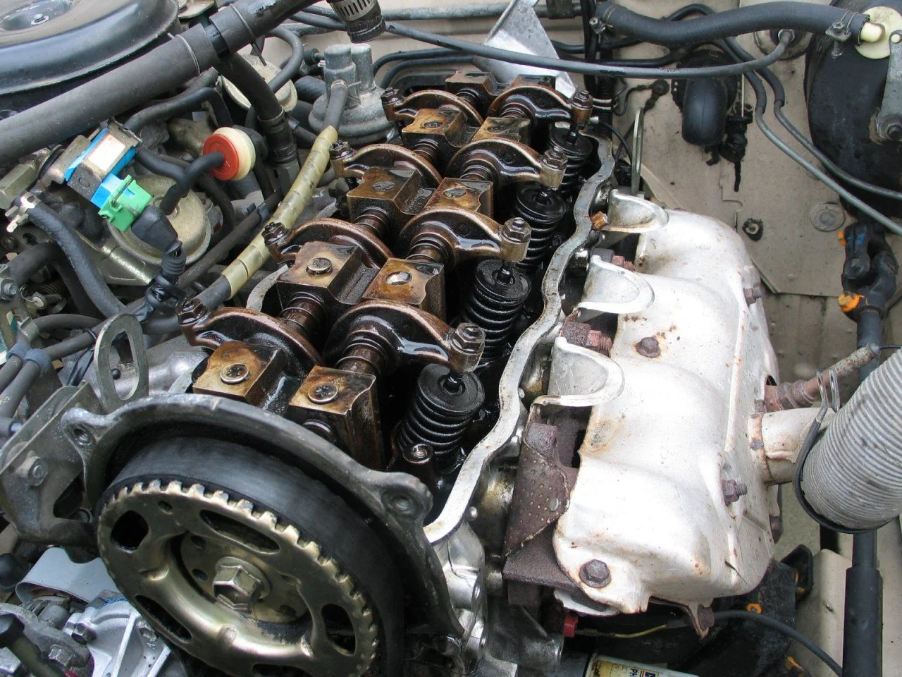

Head pic: missing on bugle head screw and 3 of the front 4 remaining were loose.
Bearing- well spun but present, unlike the one in the 2002 Corolla I took apart earlier today. Spunday Monday..
I'm thinking the oil puked out the valve rocker tube, pressure dropped and the CR #3 lost oil flow. Cylinder wall condition TBD. Motor had a bunch of oil all over including around the timing belt. I think the rings are toast in #3, resulting in blow by, blowing out oil etc, rod knock was obvious. Next, pull the head..
OK- so the cylinders are a bit shiny, not much of a ring ridge, no scoring and a burnt valve on #3. Head gasket looked kind of rotten but aside from chunks of metal in the pan there was very little water. I did notice steam when I popped the pan and some slime in the front timing cover which was oil-soaked and the belt looked like it had wandered around, rubbing on the cover down low. Do the timing gears get worn?
I guess I'm used to machined not stamped gears.. I think that is what it is. I got TK's old block, the crank looks good. I might do some measuring or take the block to a machinist to see if I can get away with a re-ring.. Guy called with a "rebuilt" motor for $275 via my Cl ad.. I'm not sure what the official definition of rebuild is but that isn't a bad price seeing as gasket/ring/bearing kits aren't far from that..
