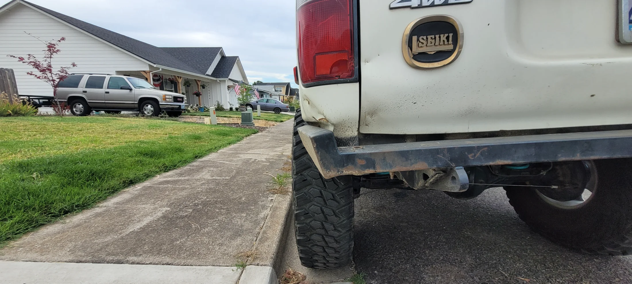

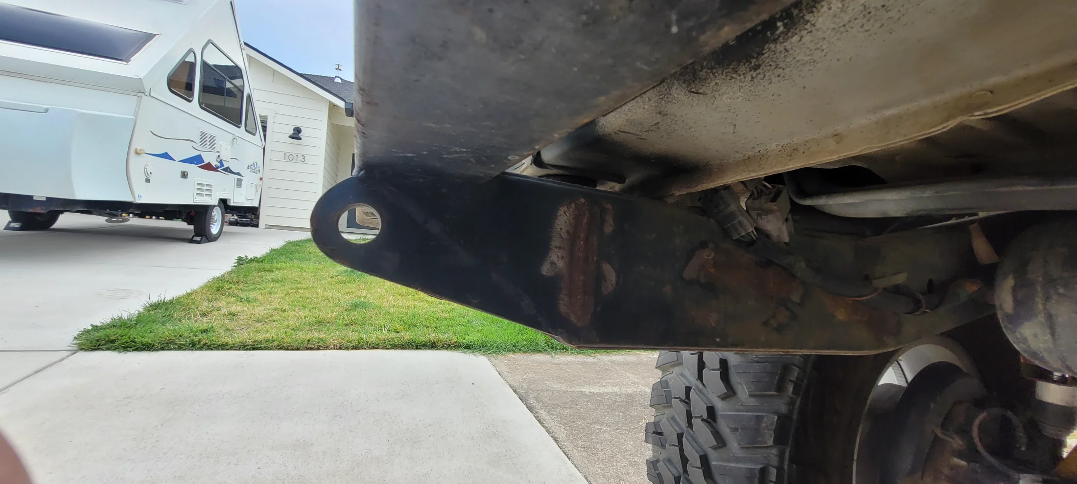

Rear bumper, same tubing. Shortened frame, added recovery points.

Very cool truck!! I love that simple rear bumper!!!
And not often you see the rocker cut sliders outside of Jeep land. Very cool.
Rocker chops are definitely not as common here, it's a bunch of work and the gains are worth it. I do wish I would have body mounted the slider after all the work, but no regrets!
I'm also surprised how well the bumper has held up. Granted I'm not as hard on it as I use to be, but I do still need to tie the wings into the frame some day.
If you could take more pics of that bumper I’d appreciate it. I want something simple like that. Are the quarter panels cut?
