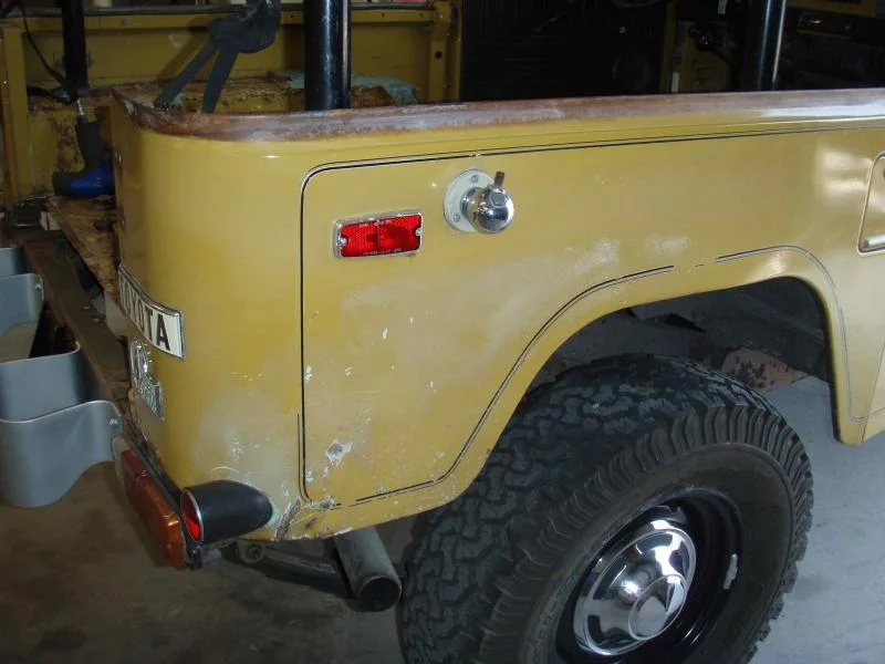

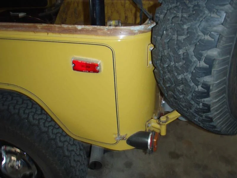

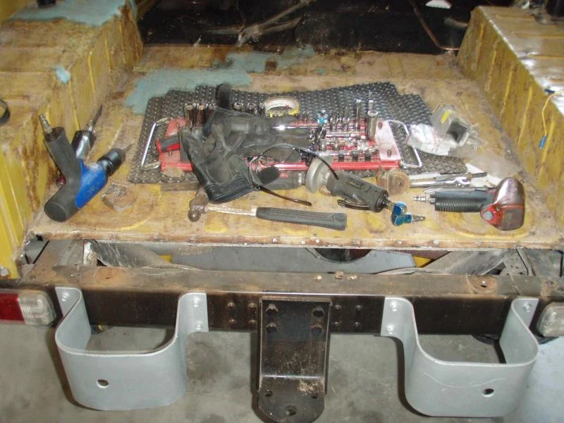

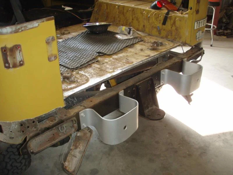

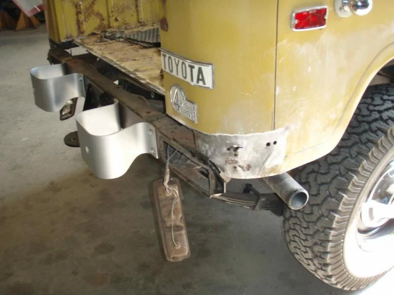

Since there are two 40's undergoing similar body work I thought I'd start Sill Wars. Today was the initial day of metal work at Colvin's and here are the initial photos. My scope of work is rear sill replacement, quarter panels and bed up to the rear heater. THe front carpet is staying but I have pulled the seats with mounts, rear heater and anything else such as the console to keep me busy while the pros work. We will see how the rattle cans look next to the finished product.:hhmm:
I will try to post regularly through the process.:wrench:
End of the day today
Here she was this afternoon

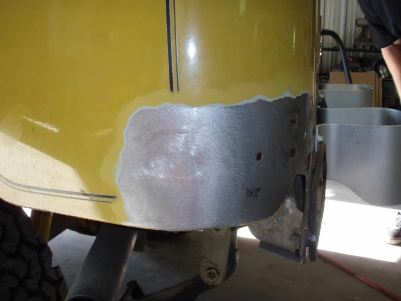

Lee, I think my panels are fine. The only rust other than what was cut out was where there are now holes in the second picture of the second post. Passenger side had damage and bondo from the PO, picture is not too revealing because it was so bright out today. Basically they drilled through the panel where the rust was and will weld it up and grind it out. As far as the old dent they were able to hammer and dolly it out and it looks amazingly straight, wish I could do this stuff.
It will be slow process though, don't expect the sill for a week. Just thought it would be cool to compare the process for two rigs at roughly the same time.

After seeing your initial photos I met with Mike and Phil and we decided to purchase the sill from CCOT. The initial plan was to fab the sill cover and leave the structual part of the sill in place but I was more comfortable in buying the part and dropping it in. Now that they are into the project and can see what they have I think they agree.
My sill will come next week and so I'm guessing mid-June as well. I will try to shoot some picks of the interior parts I'm working on in the garage. We will have to plan to get the two together when they are done.:beer:

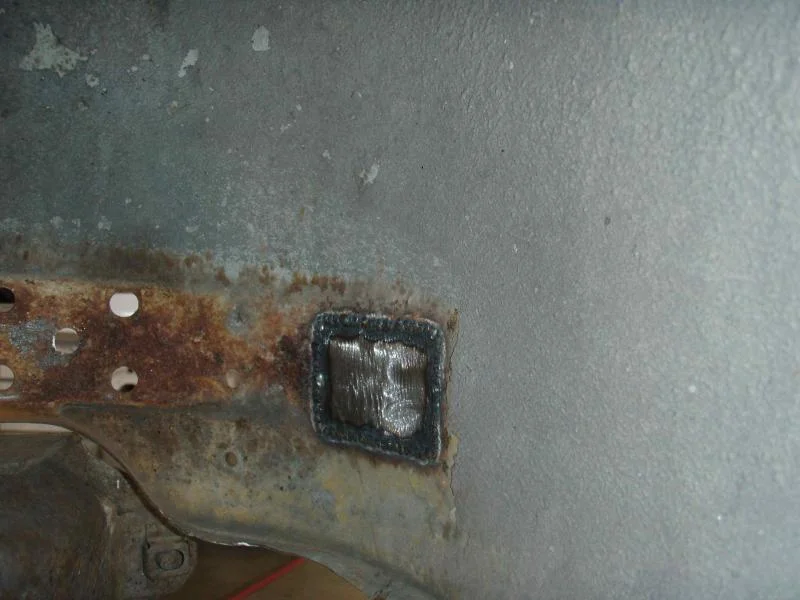

Here is the driverside panel where I had a rust hole all the way through. New 16ga. welded in and ground out. Underside shows the patch in place.:cool:
The cover panels have ben fabricated so now I'm waiting on the sill. Also the body mounts were shot so I ordered a kit tonight so I will have all the mounts needed for the whole truck when it comes time for the rest of the story.

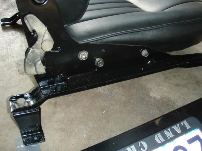

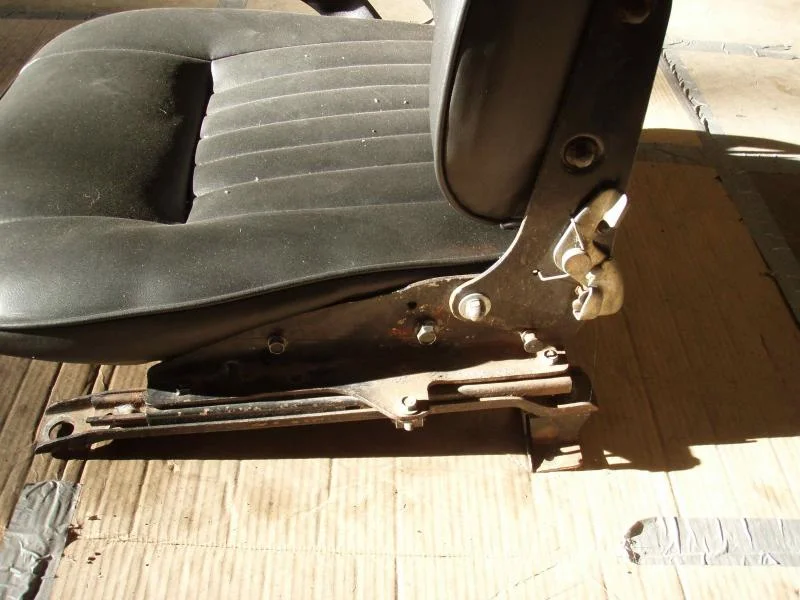

Here are a couple of shots of the seat hardware before and after a lot of wire wheel, sandpaper, navel jelly, priming and painting. Console was disassembled and run through the mill as well.
Still have rear heater to rebuild and gas filler and evaporator covers to clean up and paint as well. Hope to get this knocked out this weekend.:beer:

You're a man on fire.:D :cheers:
I need to do the same treatment to my seat brackets. Maybe your pics will be the inspiration I need to get started.

It just seemed like the time to do this, plus there is a big hole in the garage so I thought I would take advantage of the workspace.
