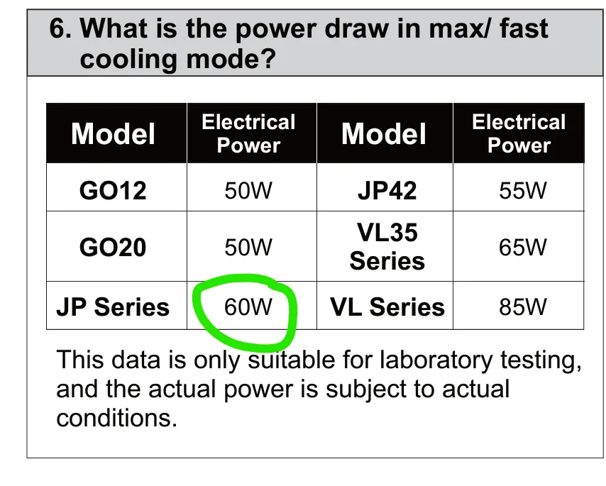

The fridge I'm planning on using can be seen here. I've been seeing different ways power consumption is measured which makes this more confusing to calculate. I have yet to chose a power station but it will likely be pretty small due to my basic needs and space limitations. I've ordered this battery monitor so I can keep a closer eye on things. My starter battery is pushing 7 years old, I'm planning on making the jump to lithium once my current one is done.
Looks like 60W max. I bet typical draw is ~40W. That's what we see with the Dometic CD30. Similar compressor.

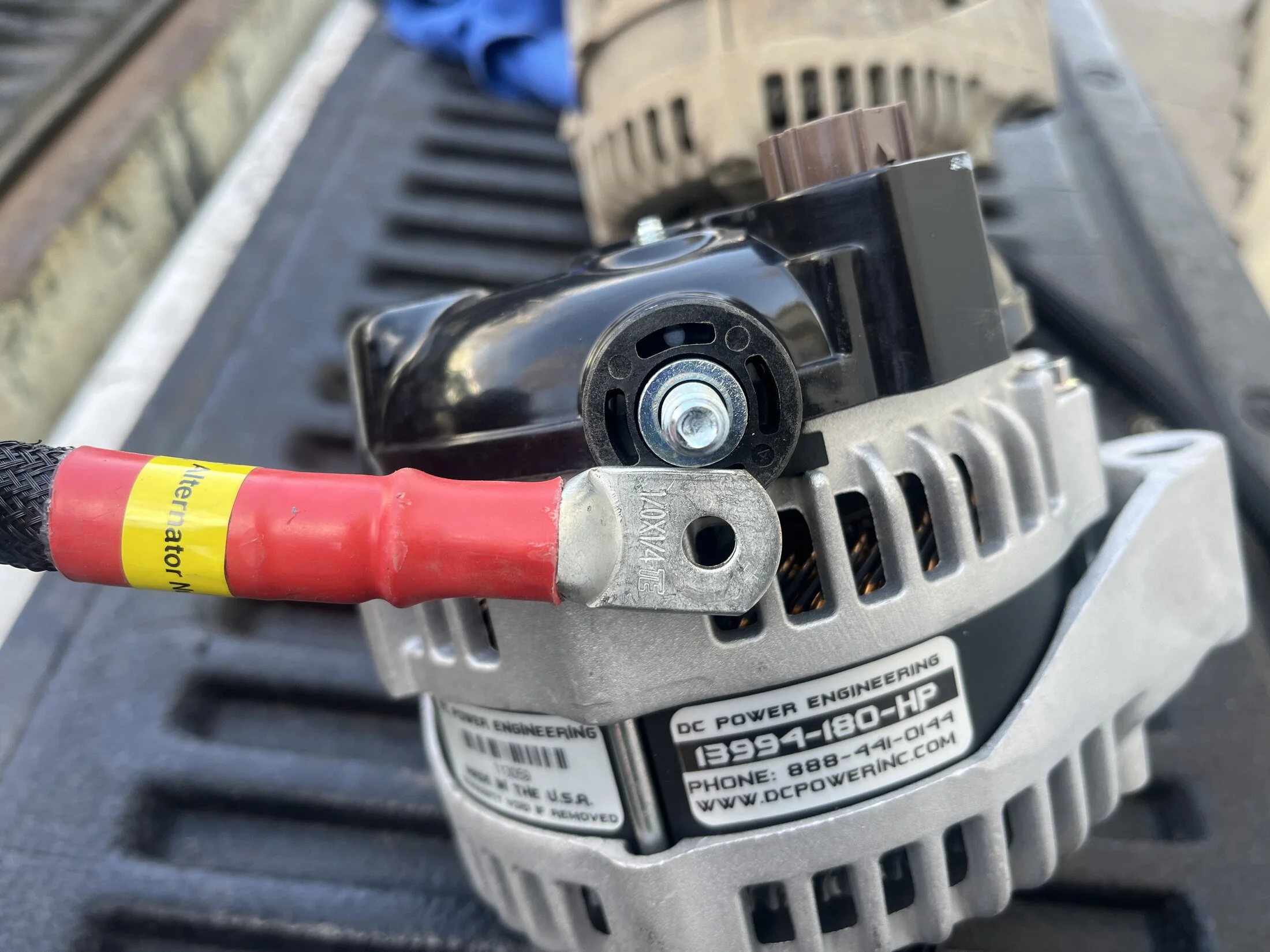

I got the DC Power 180a alternator in. The stud on the alternator is larger than factory at 8mm so I had to drill out the charge cable to 5/16" to fit.
