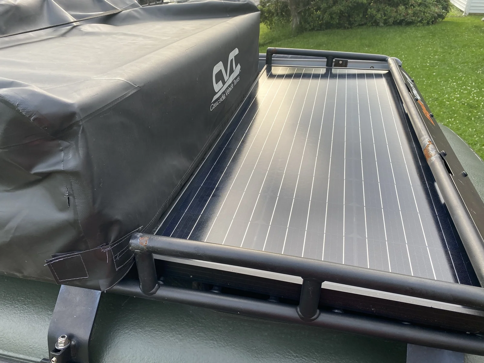

I went down the solar panel road about 4 years ago. Glad I did. Here’s a picture of my current setup topside.

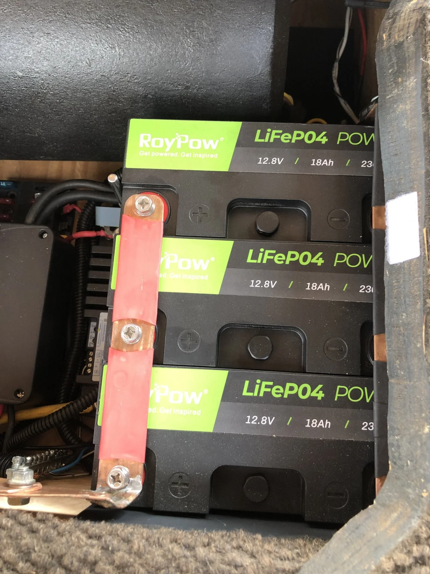

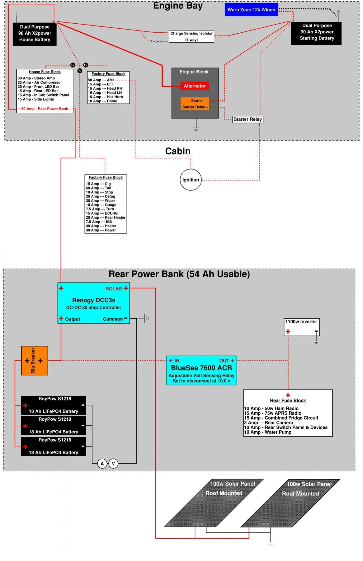

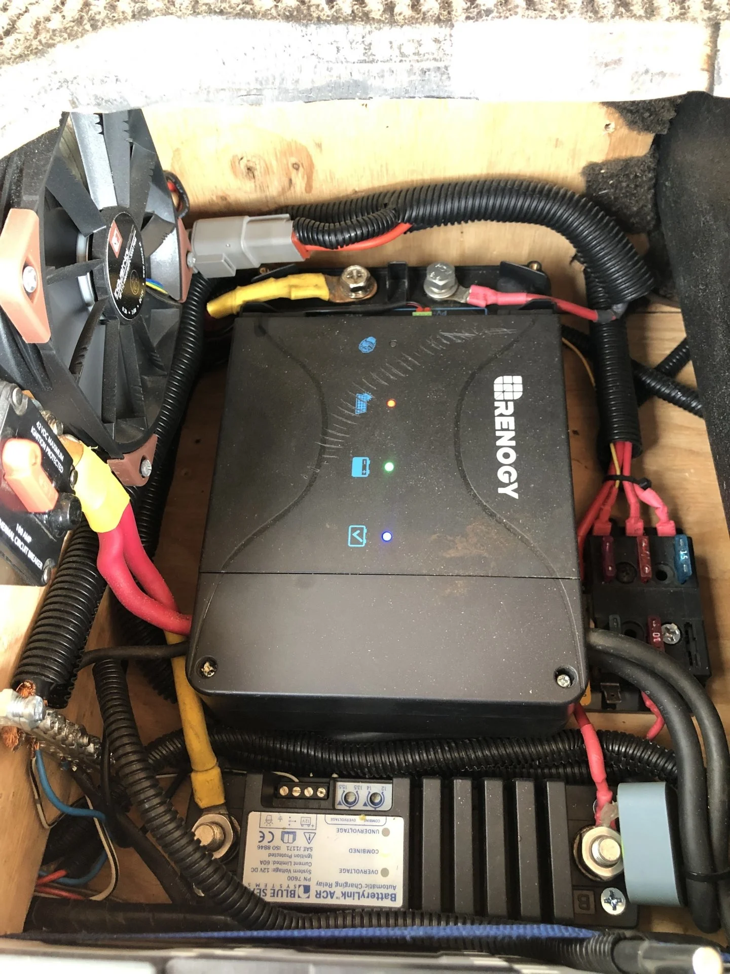

Here is my setup
battery-layout-li-ion-jpg.2685369

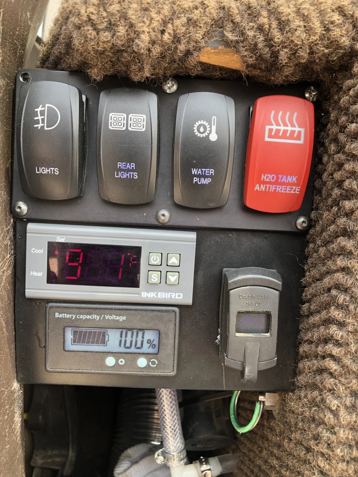

no it's not broken, the refresh rate of the HVAC controller was messing with the camera.
I love having my panels hard mounted on the roof, they just work all the time. Not concerned about the loss of storage or "parking in the shade" because most of my long trips are in the desert where there is no shade. Also, the panels provide some shade for the vehicle anyway. Another pro for hard mounting is that you never have to worry about dicking with setting up and babysitting a solar panel & extension cord. The angle of the sun in relation to the panel argument is scientifically valid however in the real world it's never been an issue for me, even when I only had one panel.
This setup easily provides enough to run two fridge/freezers at full tilt and still has enough left over to charge up the front house and starting batteries.
More info can be found here: Multi-Battery System

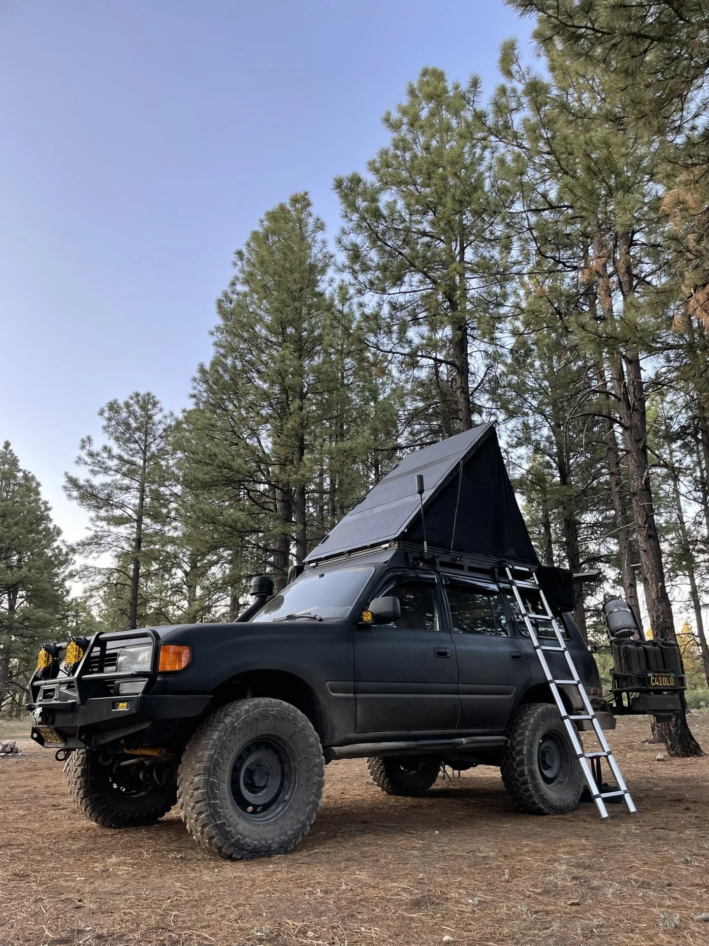

In the way I use my truck and it’s setup, the portable fold out panel I have rarely gets used. Only if we are setup and staying in one place at camp for more than 1 day, and do not leave the camp area does the portable panel help out to optimize or double my wattage due to the tent roof panel being either in the shade or at an angle where it doesn’t see the sun.
My permanent setup is great in that it is constantly connected and charging, assuming the batteries are not already at 100%. This is more of a day to day use of the solar where it is a trickle charger for your batteries. Our trucks like most cars have a parasitic drain to them and having solar always keeps the battery 100%. The panel is also secure if you leave your vehicle either in a parking lot, driveway, trailhead, camp and you have sunshine, your batteries will get charge, albeit not a perfect optimum angles. Solbian, Merlin, and Sunflare I know have very efficient panels that can grab wattage even at very low sun angles.
Of course, everybody’s setup and needs are different.

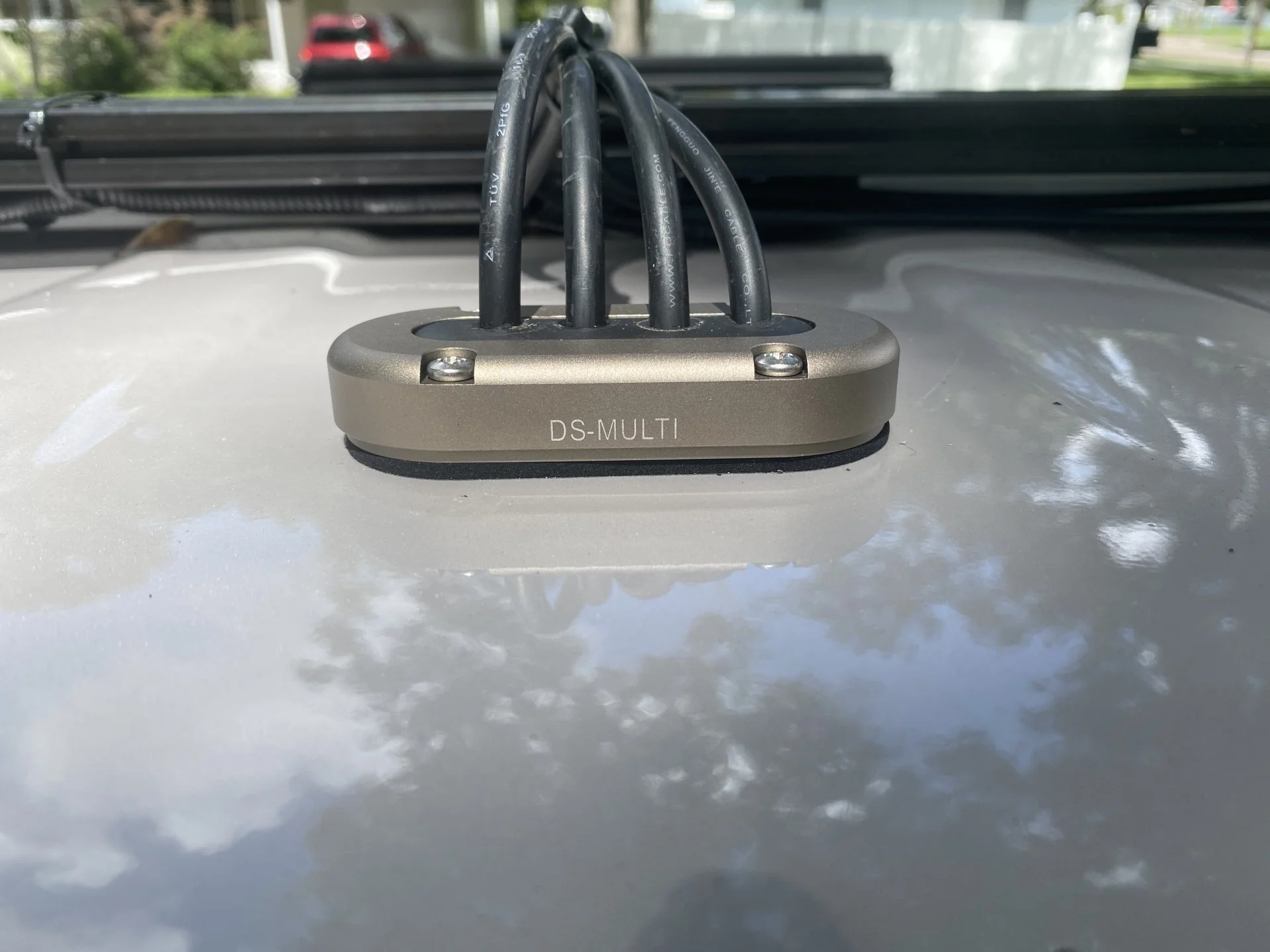

How are people running wires into your cabins? Is there a way to do it without drilling through the body?
I used this. Just did it. Scanstrut.

I went through your solar thread. Great work.
How do you like the RowPow batteries? I use an Odyssey 2150 but would like to move to the RowPow or similar. I wonder if they could be mounted in the right rear quarter.
I’m going to be adding drawers soon so I’m trying to keep the space clear.
