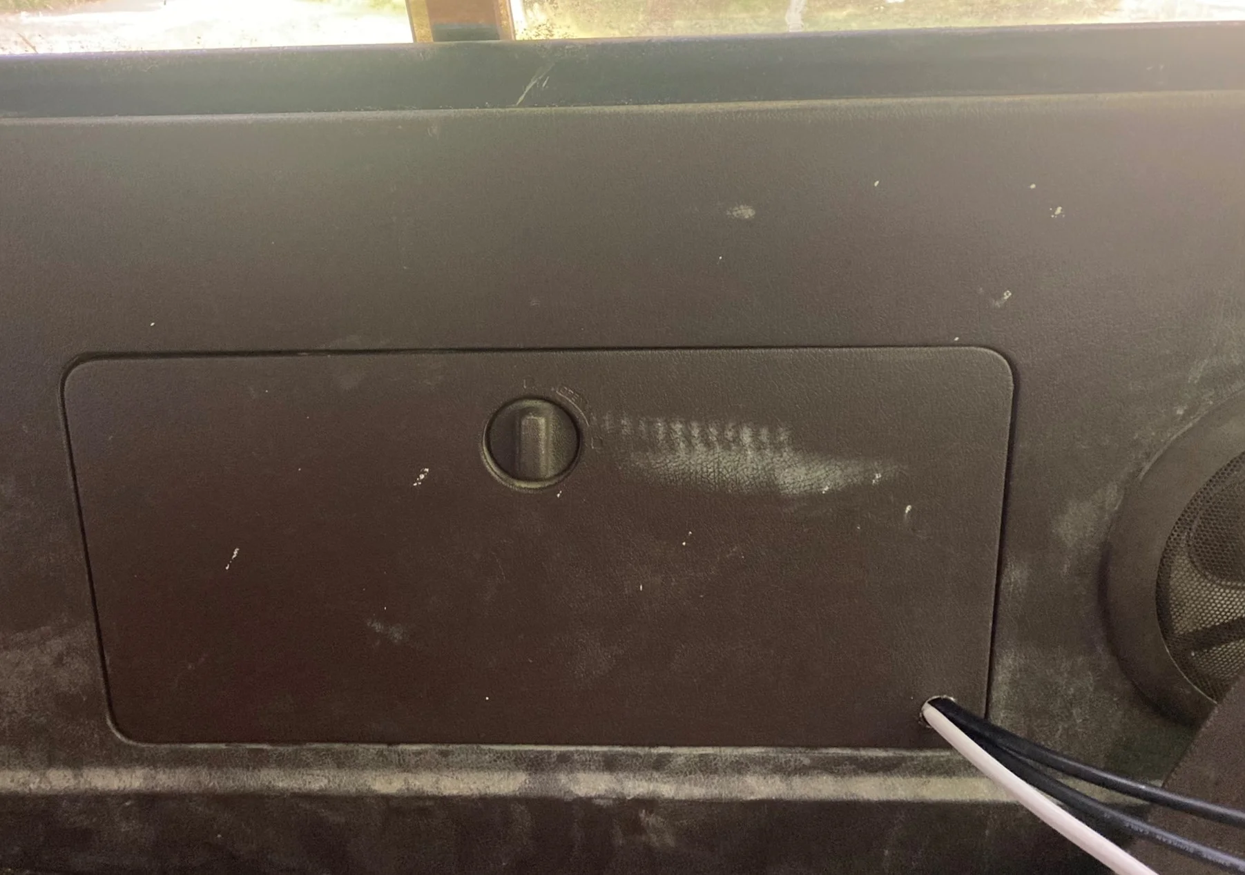

How are people running wires into your cabins? Is there a way to do it without drilling through the body?
In Australia most people are running wires down the inside of the snorkel, then exit into the engine bay.
But I guess if you don't have a snorkel yet you are still drilling holes though the body :)
Slider window in the back. Since I don’t have a permanent mounting Ii added extra gasket to the window with a gap for the cable. Then a small 1/2“ wood dowel (scrap material I had) in the interior pushing between the frame and window can keep the sliding window closed. No water seems to come in either after a couple years of use like that.
Can you post a photo of this?
Thanks, wasn't sure how the added gasket would work, but makes sense now with the photo. Thanks for posting that .

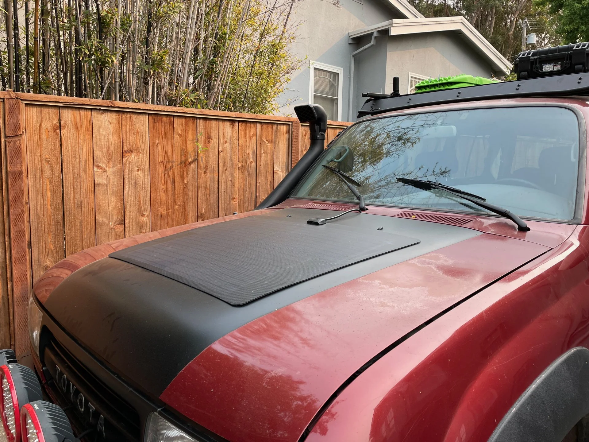

They are not giving those babies away. But looks super clean. Site says 80W. Have you tested it?
Haha...so they didn't have the 80 series model in stock and instead sent me the 90w for the tundra, dimensions fit just fine. I had been looking at the cascadia4x4 and looked about the same for a lower price.
Its hooked up to my single starter battery, dont have a sophisticated 12v setup yet, so kinda using it as a trickle charger for now. Need to do some tests to run my small fridge and see how it holds up.
I’ve monitored temps for a few weeks. With just my panel in and nothing else I never got over 89 degrees. Not bad. Desert dune keeps the quarter panel cooler.

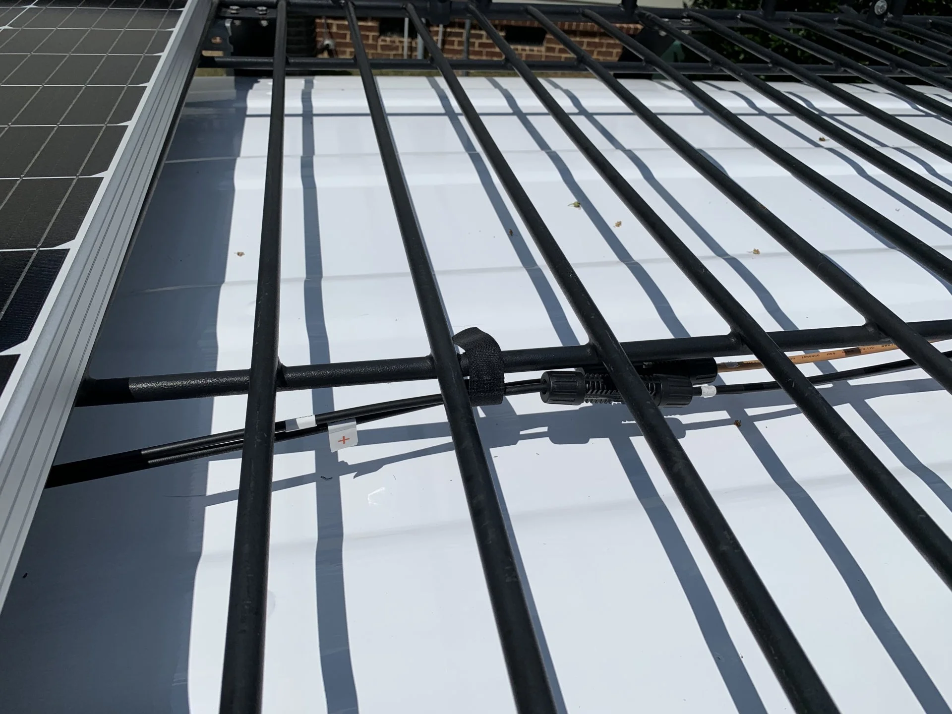

  • Cables from roof rack rigid panel through sliding window and connect to Jackery to keep it charged

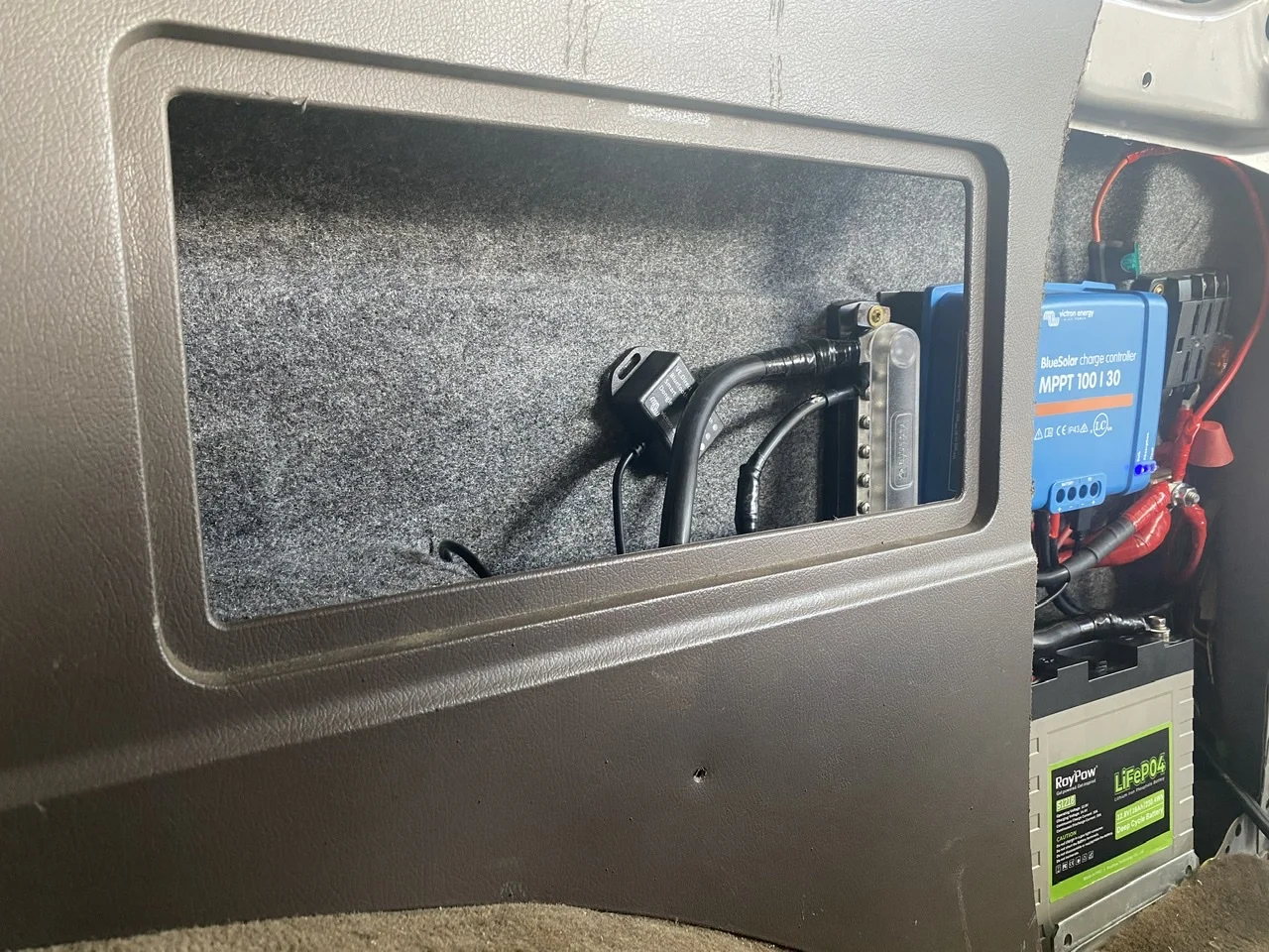

@yotarunner do you have details or added photos how it's connected to your battery? Solar->charge controller->battery terminals
Can you give me the name of the controller? I'm new to this but I like how simple your solution is.

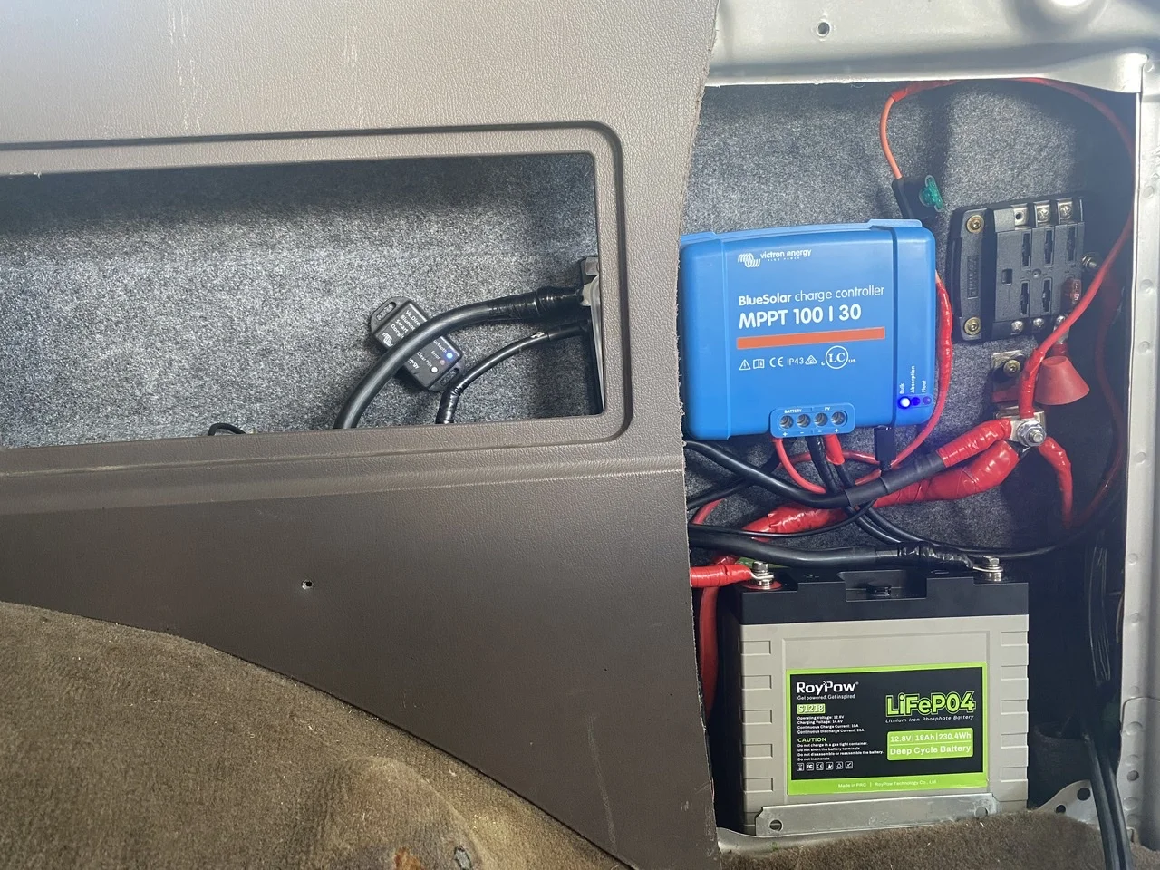

I added a simple 100w panel with a controller to my main battery. It works really well so I can run my fridge while on camping trips, but I may end up doing a dual batt setup as well. I ran a large 4 wire cable up my snorkel to have wiring for my roof lights also.

Just how its holding up to to being on the hood. With the heat, sun, and snow. As well as is it hitting the efficiency.
The panel is definitely solid on the hood with the 3m vhb, I dont think its going anywhere and I think the vinyl I put down before helps with adhesion. I'm in the Bay Area so not super hot lately and no snow lol. We had a ton of rain in December and early January and panel looks good to me. I haven't been watching the efficiency honestly, I ended up mounting the MPPT controller on top of the cruise control module so I can peak at it, but I need to get out and get some direct sun on the panel. More to come as I get out there and use it. Hope that helps! Sorry I don't have more info.

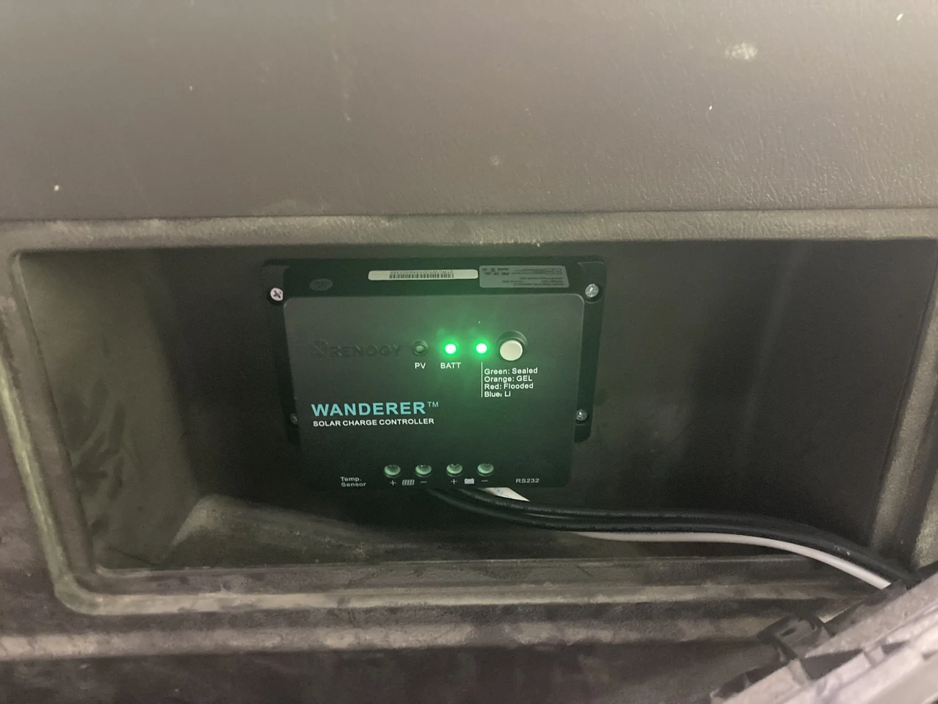

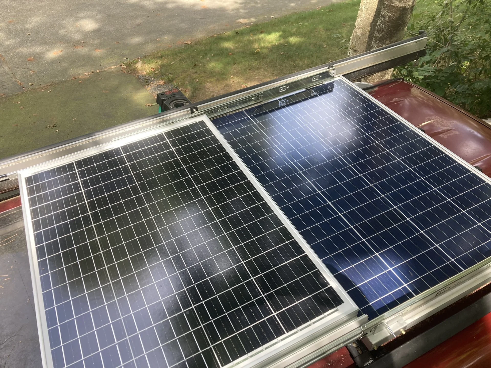

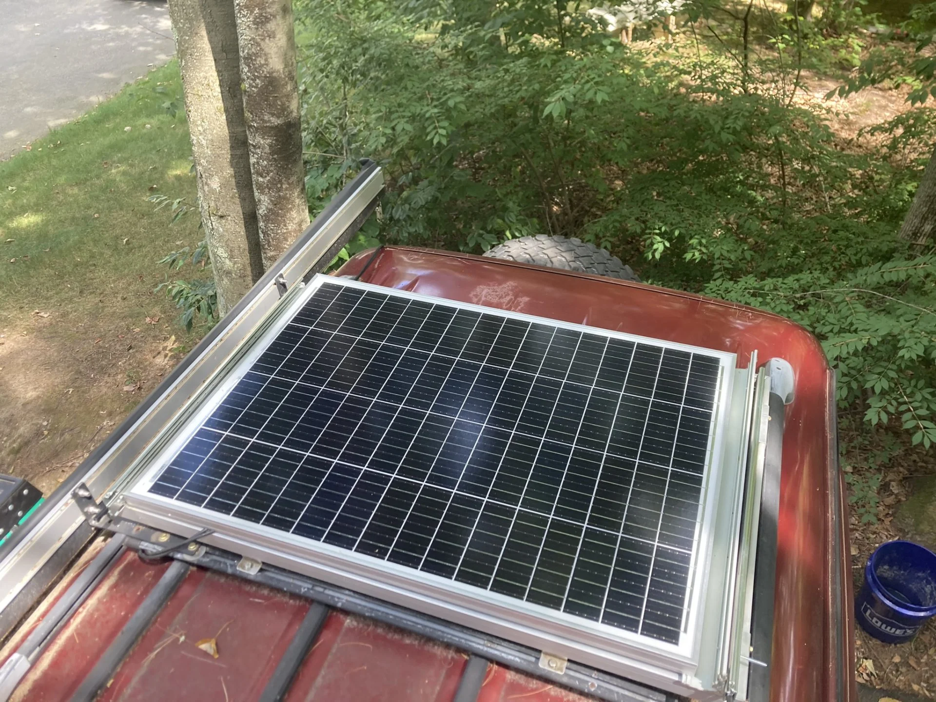

Just added a slide out panel to my setup and upgraded / relocated my charge controller (Renogy 30A Wanderer).

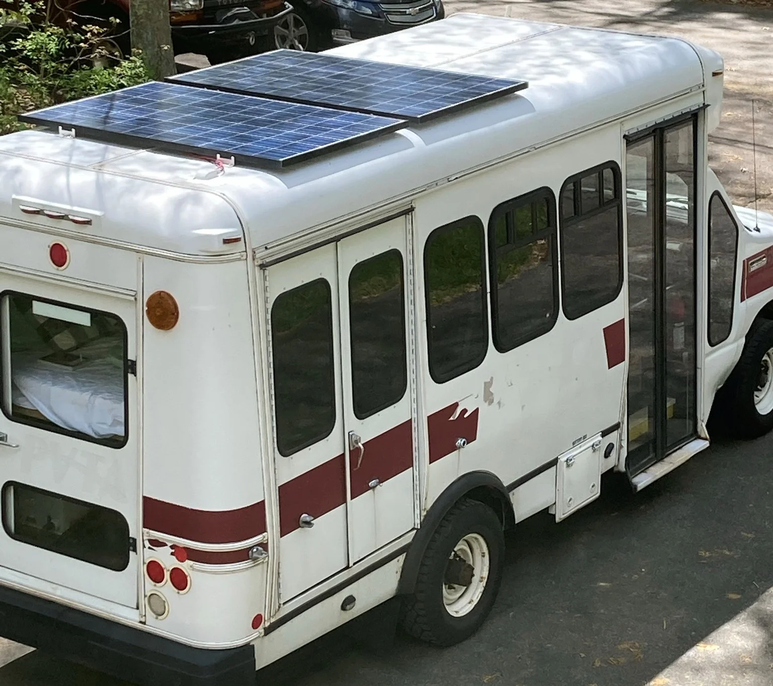

I plan to do a similar install on my skoolie (last picture). Currently have 500W on the roof and would like to double that by adding sliding panels.
