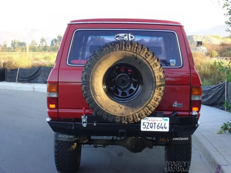

Here is mine.
I have thought about putting a TRD sticker on my truck and I always think; naw it will look stupid. Seening it on your truck Micah is makig me rethink it. It looks really good on yours.

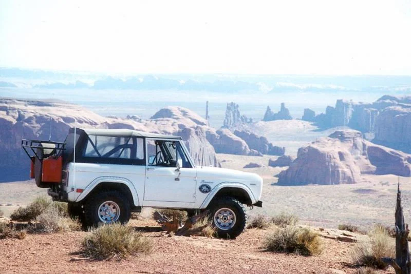

I personally like the centered tire look, so I went with the Slee rear bumper. I'm not worried about the inability to carry extra fuel with this set up because I'm doing a long range tank. If I ever did want to carry a couple of cans for fuel or water, I'd have something built where I can carry a can on each side of the spare like the Bronco pictured.

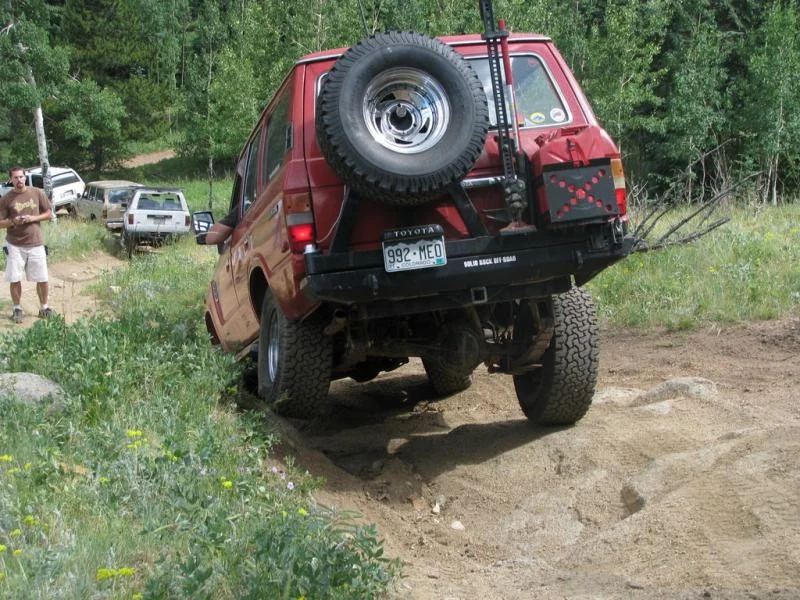

I've found that opening the latch and pulling the safety "lock-out" pin doesn't impede access to the cargo area. In my opinion, the benefits far outweigh the additional 5 seconds it takes to get into the back. It would be nice to have those dampers like the 4x4 Labs bumpers though.:cool:

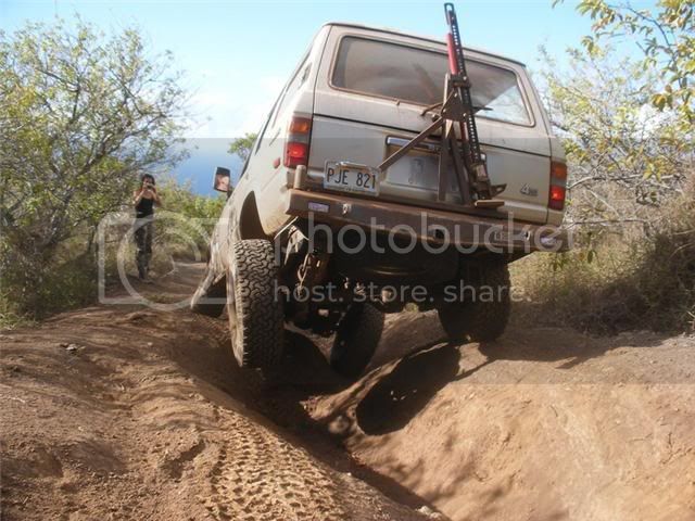

I wouldn't do a full length swingout but not for any of the reasons stated above. It can be a real PITA trying to get a full length carrier open on the trail. Trees, rocks, etc... And it is always at an inopportune moment, like trying to get a strap out when you are wedged in between some rocks. I prefer a DS mount as for a LHD vehicle it provides less of a blind spot. However with a Cherokee you are narrower so centering it and running a full length swing out might not be that big of deal.
Thats one of the designs i was also considering. Centered with one can on each side. But if i could mount the tire to one side and squeeze 3 Sceptor cans on the other that would be preferred.

I plan to order the spindle through www.4x4labs.com as they are the only place i see a 3500# rating on it. This is espescially true if i opt for the single swingaway option.

you're going to get alot of torque and bounce from the tire if you hang it out to far past the swing arm.
i would go huge on the spindle. IPOR would be and is my choice of spindles these days.

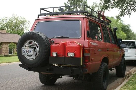

Here is a picture of my Kaymar rear bumper with the standard, right-hand tire mount, and a custom three can holder. The fuel can mount started out as a standard single can holder. MAF had it modified by removing the original can mount, and adding a new basket sized for 3 cans. I can mount the lisence plate on the back, but I typically don't have the can mount on when I am running around.
I find that the spare tire mount and the gan holder make towing my boat a little tight. I usually remove the jerry can mount for towing to give me a little more room. If you did a center mount tire behind three jerry cans, you may impact trailering, significantly (I wouldn't be able to trailer my boat at all.

The two-tire carries are different then the normal one-sided unit. They position the wheels further to the outside. I talked to MAF about this when I was first working out what I wanted to do. They do not normally import them, but they were happy to do so on special request.
Here is a picture of the 80 series dual: Kaymar 4WD Accessories
When we were on expedition in Baja, I had one full size spare in the stock location and one on the Kaymar. Plus the three fuel cans. A perfect solution for me.

switch tire & jerry carrier
...When we were on expedition in Baja, I had one full size spare in the stock location and one on the Kaymar. Plus the three fuel cans. A perfect solution for me.
sweet set-up dan :flipoff2:
I have the kaymar too, but w/o the jerry + tire carrier...yet
my .02, I would do the same as your set-up, except switch the tire + jerry, so that jerry cans are closer to gas tank, raise the cans up so that w/ a super-siphon, I may never need to take the cans outs when pouring gas.
