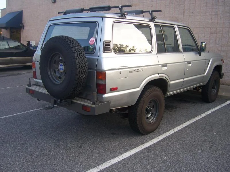

Here is a pic of my SROR bumper that fits your description. Enjoy
Thats a nice setup, hadnt seen a pic but did read mention of Solid Rock. Are you experiencing any play at spindle when Gerri's are full?
When the bumper has tire only and I swing it off the ledge it sits on it drops a hair. When it is loaded with fuel and jack it drops a little more. Perhaps 1/2 inch. Half to lift a little to get it to sit correctly. It has been that way from the start and has not gotten worse.

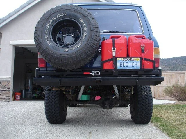

Here's mine!
Didnt realized that mine is VERY similar to SROR's. Mine is a home brew that I built myself.
No play at the spindles...Got them from A to Z fabrication. The parts I got from Mcmaster carr.

Two spindle have much less leverage than one long one. Its not play in the spindle, its flex in the bumper. If I did it over I would have gone for two over one.

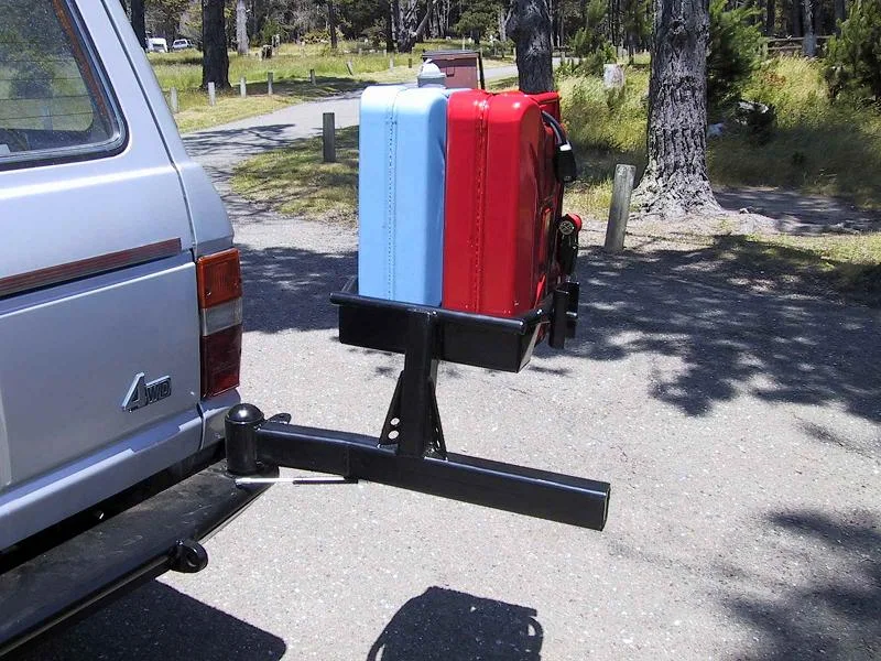

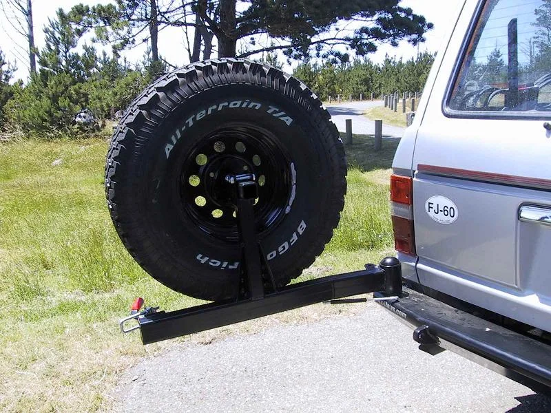

I have a rr kaymar like one below (this pic from TLC4x4 website), but w/o the tire/jerry can carrier...yet
jz :grinpimp:

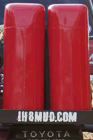

here is mine
4+ rear bumper custom ordered with tire on right hand side (Personal preferance)

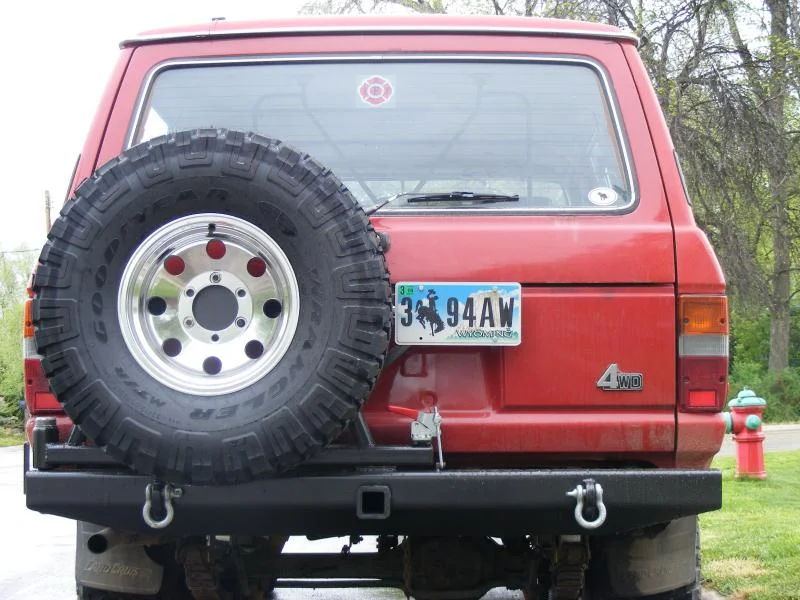

Rear Bumper
No gas can carrier. We built this one earlier this year.
Carrier
Another shot
Nice bumper Toyrod, looks clean. I'm looking inside your car at that barrier. Is it removable and what holding the top? Is it friction or mounted to the ceiling?
