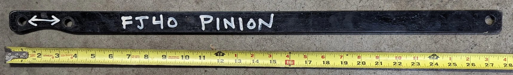

You dont need any special tools outside of a torque wrench and some flat steel bar with a holes drilled in it to hold the pinion flange.
My homebrew tool is below, its nothing special. Holes need to be appropriately sized and located and you'll need to clearance a bit to allow room for the pinion nut socket.
