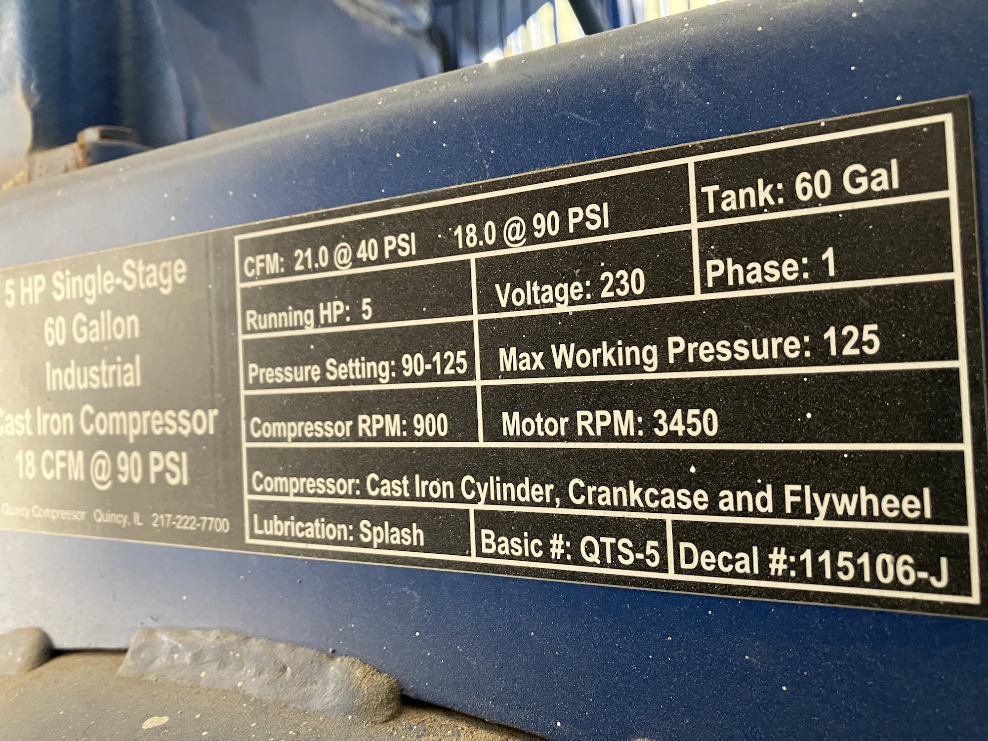

Not sure if you'd be interested in a mild project compressor, but I've got a 60-gallon 5hp Quincy single stage twin cylinder vertical compressor that I'm looking to get rid of. It needs a new motor (5hp SPL) and a pressure switch but the compressor turns over nicely. Originally from Simms, used for spraying.
