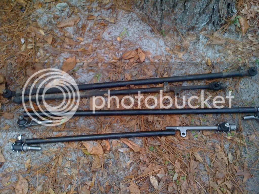

TREs. Looked hard, wasn't. Advance Discount Auto carries a "5-Piece Front End Set", which is what you want, not a "Pitman Arm Puller" or "Tie Rod End Lifter". Rent for 2-3 weeks = $100. When you return it, you get all your money back.
With that kit, the job is cake.

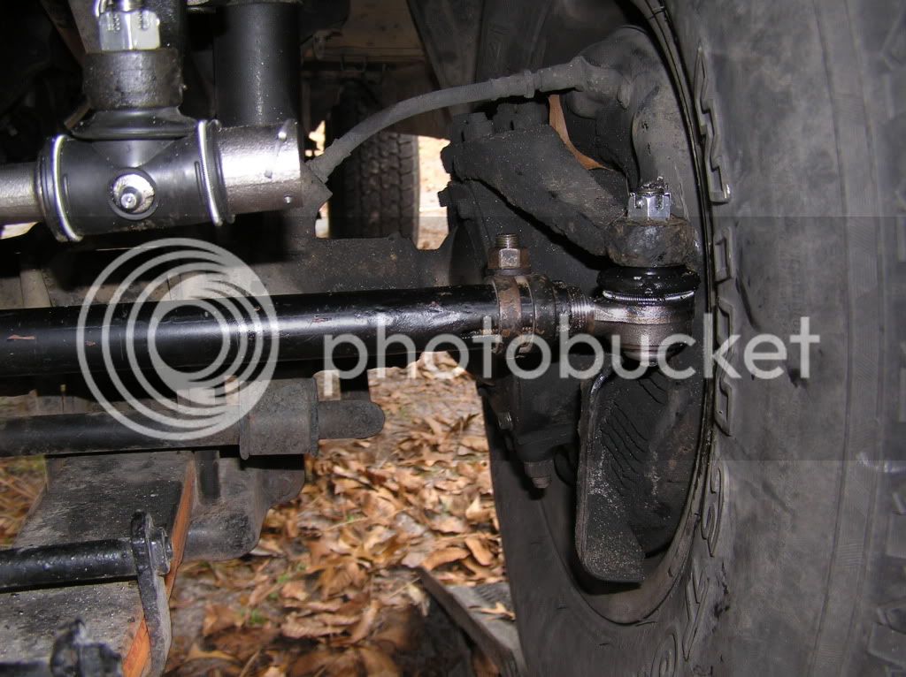

Thank you, Deo for the extra tie rods and advice. All I had to do was pull the old set off in one piece, assemble the tie rod ends (got mine from Kurt @ Cruiser Outfitters... you want 555 brand, Japanese; they make a few in Taiwan too, which you don't want), match 'em up, measure, reclamp, reinstall. Took me 3 hours and 15 minutes, baked. Shop quote was $300. They can suck my old tierod ends. I don't even need to adjust my toe. Tracks perfectly, nice and tight. Cha Ching.

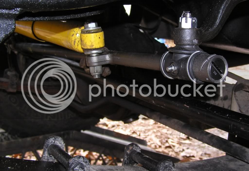

looking good.
i see you couldnt get the steering stabalizer stud all the way in. i had the same problem, and the stud broke on my first time off roading and i never put the ss back on.
looking good.
I don't run one either.
You might want to check you TREs for play. I put on a new set of Japan 555s and one side had some noticeable play. I had to remove the cotter and turn the screw in a full turn.
I couldn't feel it in the steering wheel, but when I had someone twist the wheel back and forth, while I put my hand on the TRE, I could feel the play.
Tightening it up improved steering.
x2 I always give new TRE's/Links one full twist of the screw it makes things real nice.

I think we'll be hearing a whole lot more than some loose nuts on this one Spike. After all, it's only the most important part of your rig as you're driving 65 down the roads....:hillbilly:
looking good.
The steering stabilizer did go back on better than that. That happens to be how I left it for the picture. Each nut/cotter pin combo was tightened as much as I could before putting the cotter pins in. They're as tight as they're gonna get.
No play whatsoever.

Trust me, I did it right. Having the extra set of tierods was the trick. I just had to assemble them with my new ends and take careful measurements cpmparing them to the old set. Pin to pin was exact, as were the number of threads showing on all four. My truck was up on big ramps, and the tires could not have wiggled more than 1 mm.
I don't think it was toed in much, but it tracks fine and there's no drift for a long, long time going down a flat (non-crowned) road. On a normally crowned road, it takes 10-15 seconds before a slight correction is needed. Even the steering wheel is perfectly straight.
I can't believe how easy a job this was, actually.

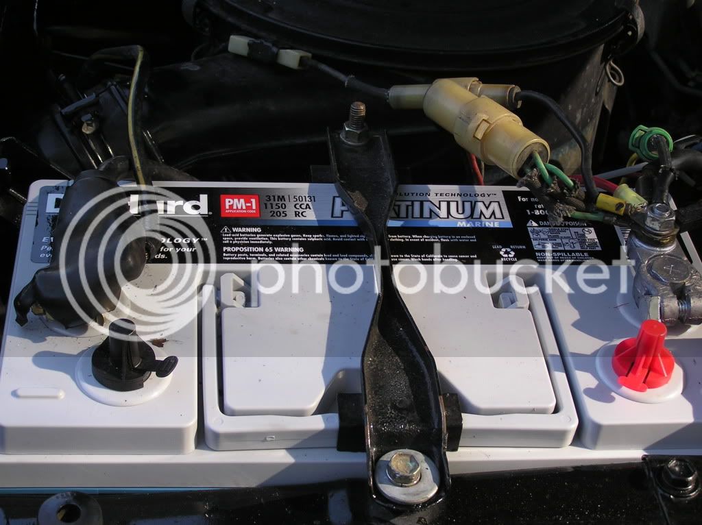

The easiest way to know it was truly in neutral was to try and start it. If it lurched, it was in gear. Believe it or not, with a 6-month old battery, after 6 or 8 attempts, this drained it enough so that I needed a jump. This battery was an el chapo from NAPA, and was always a bit undersized. So, I decided to end the nonsense and buy the Bad Mama Jama.
Behold, the Sears DieHard Platinum (Odyssey) Marine 31M.
At 9 1/2" High, 6 4/5" wide and 13" long, it uses every last millimeter in the space.
I could not believe how heavy it was, at 75 lbs., it is 15 pounds heavier than an Optima Blue Top.
$250. 3 years, full replacement.

Sweet battery!
money well spent right there
you could start a tank with that thing lol
