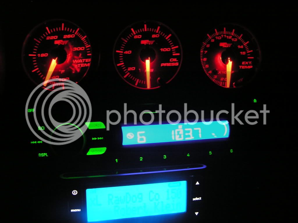

Busy day...and night. Those gauges can be illuminated in blue, aqua, white, green, red, amber, and purple. I prefer the blue.

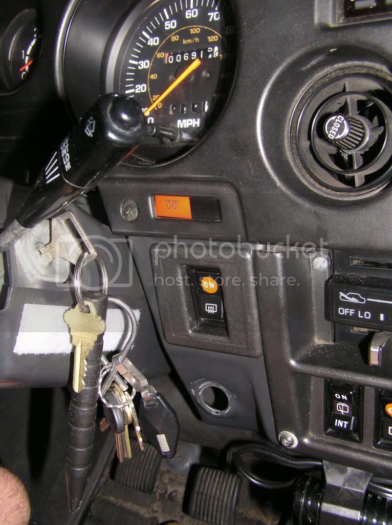

My glow is now a rear window defrost toggle where the 4LO button normally resides. Diggin' it.

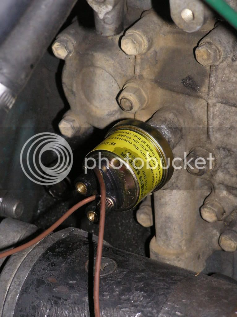

I didn't take a picture, but I am running two oil pressure sending units and gauges; the stock one and the aftermarket one, with the senders in a T configuration.
My numbers:
When the motor is cool, I can rev the engine and get my oil pressure up to 95 or 100 psi, and then when hot, it maxes out around 60 or 70, At idle, it never falls below 15 and is usually dead on 20. This totally confirms that my OEM gauge is a piece of s***. Shame on Mr. Toyoda for not giving us a decent gauge to begin with.
Water temperature is never higher than 185° or 190° F.
EGTs are pretty cool, when accelerating = 800° or 900°. Cruising at 2250 rpms in 5th (~55 mph) = 670° F.
My low oil pressure switch (behind, below and to the left of the oil pressure sending unit) is leaky and I can't get to it unless I remove my oil pressure sending units and my starter.
