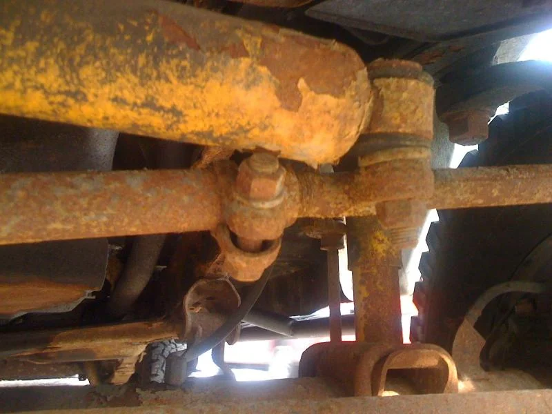

So I was driving home after a good friend helped get my sliders welded on trying to get home to dinner when:
I lost all resistance in my steering and i started to slowly veer to the left.
Thankfully i was hunting for parking and was going pretty slow

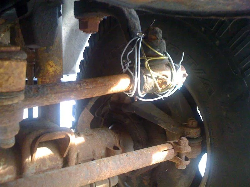

When I got under her i noticed that my pitman arm was no longer connected to the relay rod.
Thankfully had a couple of hangers and rigged up something to limp to a parking spot. (see below)
1. So where do I get the pitman arm and the part that attaches the pitman arm to the relay rod?
2.As you can see alot of my rubber is getting worn. What else should I replace while i'm at it.

holy rusty metal batman!
Looks like you might need to go through that entire front end.
There was a vendor in here that had killer deals on the tie rod ends, maybe someone can chime in and put in a link as i cannot remember.
yeah, so what you need is a tie rod end(TRE). the new ones will have the ball joints in them.
there are a handfull of them under there, you [strike]want[/strike], need to replace them all. and judging by the look of things there, it will a job and a half. those things need to unthread from the rods.....you lost one already, the others are likely not far behind.....you will feel how bad they were once the job is complete and the steering is way tighter.
Looks like it's all been deep fried.
I got the TRE/Drag link kit from Kurt at Cruiser Outfitters for about 100$. 555 brand Japanese
Start soaking in PB Blaster now.
Get a TRE puller or Pickle Fork from Harbor Freight or similar.
I had to use heat to get the TREs off.
Heat, Bang, repeat.
Also heat helped un-seize the threads into the tie rod.
Good Luck

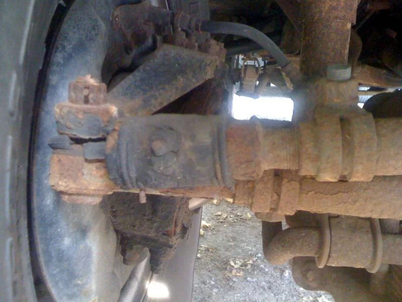

What actually broke is not a tie rod end but the relay rod end. Tie rods connect the two wheels together. The relay rod is what is connected to the pitman arm. There is a major difference in the two. Especially to a parts guy who doesn't know Land cruisers.
Get a factory service manual at the same time you get new ends for the relay rod and go ahead and replace the tie rod ends while you are at it. You need some serious maintenance on that front end. I would be more concerned about it than the rock sliders you just put on.
