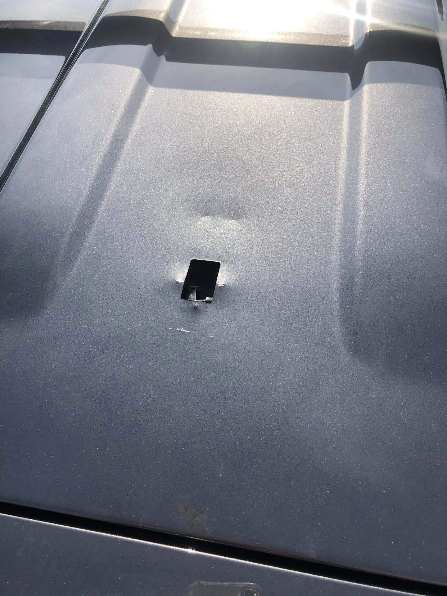

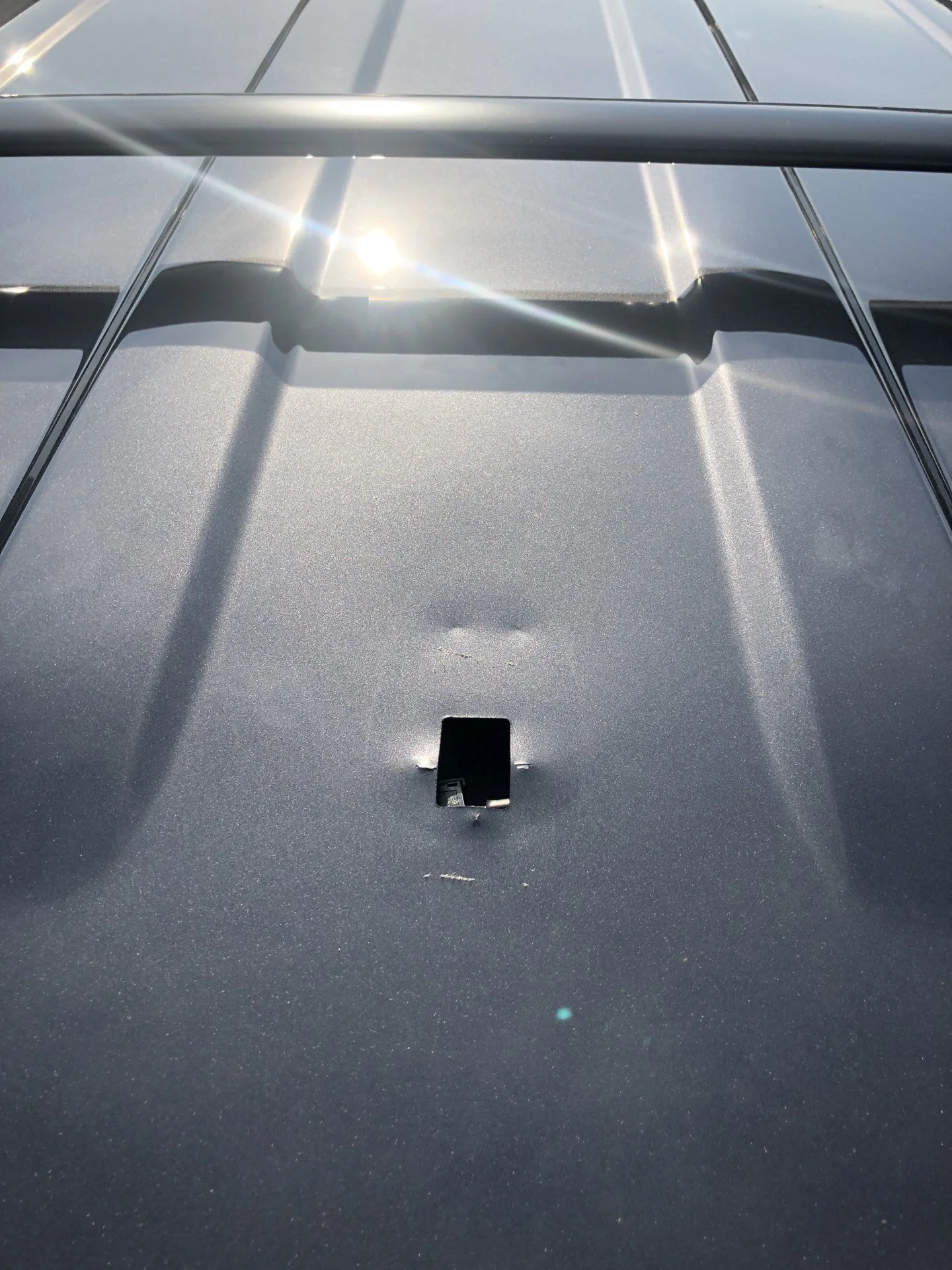

I would like to see a photo of the hole from above. I think it would be a perfect place to put a ham radio antenna with an NMO mount.
Mine could disappear and it wouldn't bother me. It's only for XM/Sirius stuff, which I'll never subscribe.
Will need to take pictures for insurance claim. Wife going in morning to Toyota dealership where we left it to do so. They haven’t started work yet - wanted to hear from you all first. Regardless of what we do I will make sure to post a pic. From memory it’s a 1cm x 2cm rectangle - I will ask her to measure. If I were to electively remove, based on what I see, would use heavy fishing line to disrupt adhesive all the way around until I was to and around the rectangle which is about 2/3 back on the fin. It is clipped into the wiring harness. Not sure if it’s clipped into the hole.

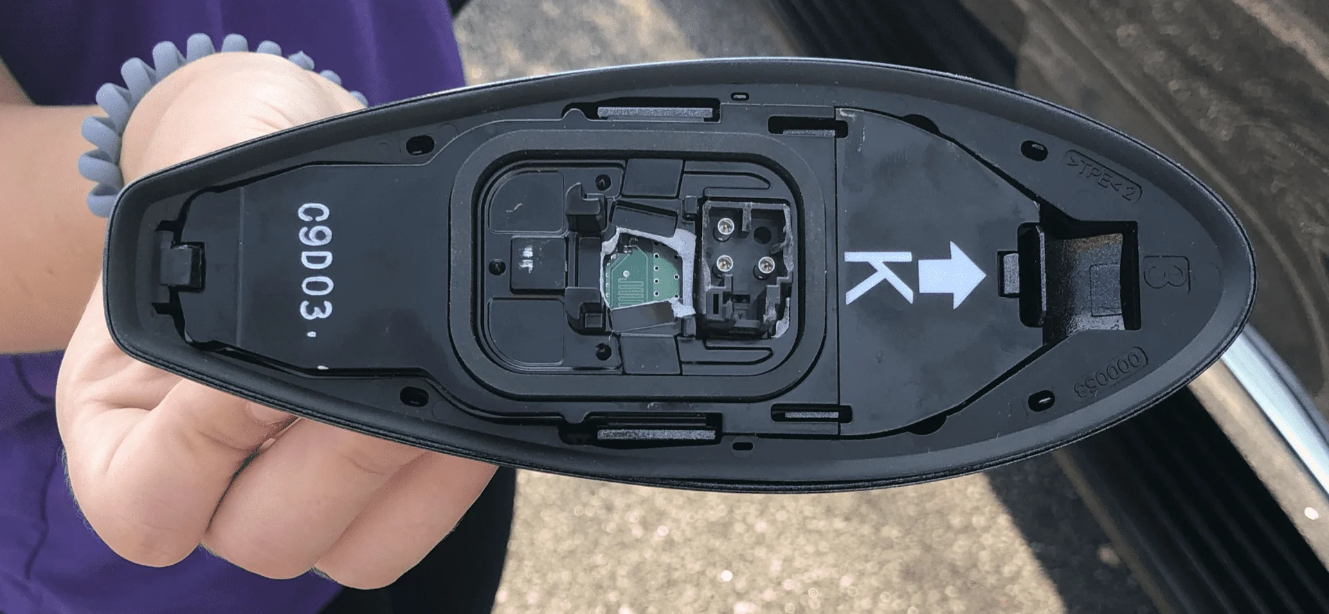

Correct - estimate involves seven hours of labor to pull and reattach headliner to replace harness. I talked to them further today. They have done this before on other vehicles and state even to reattach the fin but not rewire they still have to pull headliner- attachment point for fin that broke has to come from the underside. We are going to go ahead and let insurance handle it since it’s new, but if it had more years on it or was paying it all out of pocket then may have gone a different direction. Work is warrantied for lifetime. All Clips bent and broken will be replaced so it won’t be a rattling mess. Thank you all for your input- while there was consensus that the antenna is useless, there really wasn’t an inexpensive realistic alternative.
For those of you interested in attachment points here are the photos from today. Again, hole is about 2cm by 1cm. Don’t get too excited - that’s not my wife’s hand.

My wife just did this to our new to us 2013 LC 200 and bent the roof. I used a bunch of silicone to patch it for now I till it’s summer and I can work outside. Did you come up with a plug or cap? I know they have one for the. 2nd gen Tacoma’s. Tempted to relocate the entire thing as I don’t need the gps and the satellite radio does not work in alaska.
