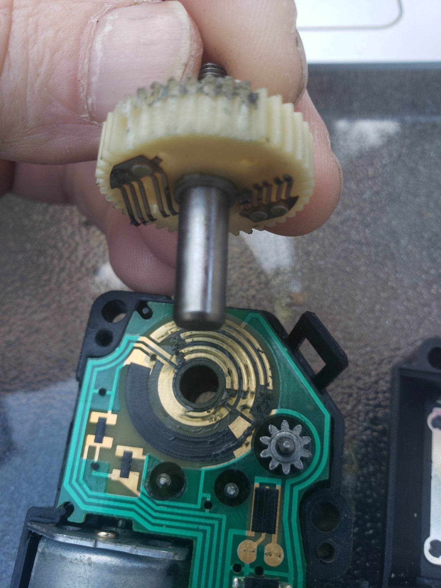

first post to mud. Been lurking for a few months but now I’m at a spot where I need some help. Just did a cooling system overhaul. Changed all hoses, changed my heater control valve, drive belts, fan clutch, PHH, full coolant flush including heater coils. Still I do not have hot air coming from the vents. In searching threads I’ve come across that the air mix damper servo may be bad, or possibly the cable to it. Pulled the dash. Cables not seized or broken and in pulling apart the servo I didn’t notice anything that could make me believe it’s bad either. Can I apply 12 v to the motor that’s in the servo to see if it spins? Or will that burn it up? Also any other suggestions on where to look while I have my dash apart?

I did. I did the same thing. Once I pulled the whole dash apart to get to it I decided to replace it and see what would happen. Ended up fixing the problem.
if you get a chance, it would be really helpful to see the actuator position on top of the servo motor when turned to coldest
It isn't going back together, (I found you could open up the motor and rotate the plastic gear and the damaged ones are out of the way)
Seems like the white plastic levers won't attach. Maybe I',m missing a hook lever or something...
