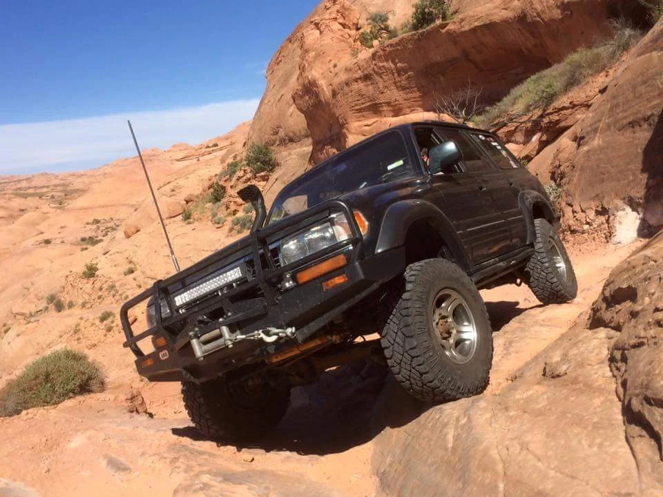

I have an ARB and love it. Classic look, sturdy (enough) and can do a little bit of everything, even if it does no one thing well.
That said, I have the badlands winch in mine and wouldn’t let that “modification” sway you. I spent $20 on Smittybuilt spacers on Amazon that did the trick. Took 5 minutes to order and 15 seconds to put the spacers in there while bolting on the winch.
I can snag measurements if you need me to on the eyelets for light bar. Just let me know

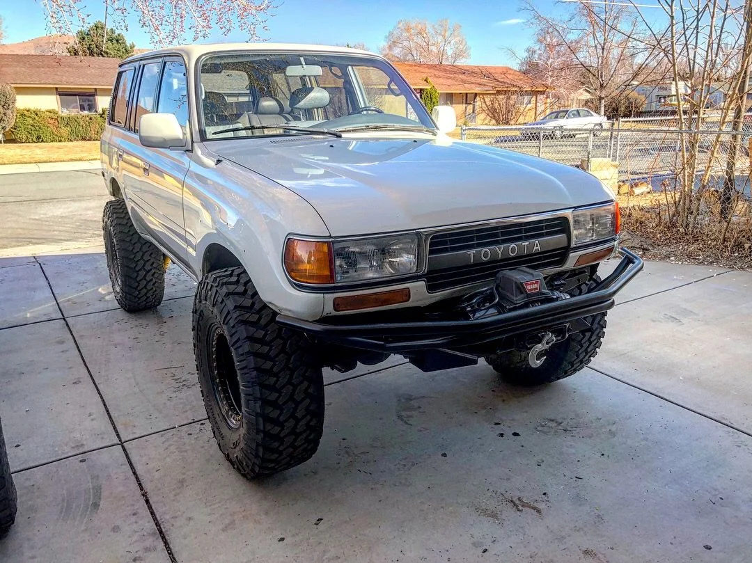

I cant, I traded my ARB for 4X4Labs

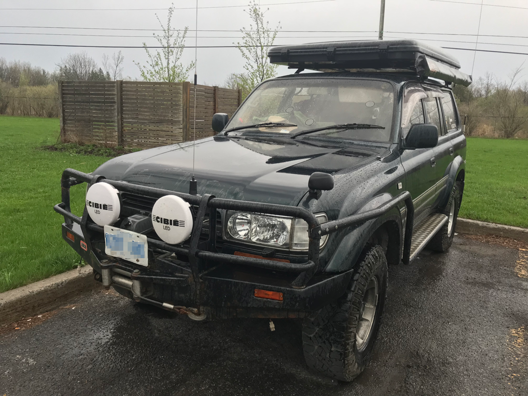

I really like the aussie-style bulbars. I have an ARB since maybe 2013 or so, along with the brushguards, and it has worked extremely well for the kind of tight tracks I am often on. I also want something that isn't going to bend my frame in a crash, hopefully by sacrificing itself, which I choose to believe the ARB will do.
I should add that the side bars were a really good idea: fewer scratches on the side of the truck, now.

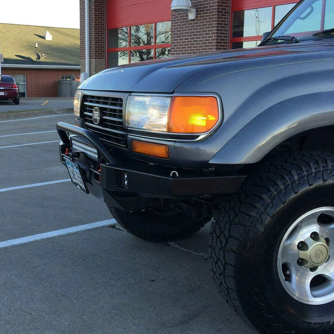

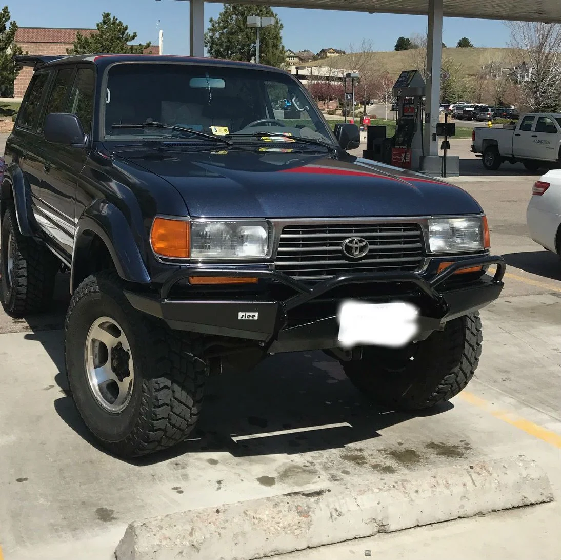

If you are going for looks get the Slee. If you want protection from limbs and animal strikes get the ARB.
BTW, the Slee is stout, and well made, but little help against a deer.

I personally like the looks of the Slee Short bus the best but it won't hold an M12000 winch.

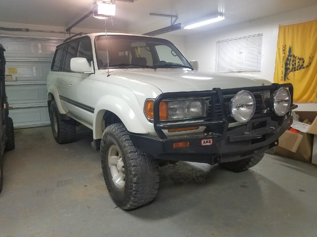

I got an ARB two months ago and I'm really happy with it. It seems to strike the right balance for a daily driven 80: stout enough to protect the truck from most things including animal strikes, but sacrificial in an accident.
I found a screaming deal on a new Warn 16.5ti, so I bolted it into the ARB without any modification (I did use a 1" cylindrical spacer and a longer bolt to mount the control box).

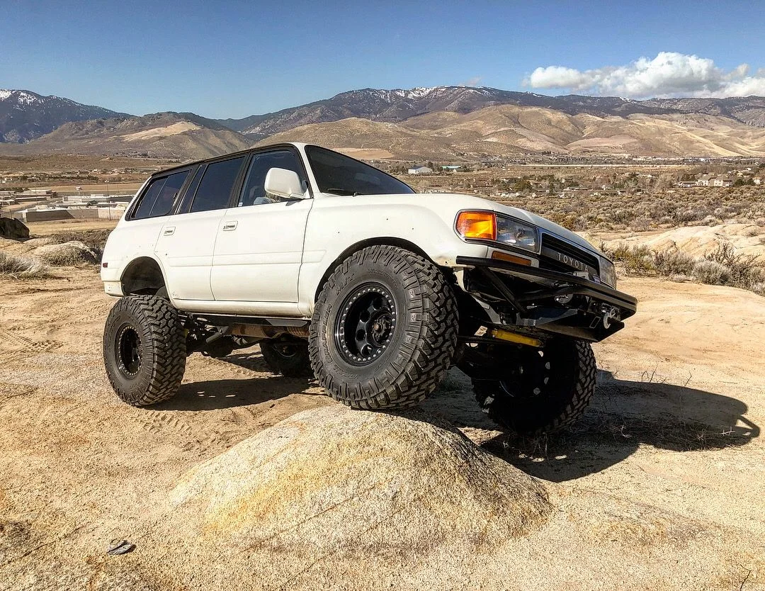

I went with the Costa fab front bumper and I wouldn't trade it. It's clean, built like a tank and the best looking bumper out there in my opinion. That being said if I did it over again, I would go with the Slee Shortbus. Not because I think it's any better because I don't. I just think it's a better price, it's crazy strong, comes powder coated and ready to mount and you will get it quite a bit sooner than I did the Costa which took 7 months. Then I had to have it painted or powder coated - I went powder coating which added a little more time upon delivery.
img_20171125_174642_041-jpg.1585257
Slee takes a winch and lights, but has a small winch compartment, so it significantly limits the options you have for a winch. Most of the slee approved models are very expensive.
