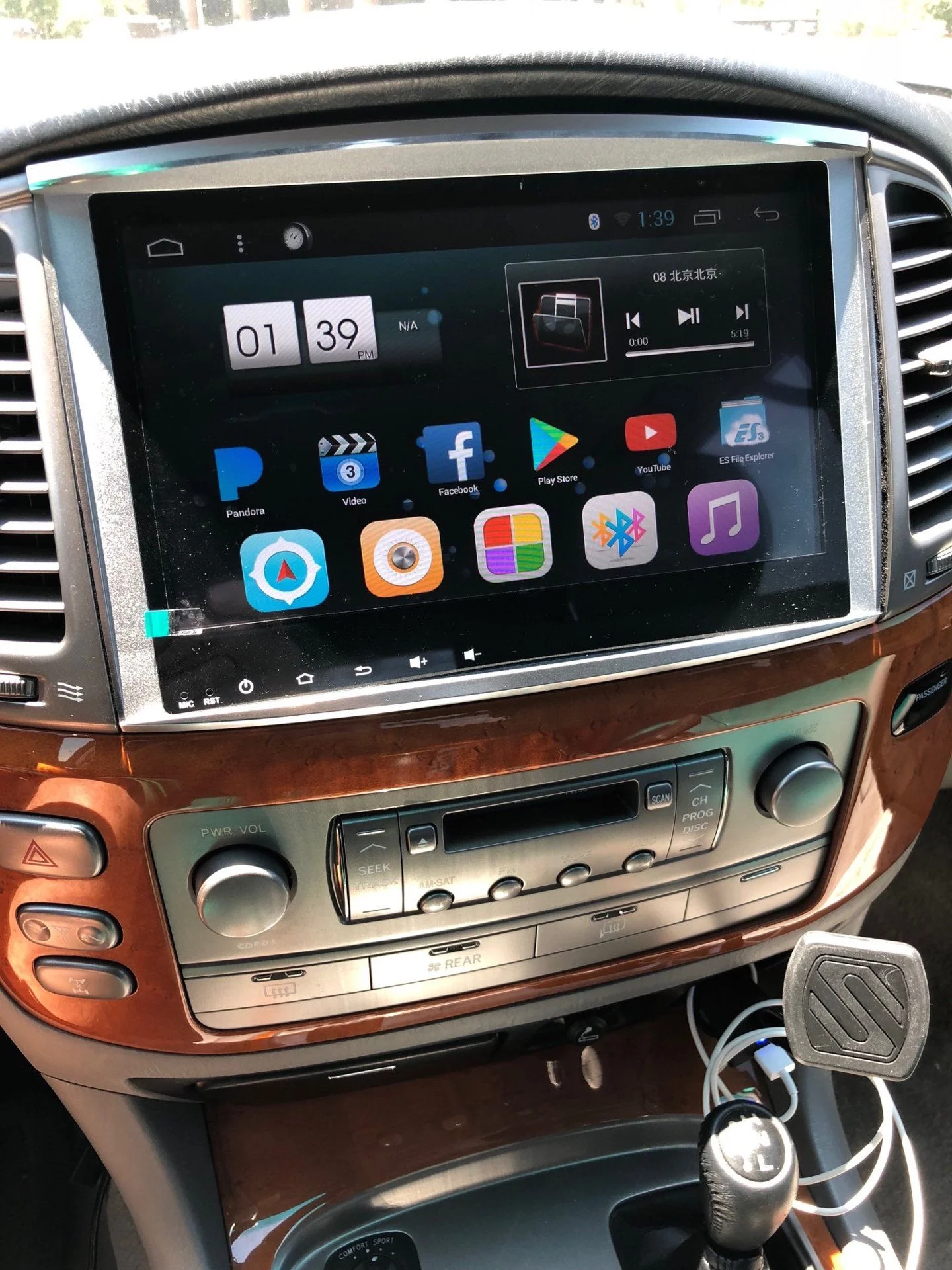

Has anyone installed one of the Seicane 10-1/2" stereo systems in their LC or LX? I have an 05 LX470 and just installed the unit with the module for the LX or LC. However, the back-up camera does not show up on the screen.

In my experience this happens when the camera isn’t ground properly and not turning on.
Are you sure the camera is getting power? Did you wire power off the reverse light?
The back up camera is the existing one from the factory. I assumed the specific module that came with the stereo included the back up camera feed.
i was hoping to patch into the existing camera if possible. The screen goes black when I go into reverse so the system obviously knows it should be displaying the rear video feed.
IIRC the OEM B/U cam operates on 6VDC (vs 12VDC which is conventional for aftermarket cameras) so it's possible the OEM camera video out format isn't compatible with the Android video circuit
Hi WaterCruiser, thanks for the diagnosis...that makes sense. Now I just need to find a camera that can be installed like my current OEM but is Android compatible. Any suggestions?
sure thing there are a variety color-capable cam's on amazon etc you don't need anything fancy - they're available for under $25
that link above is a transistor, I don't know about the plug though- fitting into, or somewhere around the television ECU. Without my notes I'm guessing it's the T21 plug into the television cam you need to get at, should be four wires you need, a transistor, and a old cut off single RCA plug. Stock cam is 6vdc.

Re: backup camera. An RCA plug is just a convenient way to have a positive and negative signal. To try and make it work with your OEM camera, you can buy a RCA cord and cut off one end, exposing the two wires. The cable will need to be long enough to connect the output end of the OEM backup camera to your headunit. You can then tap into the existing backup camera wiring (where ever it is close to terminating) and connect to the two exposed ends of your RCA cable to the signal wires. There may be more than two wires on the OEM wiring since the camera may get it's power from the same cord.
Keep in mind you don't have to cut off the plug of the OEM backup camera output. You can just tap into the wires a few inches away from the plug, and leave the plug open-ended and dangling.
This *may* work and may be worth a shot if you don't want to run another backup cam and route all of the wiring.
