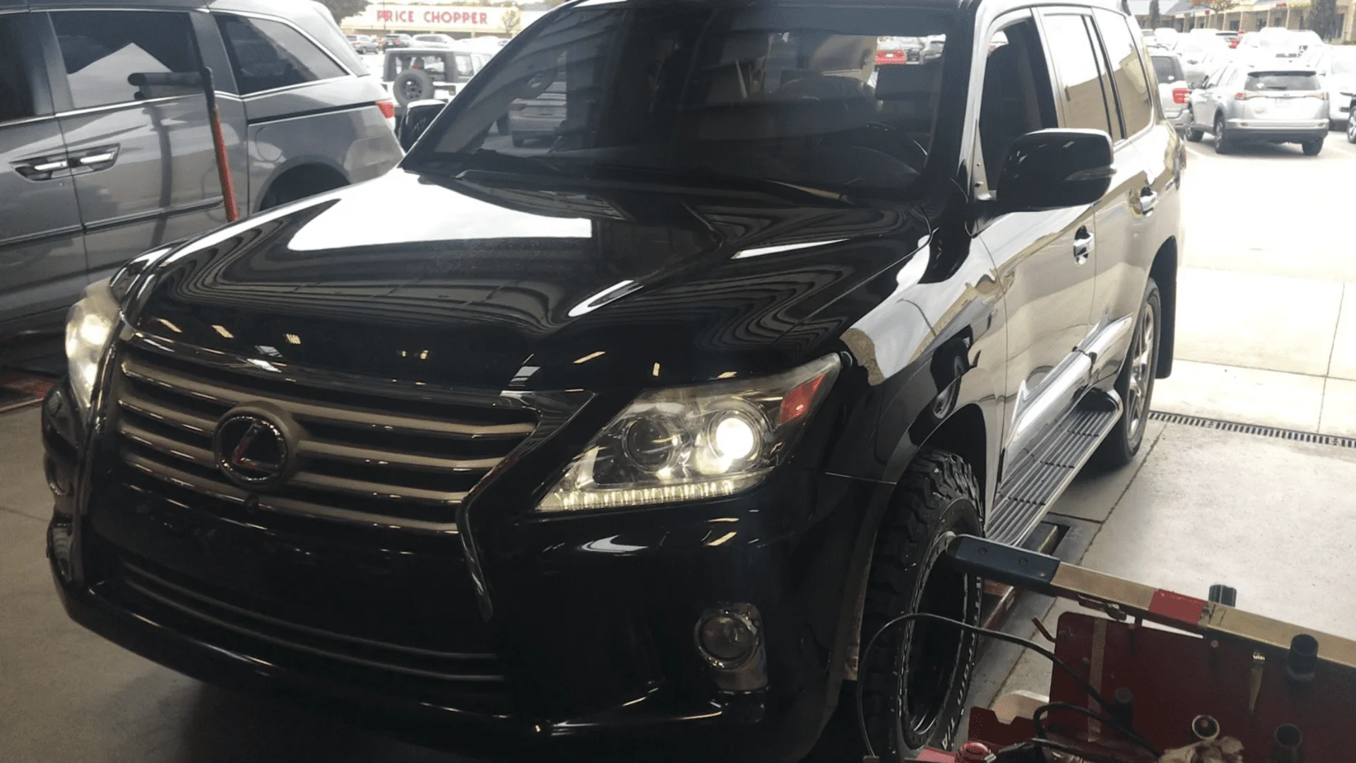

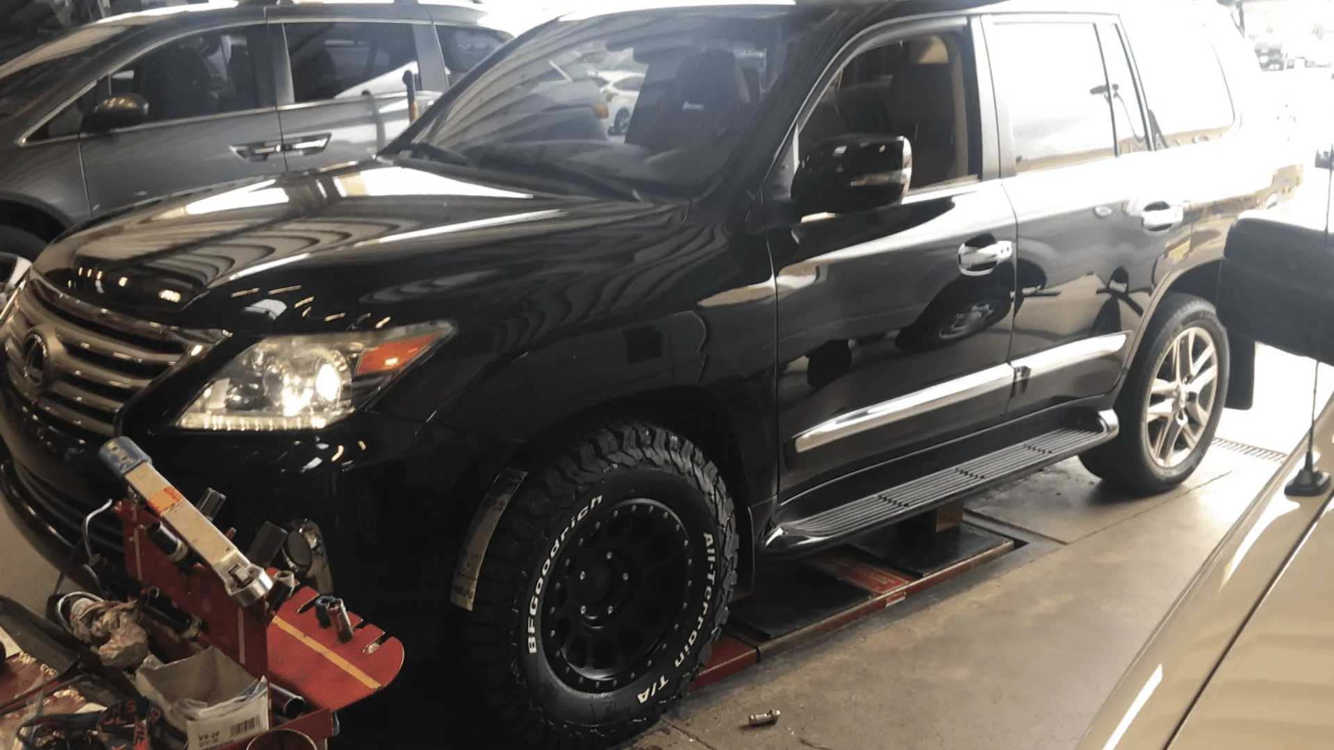

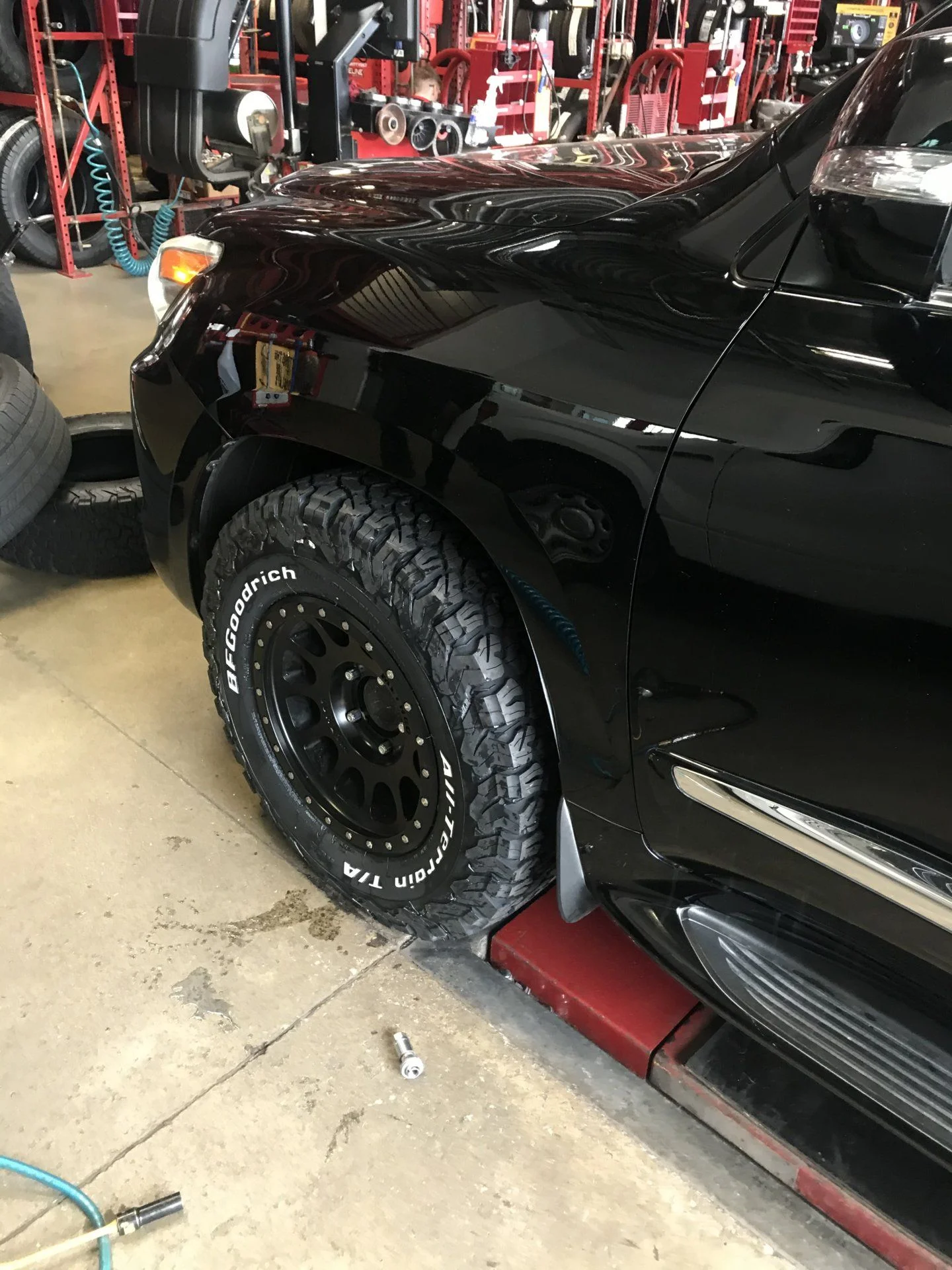

Had these wheels since last year, but had them mounted on 265/65/17 KO2’s and hated how small they looked (inch smaller than stock diameter).
I purchased a new to me 2013 LX, and was able to trade the KO2’s towards a set of Michelin Defenders for my 20” factory wheels.
I like to be able to change wheel setups, so now I am putting on 275/70/17 KO2’s on the Method wheels.
My friend has this exact setup on his 2011 LX and said once he removed the mud flaps, he has no rubbing.

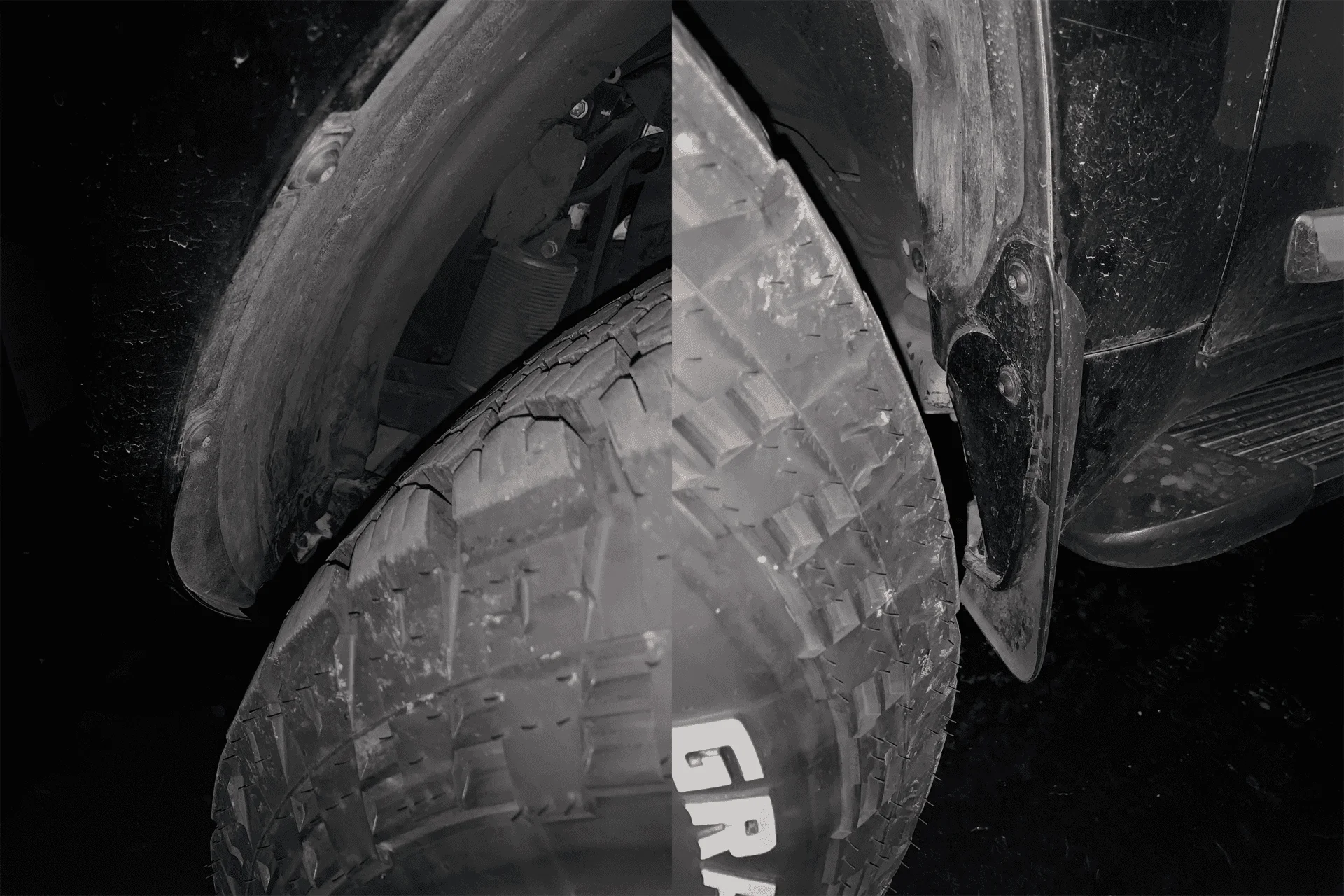

I am rubbing on the mud flap (and it looks like fender liner closest to the frame of the car, as opposed to the front bumper) so I am not sure if simply the mudflaps being removed would remedy the rub.
I would like to think the 2013 and 2011 are the same (outside of front bumper) so I should be fine once I remove the mudflaps.
As an aside, I know I’m rubbing due to the aggressive offset of the wheel, but I enjoy the look and I already own it. Rock warriors etc don’t do it for me, so ideally answers in this thread are given under the assumption that we will not change the wheel.
Now my concerns:
1) Will fender lining trimming (if needed)cause issues in a state that has snow/road salt spread semi-often during the winter? If so, would a heat gun likely give enough space while also preventing salt from entering and touching the body or frame where it's vulnerable?
2) Does the heavier tire and larger size (32.2”) stress the drivetrain or motor on a vehicle with 155,000 miles to the point where you’d be concerned? Or is this a negligible difference?
I know these are not particularly nuanced questions, but I have searched and haven't found the answers. Thanks for your diplomacy in addressing my concerns.
I had them mounted for a test fit, but plan to pull the trigger on tires during Black Friday sales.
wheel and tire specs:
17 x 8.5 5x150 0 offset
49770 part number is MR30578558500

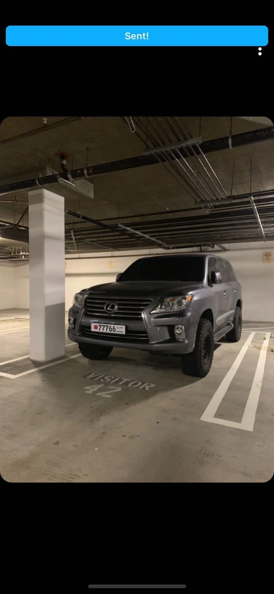

Black rig is mine, White is my friends. He lives in another state so I can’t go get hands on it anytime soon.

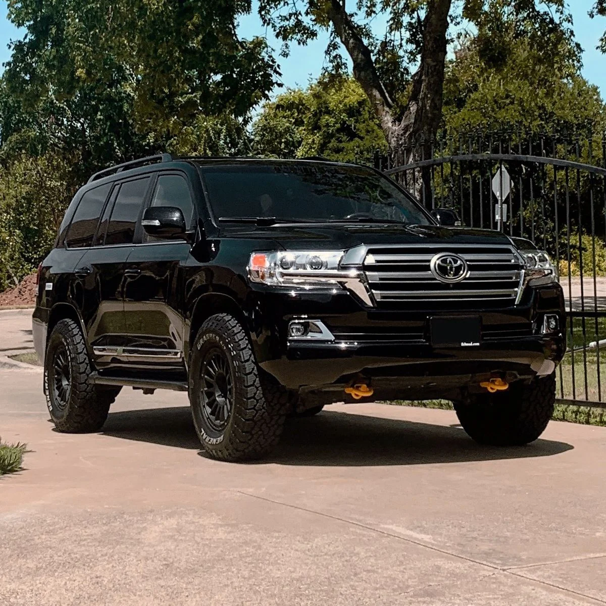

I’m running 33” with 0mm offset. I’ve removed my mud flaps, and have cut a fair amount of fender liner out from the front of the wheel wells. The front fascia is a little less stable, but I can live with it. I don’t have any issues with mud and such being flung into the engine compartment. I do get a fair bit of rooster tail down the side of the vehicle, but the BudBuilt sliders eat most of the nasty stuff. On road the offset feels fine, off-road I feel very stable and the extra track width helps. I can’t say I have noticed any real impact to parking lot maneuverability.
You may or may not notice the additional weight of a heavier AT, but that depends on your driving style. I have noticed a more aggressive wear on the outer shoulders of the tires. You have to consider positive scrub radius with the active drive axle in the front.
While I don’t hate my setup, I do have a set of the Method 701 with +25mm offset on the way. Let me know if I can explain anything better.

I'm running 17x8.5 +0 Method's on 285/70R17 without a suspension lift or adjustable UCA's.
I heat gunned the fender liner around where it made contact, then re-drilled the front of the liner forward closer to the bumper ("4Runner Fender Liner Mod"). This handled the rub at the front of the wheel well.
I kept my mudflaps, but trimmed a lot of it away, mainly the entire center section, but keeping the "visible" section that deflects the spray up on the sides of the vehicle, as well as on the underside near the running boards. There's a line that you can follow to trim the mudflaps down if you just want to keep the part of the mudflap you see when looking down the side of the vehicle from the rear. This however would unfortunately make you lose the section of the mudflap that deflects spray towards the center of the truck, so I'm not sure if this introduces the salt issues you were worried about. But at least you can have protection for the sides of the vehicle and the edges of the bottom.
I was rubbing on the corner of the rocker panel underneath the mudflap actually, so I trimmed the plastic of that at a 45 degree angle or so, and then took a sawzall to the bracket that was holding that rocker panel corner in place. I also did the OEM front coil spacer lift, I'm not sure if that helped with the rub specifically or not. I go a little bit more in-depth of what I did on my build thread.
Hope this helps.

1) My fitment is different than yours. But I went through the effort to re-contour both the front of the wheel well and mudflap explicitly because of your concern. If you remove the mudflap, you will readily see where there are exposed pockets in the chassis and frame where they can and will catch and hold spray, and unfortunately along with it, corrosive salts. It's something significant enough that IMHO, would say deserves consideration.
2) Not at that size, you're not going to test the durability of the cruiser. It's smaller than the OEM approved RW fitment with a 285/70/17 (32.7") tire.
Not a question you asked, but a more significant consideration that I'd suggest you consider is maintaining good suspension geometry with proper offset wheels. 0 offset wheels don't just impact clearance, but have a significant negative impact on handling. Lookup scrub radius. I'd go so far to say that I wouldn't touch anything less than ~30mm offset.
@timjax shows a great example. Would point out that the LX has different side steps and mudflap that requires slightly different alterations. Try here

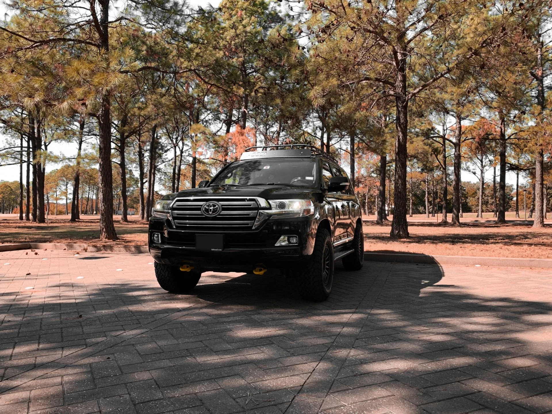

Here’s a photo of a friend of a friends truck with 0 offset and 275/70/17 tires. I think he just had to remove mudflaps. In this photo, he has the truck in Hi mode. Thoughts on getting this to work without cutting away my fender liner? Seems possible right?!
