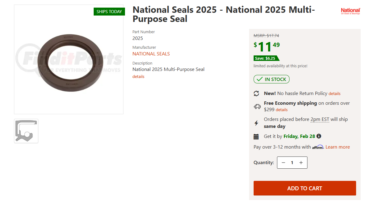

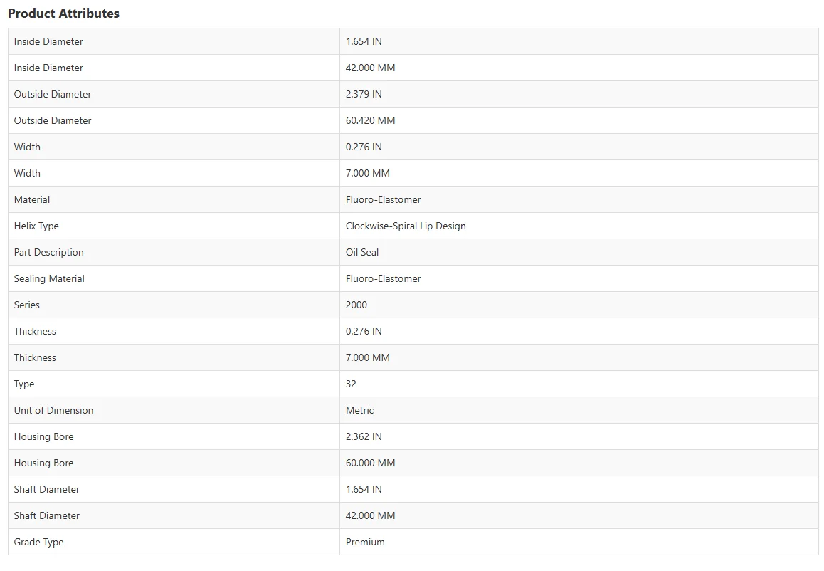

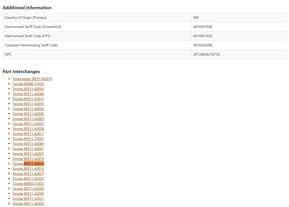

I use seal interchange lists. Here's a sample:
Toyota doesn't make seals, or bearings, for that matter. There's no reason not to buy either from manufacturer's distributors; the OEM factories do it all day long.
The NGK number you listed doesn't appear to be a seal.

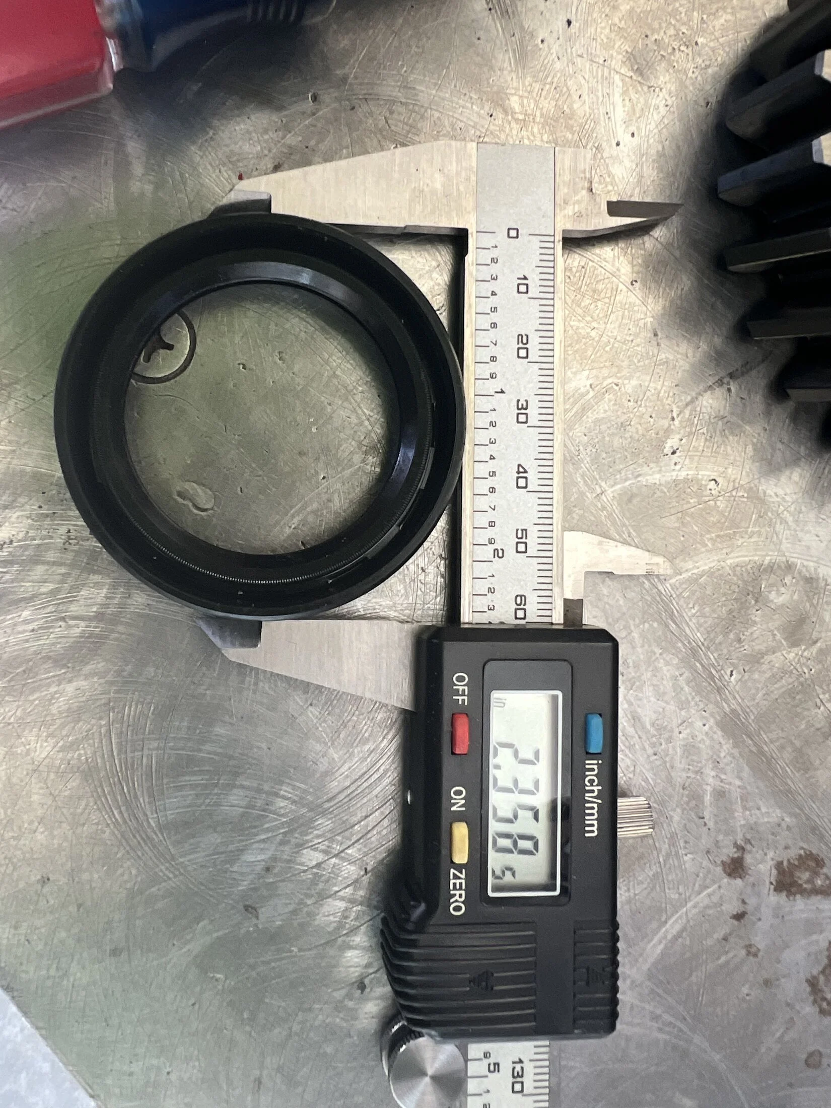

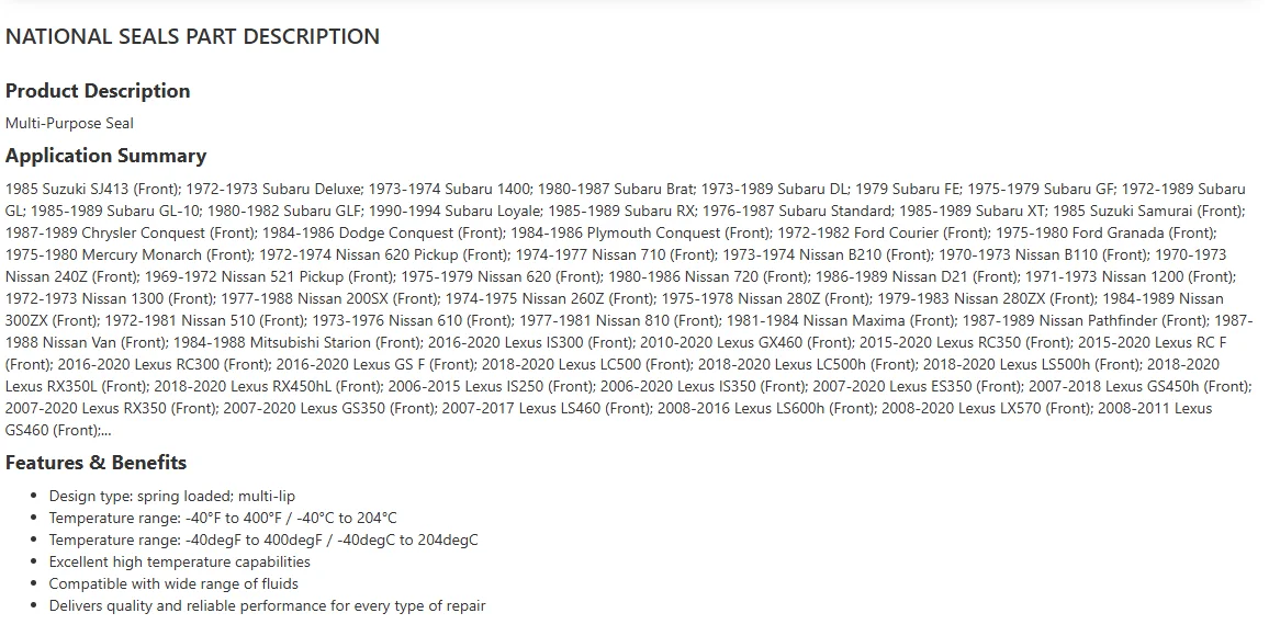

This probably will not be the exact seal, you'll have to physically compare them to be sure it'll work for you, but it's the case seal is generic oil seal, not a wheel seal, so I'd think it'd work:
Generally, the difference between generic seals, and bearings too, is the quality control the manufacturer provides. The thing that makes them generic is that they are all made to the same original design specifications.
