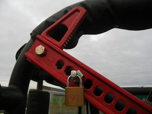

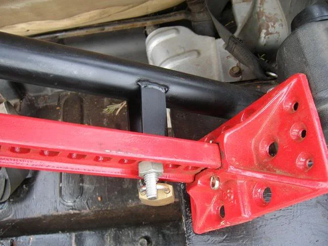

Found these pics on an Aussie's post from '07. I was wondering where I can find some bolts like this...
Make one... a few minutes with a grinder and a drill.
Mark...
Grinder (or file) to make a flat-spot. Drill to make the hole. A vise to hold the bolt securely is nice but not essential. Doesn't take long.
Use a bolt the same size and thread as your lugs and use a lug nut, then you'll have a spare.
I like this, just don't lose the "key"

While it looks good all it takes is a wrench to make that a lock shear.
If the bolt is grade 8 and the nut too it will most likely just shear the crappy lock right off if you were to back the nut off.
If the bolt/nut are cheesy soft stuff then it will be a big ol mess that needs to be redone if an attempt is made to steal it anyways.

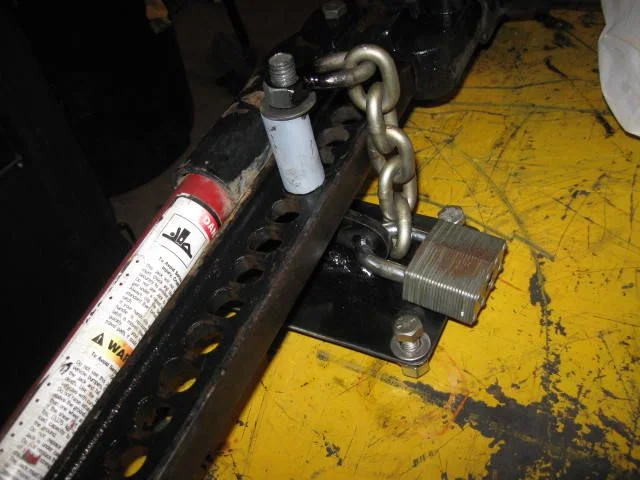

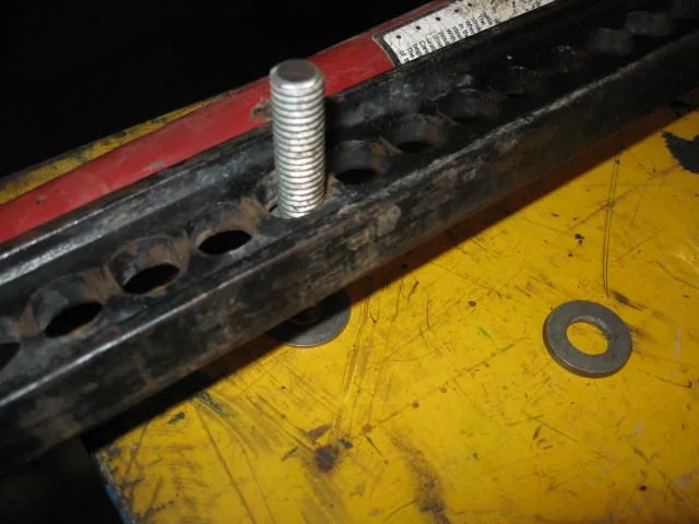

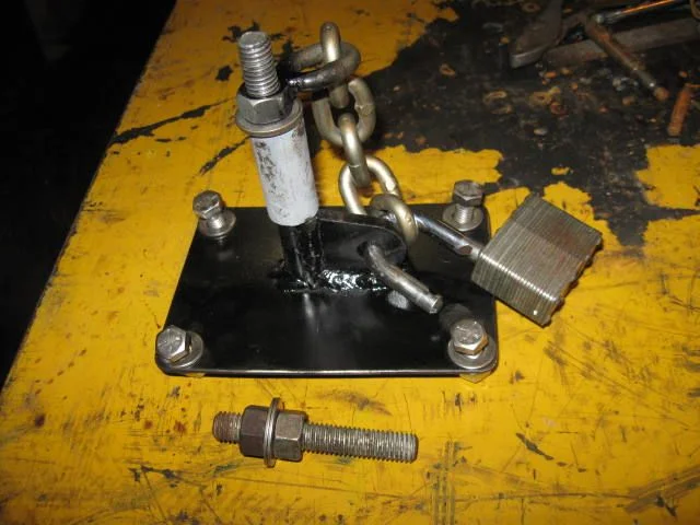

I chose to build my locking kit a little differently. No wrench, no parts to get buggered up in an attempt of theft. All half inch grade 8 bolts and chain to secure the jack
Here is my design. It works well and I have never had any complaints from anybody.
Lucky for us most thieves like soft targets and if a lock is present they move on to another target.
Now a determined thief is gonna steal your junk regardless. Most locks just keep lazy / unskilled thiefs at bay.
Yep pretty much.
Just look at the tiny brass lock compared to the stacked/laminated plate lock and notice what lock will come off with a hammer.
Just my .02 but my $60 hilift is worth more to me than a $1.99 truevalue type brass lock.
