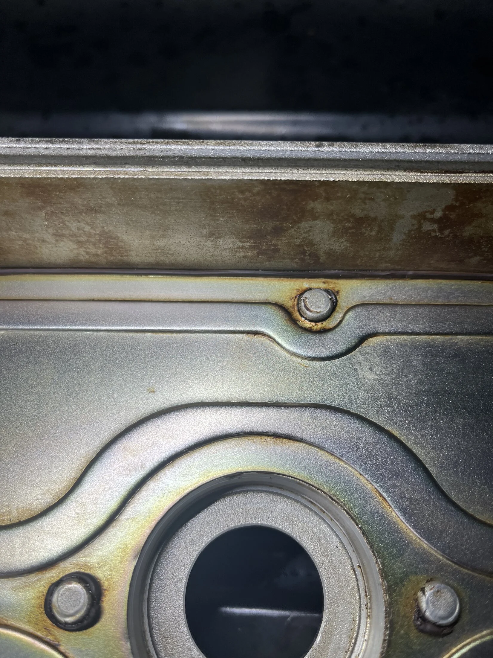

Hey all,
Im replacing the valve cover gasket and spark plugs tubes, and noticed that there is some kind of sealant around the edge if the baffle, as well as around the rivets that hold the baffle in place (and I think they're also used to hold the threaded holes that secure the spark plug wires). Does anyone know if this is how it comes from the factory, and if I need to re-seal this? I'm leaning towards removing it and not re-sealing as im nervous about any FIPG falling into the engine down the line (surprised it hasn't already). See pics below.
94 1FZFE
Yes, that is factory. I just installed a brand new Toyota valve cover that also had that sealant in those locations. I agree- don't disturb it. If its loose, maybe knock it off but it won't hurt anything.
I think it's anti-rattle goop.
Leave it. There’s more of it underneath and behind. This is a caveman response- here goes.
Ugh, Cronk says “More, Bad!”
